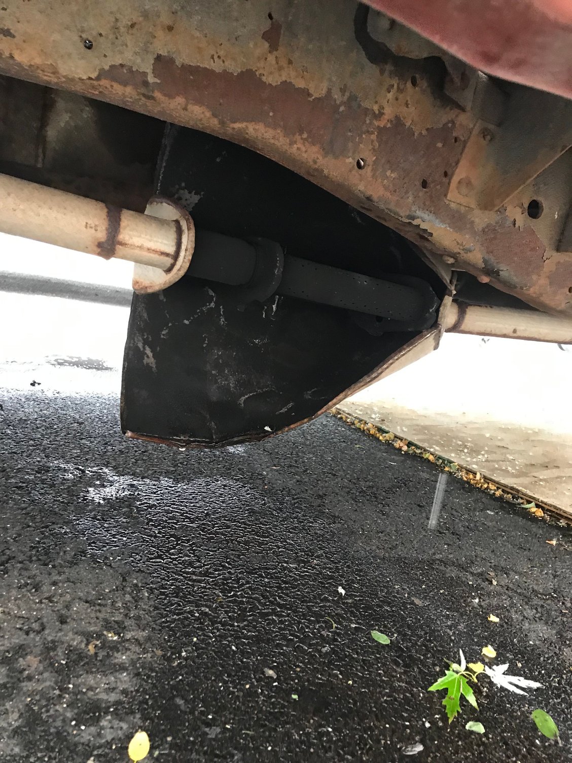

[My issue] After sitting overnight, my truck only starts after I let go of the key after cranking. (Run position)
About 3 months ago I had bought a brand new Holley 4160 600 cfm carb for my truck.
The truck ran great for a while and then started to have a REALLY hard time starting after sitting overnight.
One morning I went to start my truck and it would just keep cranking and cranking, but as soon as i let go of the key,
I heard the loudest backfire in my entire life... After losing my hearing for a about 5 mins, I tried starting the truck again and it fired right up but it was SUPER loud.
My muffler had blown up (See pic below)
I assumed that my carb was dripping gas after the engine was shut off, so after that I went through the carb and found a piece of rubber hose stuck in the needle and seat.
After cleaning that out, I replaced the fuel line from the fuel pump to the engine and put 2 inline filters right before the carb.
I'm 99 percent sure that the carburetor has stopped dumping gas into the engine but now only starts when I let go of the key and it still backfires pretty bad about 90 percent of the time when starting in the morning. When it backfires, 70 percent of the time its through the intake and 30 percent of the time its through the exhaust.
[NOTE] This weird starting issue only happens after the truck sits overnight. Starting the truck during the day after sitting for 8 hours is no issue.
I have replaced the ignition switch and that made NO difference.
I have 5 volts at the ignition coil (When not cranking the engine)
(I don't know if this is related but, at the same time that all of this started, my headlights only stay on for a few mins and then they shut off and to get them back on, I have to turn them off and then back on a few times. When I turn my brights on, they stay on for like 10 sec and then they shut off. Marker lights, brake lights, and turn signals were not affected.
