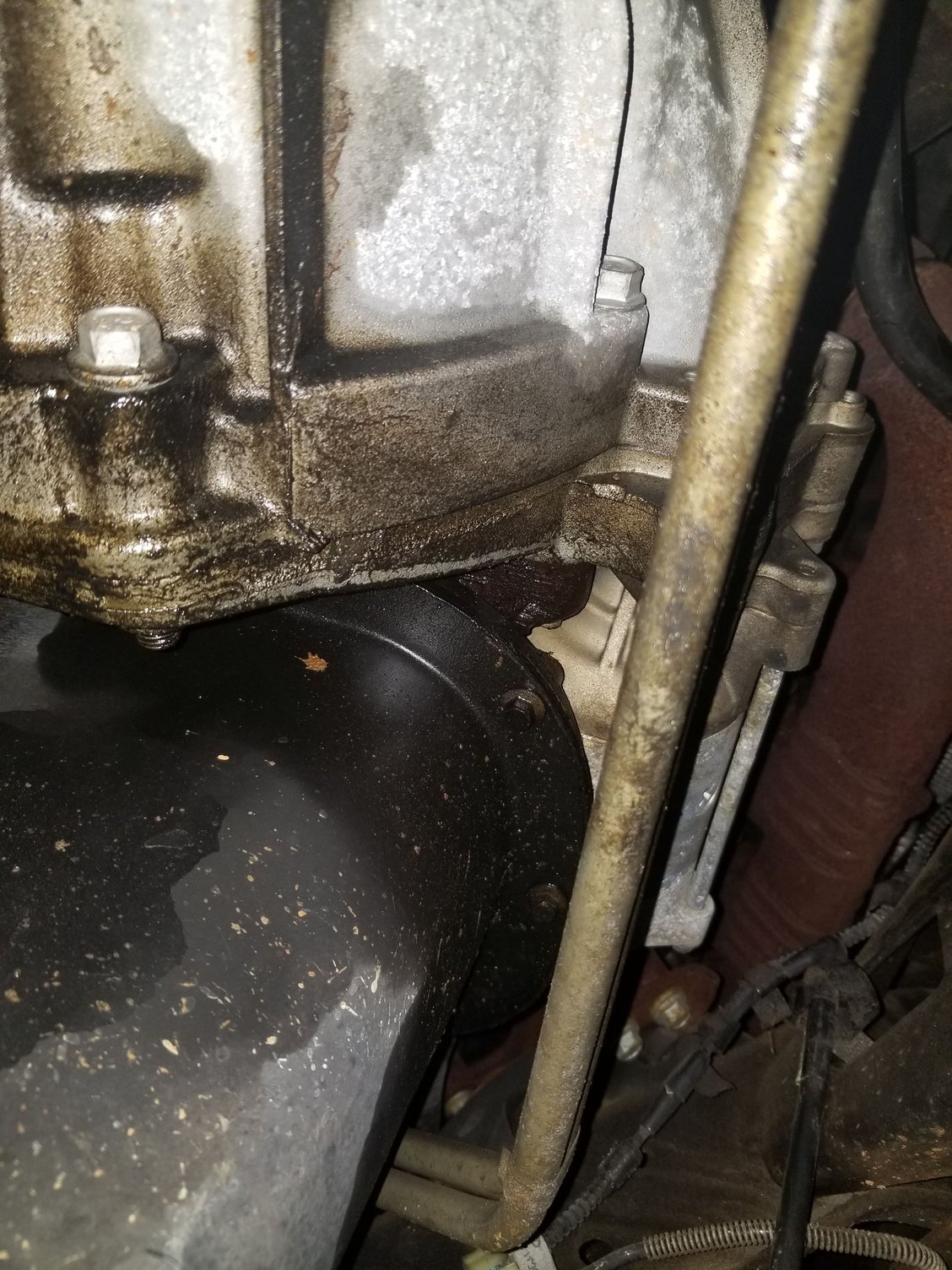

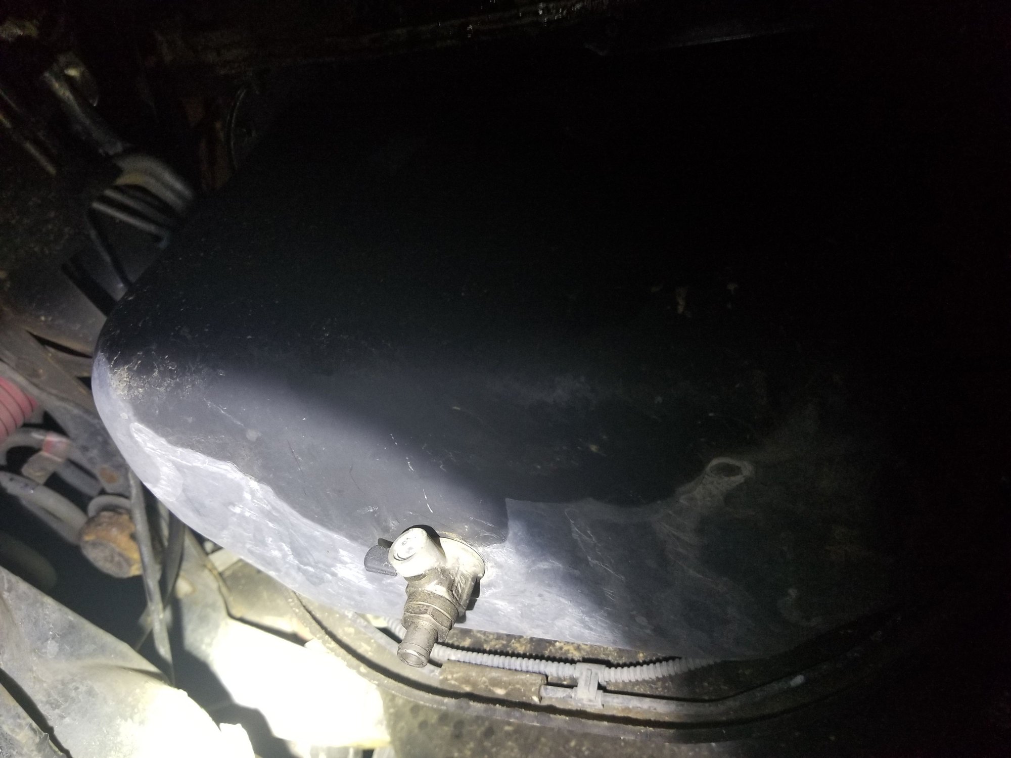

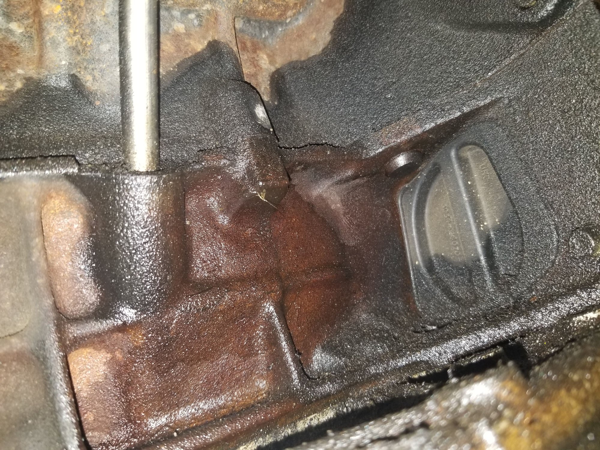

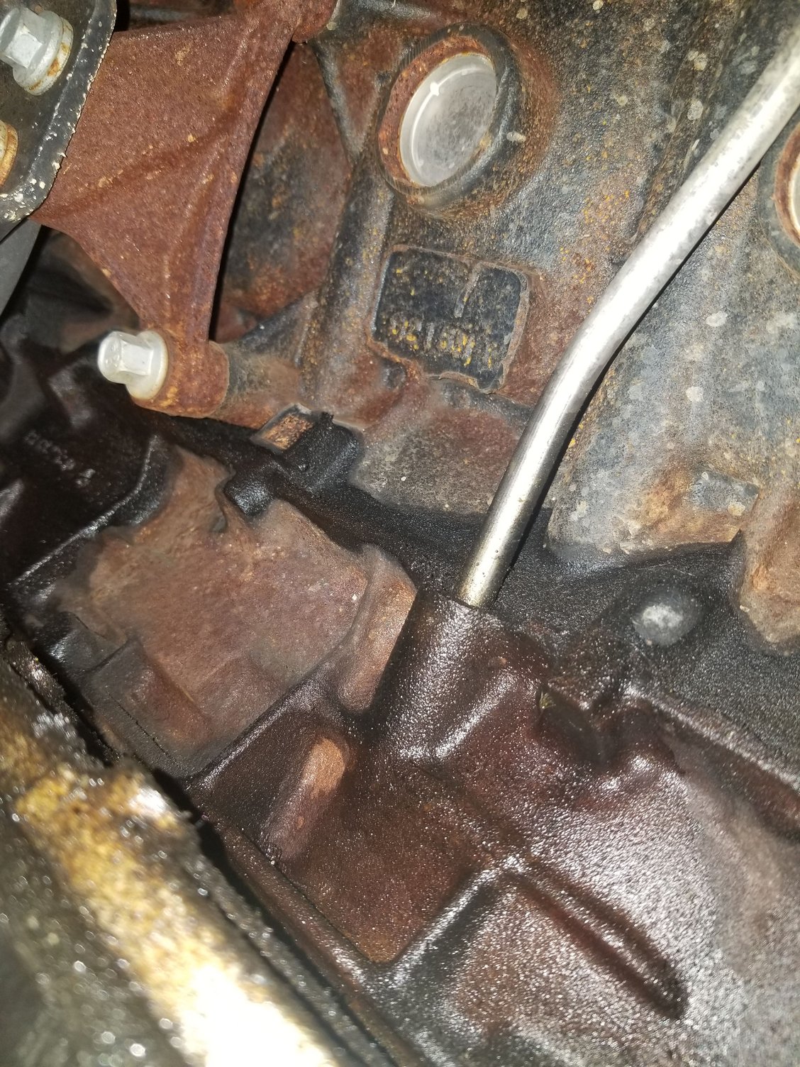

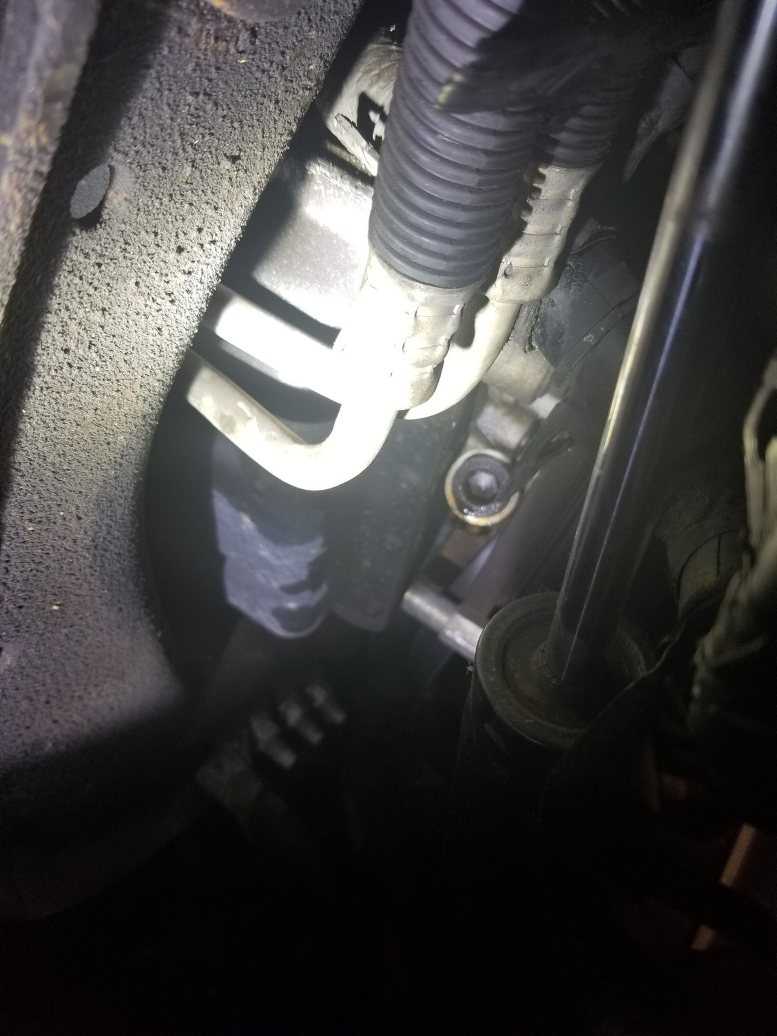

I know I have been having this issue for a little while. I am in the middle of doing a compressor change and all that comes with it and I figured now is a good time to get some pictures of the areas that have obvious signs of an oil or transmission leak.
I know for a fact i have a transmission fluid leak because I have to add fluid every so often. Engine oil....I am not so sure. I have not checked the level of oil. When doing an oil change I put 15qts. I have recently read that sometimes 15qts causes a leak and to put 13.5-14 qts of oil and see if stops.

Rear main crank seal.... very common

The very first thing I'd do is re-seal the dipstick tube with a new o-ring. Clean, then see what's happening. It may be wrapping around to the rear plate.
You have the common seepage from the bedplate and oil pan, but not extreme.
Not that common. Most times it something else and the seal gets get dome as throwing parts.
Originally Posted by Euroman
X2 it was exactly the same for me last year. PO tried to seal with silicone, glad none of it got into the internals.
I agree with Jack on this and it's likely the bed plate seal.

When I got home yesterday and took a picture for another thread I have about my fan clutch adapter, I checked the valley for any oil and it looks dry. Doesn't appear to be coming from the valley. I'm planning on working on my truck again this weekend and will be able to get under there and follow the dip sticks and see what I see.
