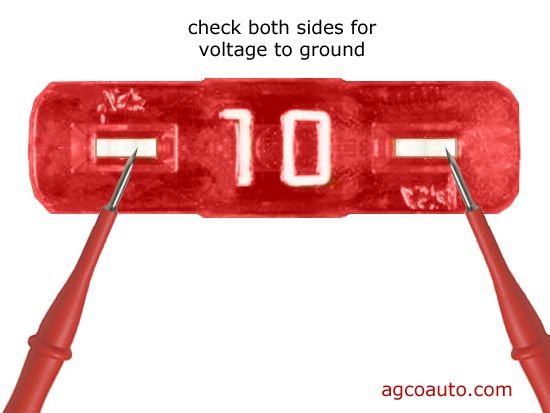

I would be connecting the meter Negative lead to a good Frame Ground and then testing those points with the Positive lead of the meter... it should read 12 V
Old Aug 2, 2019 | 05:35 PM
lonewolf_'s Avatar
lonewolf_
Scope Wizard
Joined: May 2019
Posts: 6,530
Likes: 25
you don't even have to pull the fuses out they have test points built in

Did what requested. 12v going all the way thru fuse s but no power to either side of fuse 8.
