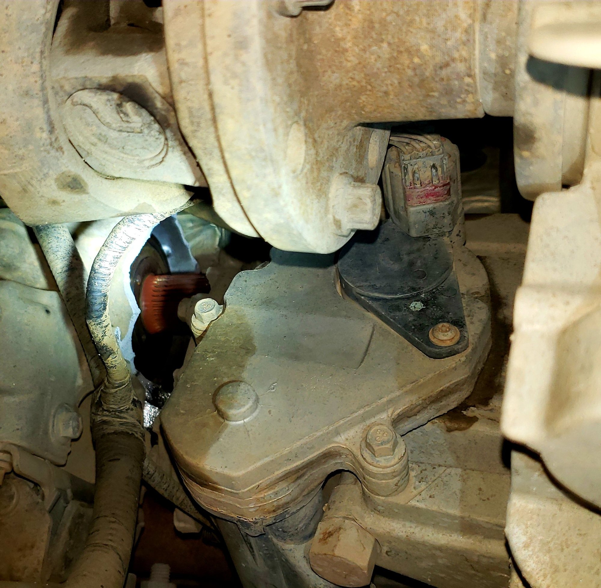

Yep driveshaft.
Double joint seized. Catastrophic failure.
Three days in a cheap hotel.
Old Aug 5, 2019 | 10:21 PM
Jakerichards1's Avatar
Jakerichards1
Joined: Sep 2018
Posts: 385
Likes: 19
No fun
Is that the rear housing of the transfer case that came apart ? Looks like more than just a joint that came apart.
What all did it take out?
