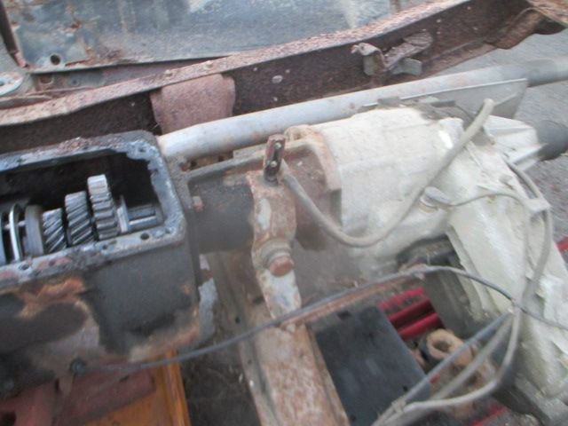

I searched the stickies but didn't see anything - can you guys tell me if this is a married or divorced type setup? Thanks

Married. Divorced would have a little stubby driveshaft between the transmission and the transfer case. The one above is bolted directly with that cast piece inbetween.

Lol, thanks. That's what I thought based on descriptions, but I didn't have any visual proof until I was able to remove the cab yesterday.

Divorced only came in certain 70's trucks, don't know about earlier than that. All 80-up had married from the factory.

Divorced Transfer Case: 1959/65 F100 4WD; 1959/76 F250 4WD; 1977 F250 4WD before serial number Y20,001 (High Boy).
Pic: 1973/77 F250 4WD (High Boys) w/divorced transfer case.
