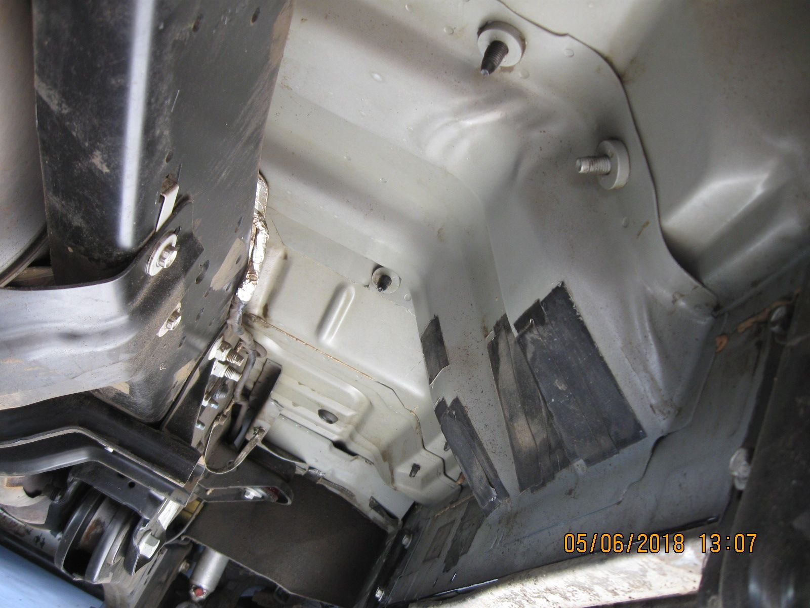

I've had excellent results using fluid film. I spray it in on the fall and get a layer of dust on it to help seal it in then don't wash the underside again until the following spring when all the salt is off the roads. We usually keep our vehicles 6yrs and the last two have been 99% rust free with the only rust showing anywhere has been on the parts that were rusted from the factory(steering gears, tie rods ends) and areas that see direct spray and weren't touched up as needed.
Here are some pictures of my 2013 F250 from last spring(it looked the same this spring also)
But are you in the rust belt? If that's a midwest salt truck i would be sold.
I was going to get mine done when i first got it but the guy was backed up like 2 months and i forgot. Going to get it done soon but the rust has already started in a few spots so im going to try and clean them up as best as possible with rust converter and a wire wheel.

I live in northern Iowa. I'll admit my truck doesn't see as much salt as others in the area because I try and stick to the county roads that aren't salted as heavily and my job has me plowing roads when they are the worst but it does see salt. I also don't wash the underside off until the spring cleaning so the salt that does get underneath stays there.
My wife's truck sees alot more salt then mine because she had to run the highway to get to work and hers is almost just as clean as mine. Only rust on hers is a little bit around the lower A Arms and around the rear springs/axle. I'd say hers is 99% as clean as mine.
Only problem with fluid film is you have to live with the grimy mess, but that's a fair trade off for not having rust underneath.
