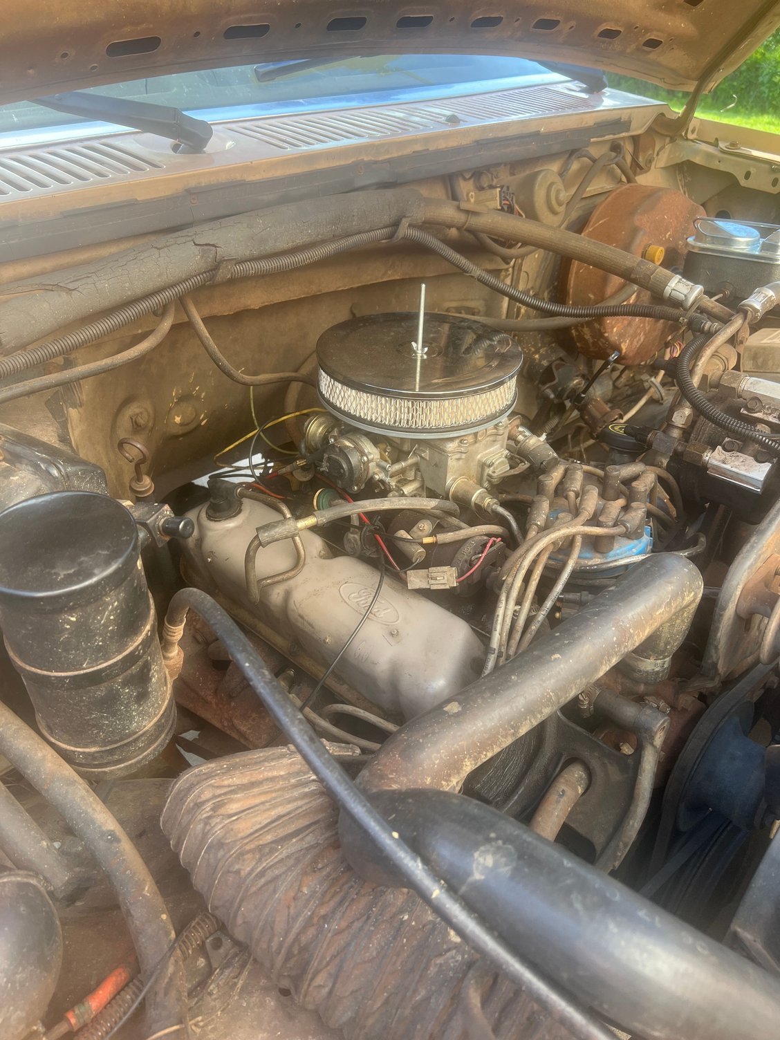

Hey guys I just traded a motorcycle for a 1981 Ford f150 2WD. I drove it home 3 hours and a long the way I stopped plenty of time to let it rest and fill up on gas. The issue is that steam is blowing out of the coolant return line. There is also a tiny amount of smoke coming from my head cover gasket and from my oil filler cap (where i think the pcv vavle should be.) I changed the oil on it and had no signs of coolant or water in the oil. I also changed the thermostat and had no change. Also, the hot cold guage does not work.

Ok picture #1 I cant make out what it is you are trying to show us?
The grey thing is called a valve cover and under it you have rocker arms and push rod that work the valve in the head.
It looks a little wet like the valve cover gasket is leaking.
Some times you can snug up on the bolts but not too tight or you can bend the valve cover lip, push the gasket out and have it leak more than it is.
Gaskets are cheap so yo umay want to just get a set and replace them.

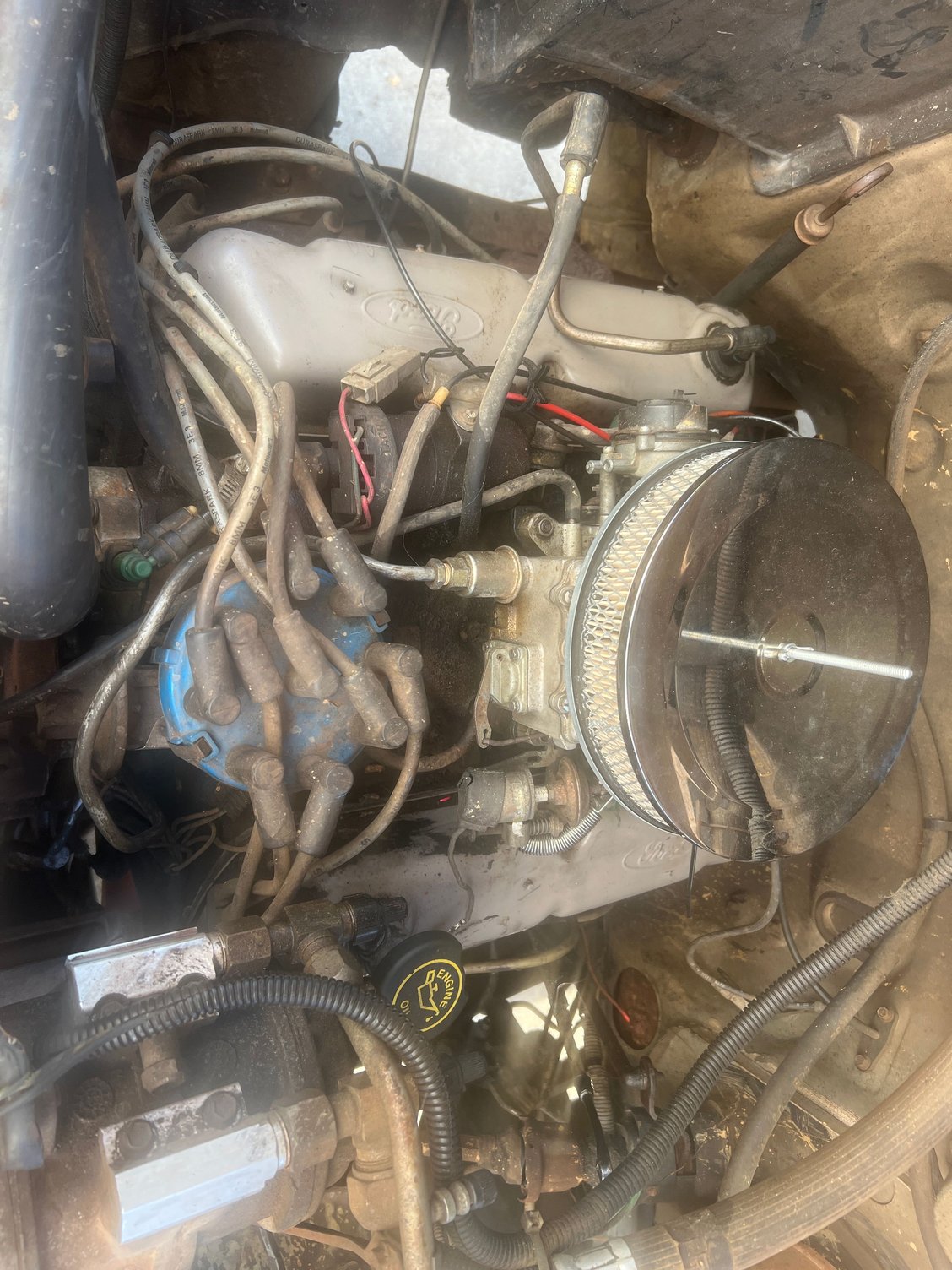

Picture #2 looks to be where a hose connects to and then to the side of the air cleaner housing.
In the housing there should be a filter on the side that the hose goes to.
This is how clean air is pulled into the motor from the PCV.
The PCV should be in the other valve cover (#1 picture) at the rear.
Clean air goes in on 1 side thru the motor and out the other side into the carb to be burned when the motor is running.

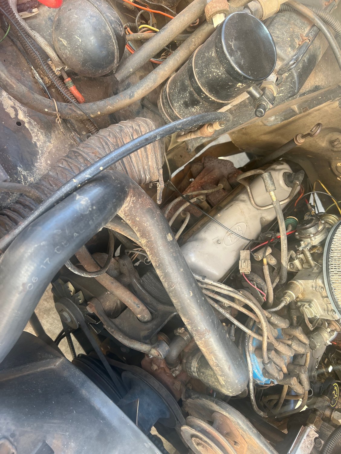

Picture #3 is a combo of windshield washer (wires go to the pump on that side) and radiator over flow (green fluid).
I cant tell but the hose if it goes in the top is over flow and if long enough to reach almost to the bottom can act as a recovery.
With motor cold remove the radiator cap and check the fluid level. If the hose went to the bottom and the cap is good the level should be pretty close to the top.
When the motor get up to normal temp the cooling system expands and coolant is pushed out to the over flow container.
When the system cools off and the cap works and hose to the bottom, coolant should be pulled back into the radiator keeping the level to the top.
You may want to top off the coolant and make sure the hose goes to the bottom and then check the radiator and over flow levels and adjust from there.
You might have seen steam if the radiator is low. Again if the hose is in the fluid, cap works the radiator should not be low.

Picture #1 is just trying to show the steam coming from the valve cover so yes it’s probably a valve cover gasket leak.
Picture #2 okay there is a hose that comes from the top of the valve cover where I think the pcv valve should go, there is a hose that comes out of the top of it as shown but I am unaware of where that hose goes, it could just be loose… I’m at work currently so I will have to check into that this evening.
picture #3 so I have put new coolant into the overflow tank but I thought that it would flow into the radiator if it needed. I have not checked the cap or the actual level inside the radiator. Normally what happens is steam is pushed out of the overflow pipe and makes the coolant in the overflow tank bubble. Also, idk if this matters but, I had to take the main radiator hose off when replacing the thermostat and when I replaced it, it was loose. Test drove it after I replaced the thermostat and the steam was shooting out of the radiator instead of the overflow hose going into the overflow tank.
Thank you for the reply I will check into the radiator cap and radiator itself this afternoon.

For that valve cover, just take a 7/16 socket that is 1/4" drive and snug all the valve cover bolts, you may want to snug the oil pans bolts too. Doing that a few years back helped mine. Remember you are snugging them, not trying to break them.

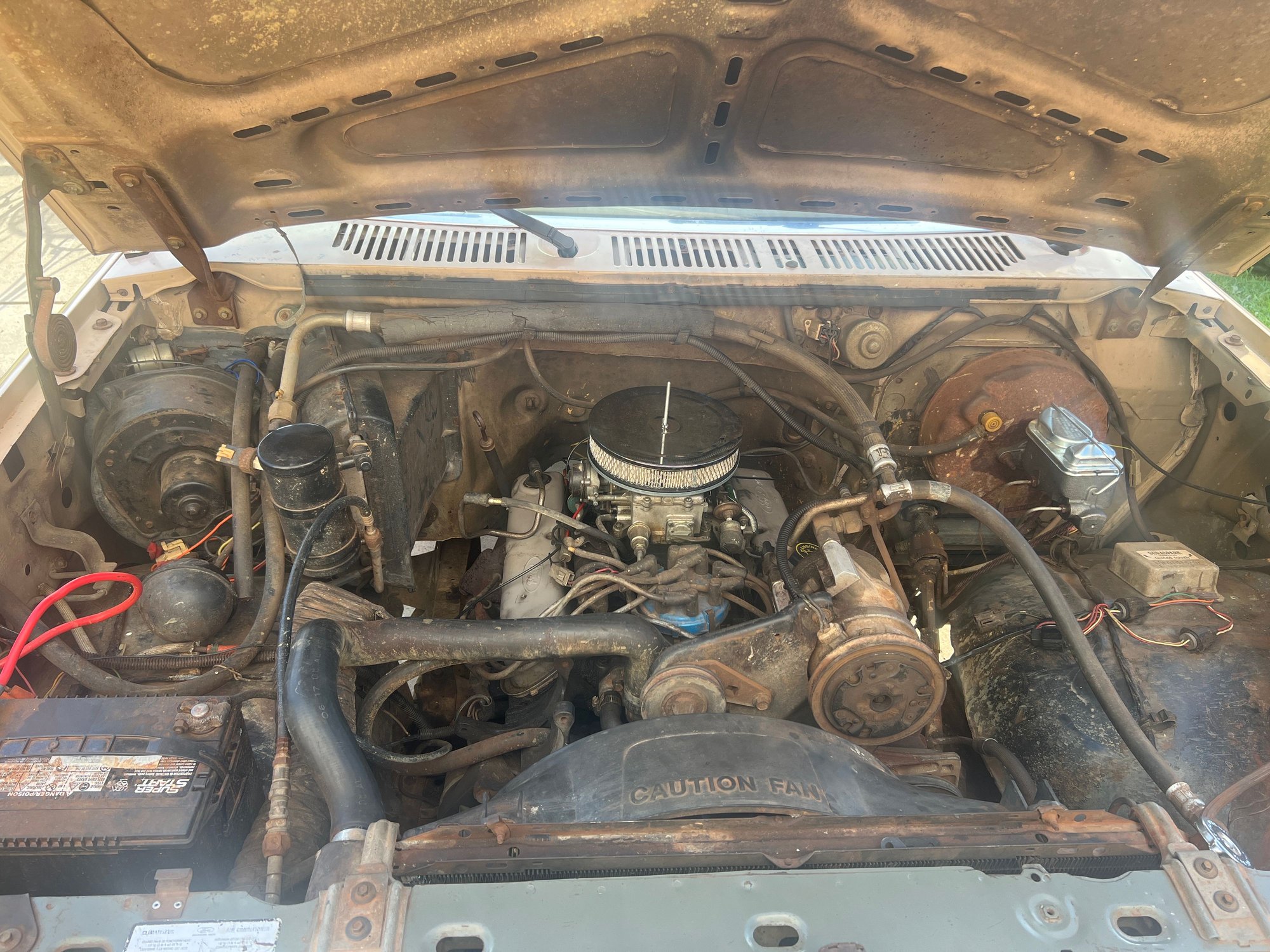

If you can take a picture of the motor a little farther out so we can see the full motor would help.
The "steam" you are seeing from the valve cover oil fill is oil vapor or blow by,
A hose goes from that oil fill tube to the air filter housing on the side.
The PCV should be in the other valve cover in the first picture to the back and a hose to the base of the carb / intake manifold.

I did not top it off before the test drive… i will post another picture shortly. And look for where the hose from oil fill needs to go.

Can't tell what your over flow bottle is doing. As was said make sure you have something in there. All these overflow bottle systems are different. I always warm up and then top off using 50/50 mix. In the overflow I put in a gallon of coolant as well. Mark the levels of initial and hot and cold levels. Some of these overflows do not allow expansion and contraction I've seen. I wouldn't use the type that won't draw coolant back into the radiator when cold. Maybe the draw straw is missing on those? We've seen a few here.
