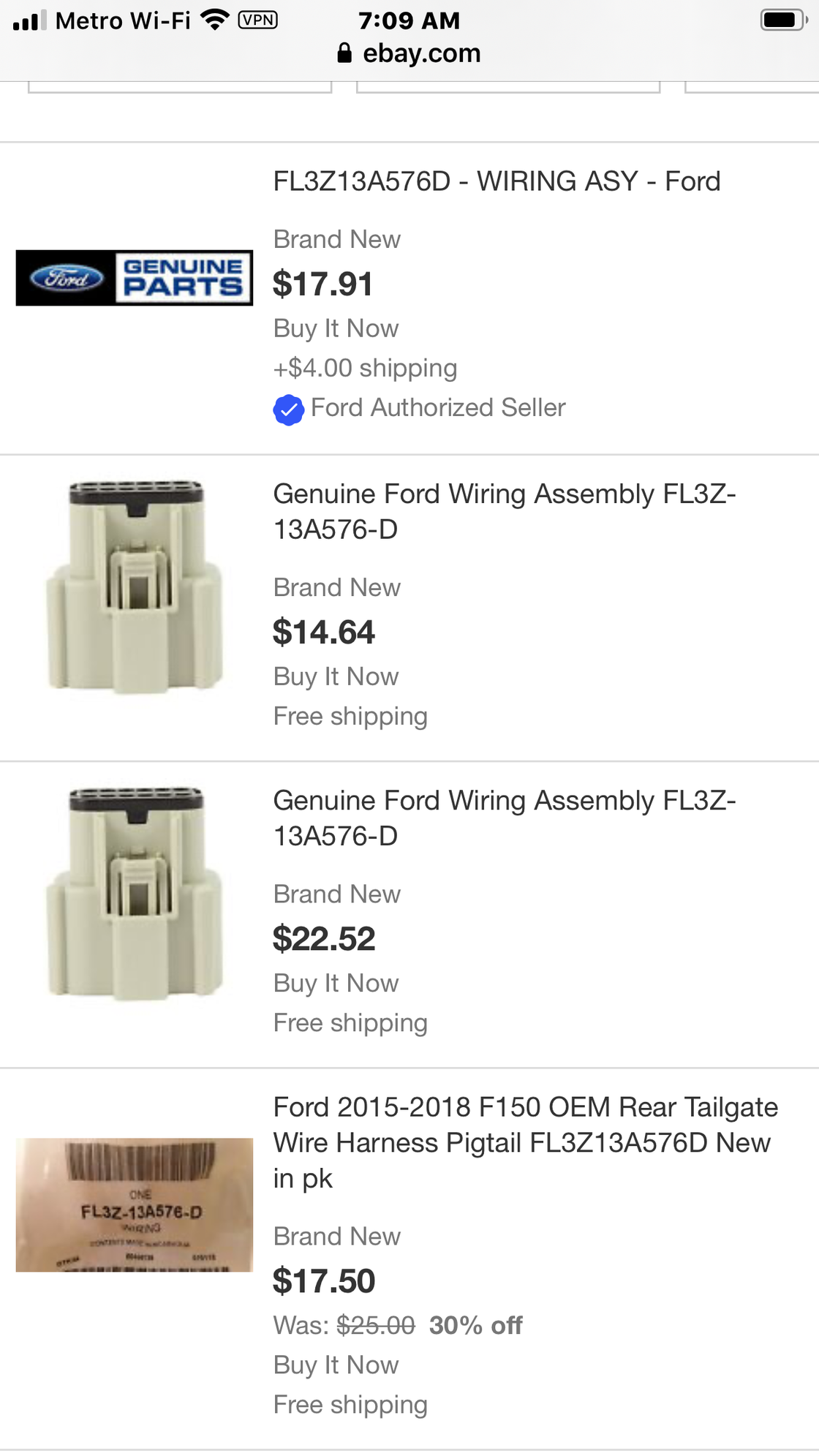

Originally Posted by satz28406
OK. On my 02SD it was easy to remove the tailgate. On my 19 it appears to be a bit more involved due to the camera and tailgate lock and the harnesses from the frame into the bottom of the tailgate.
On page 75 of the manual, it talks about a tailgate removal kit in the glove box, which will plug the frame connections where you unplug the harnesses.
My dealer is saying there is no such kit.......I've not been in to show him the manual because I'm waiting for my plates and a couple of other things.
Is there such a kit, and if there is what is the part number?
TIA
Rush Truck said it is PN: FL3Z13A576D. I’m told it is not available. Respond if you learn otherwise as I am looking for one too.
like everything else you are supposed to get with a new vehicle....it winds up on eBay.
i was going to buy one since I got nothing with my new truck in 2019...but—-it appears the part numbers might vary with the model year.

Ended up with kit HC3T 15A562 which had almost all the plugs and also bought HC3Z 13A576 C separately. Have 1 little blue plug left, but all is ok. Thanks all!
