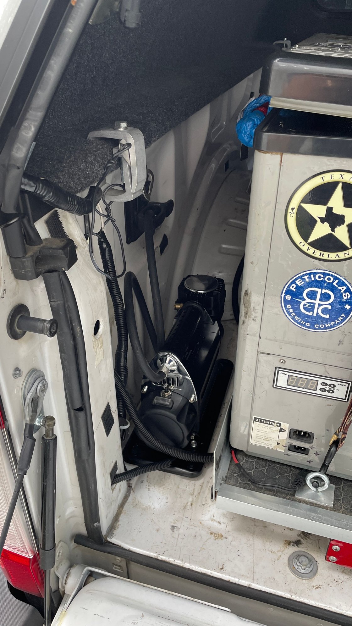

Lot's of great ideas in this thread from some smart dudes. I chose to mount my compressor in the bed in an unused space between the bed wall and the bed slide. The wiring/plumbing is cleaned up by now.
Here's my air chuck location.
