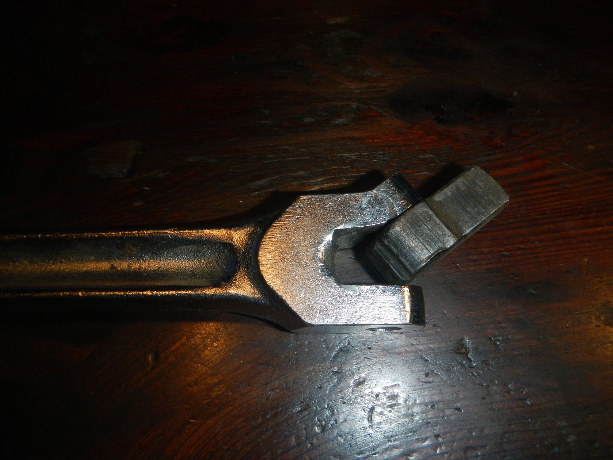

I had the same problem on my 65 F250.Had to get a 3/4 drive breaker bar and a impact socket with a 3' piece of pipe and jump on it. No studs broke but my 1/2" breaker bar did. I put anti-seize on the studs and haven't had that problem again.

Ya, impacts are not of much use in this situation, nor is WD40, I agree. Alternate heat,a lot of it and your favorite “knockerloose”. I also agree that with a large breaker bar you should be able to move the lug but or break the stud. Get a lifetime 3/4 breaker at Harbor Freight so you can get another free, each time it breaks!
