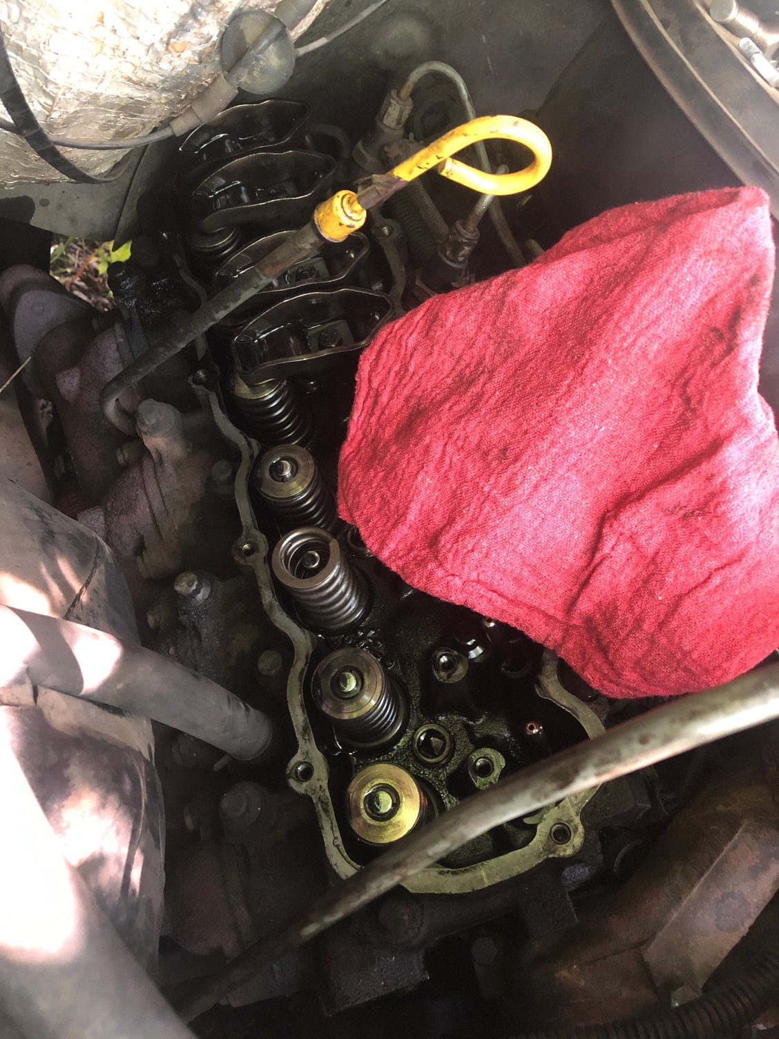

When I had some downtime a few Sundays ago, I opened the valve cover, and saw this:
On the No. 3 exhaust valve spring, note that the end is poking out from under the retainer just a little bit, as if it's severely out of square or the stem is bent. Jiggling all the valve stems by hand, all had SOME clearance, indicating no valves were binding, and none had very much clearance, so no indication of severe guide wear or anything of that nature. At this point, a good customer called with an emergency, so I buttoned it back up and took off. As it turned out, it would be another 4 weeks before I got into it again.

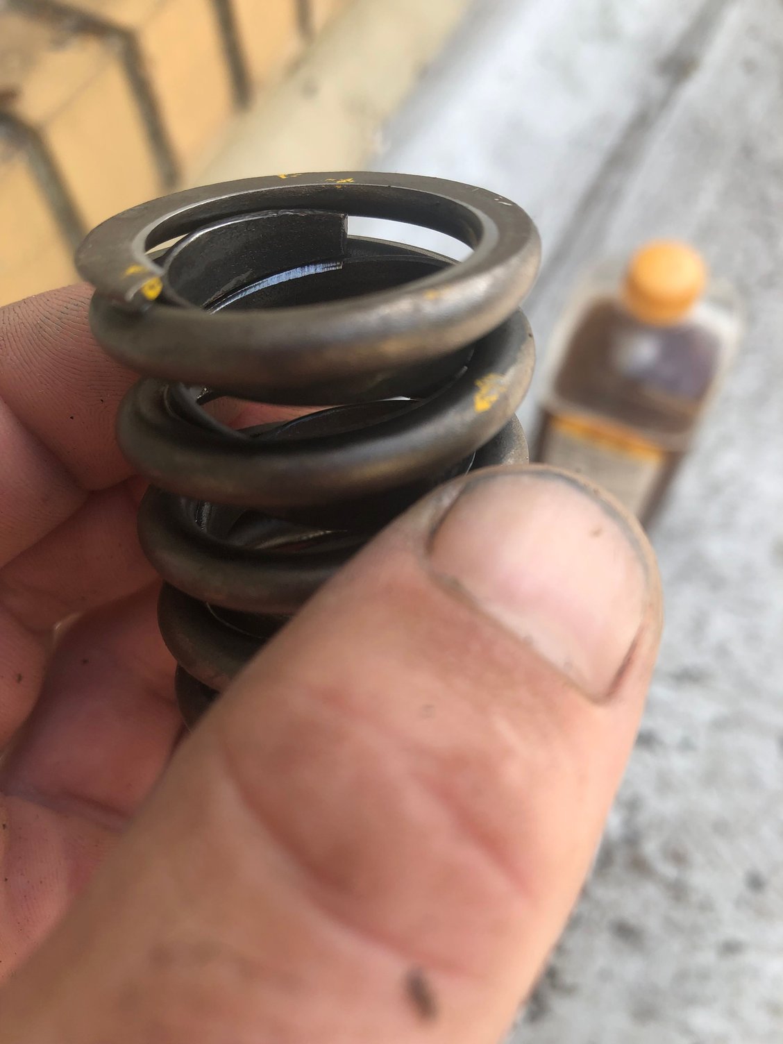

After buttoning it back up, the tick noise was completely gone. I washed the spring off in the kitchen sink, and you can clearly see that, as predicted, the damper slipped away from its intended position, and is overlapping itself. These springs are fairly light, and I could even reproduce the clicking noise by compressing it between my hands. I have no doubt I could've run this spring for another 100,000 miles, but I'm happier knowing it's fixed and not having to hear the noise. In the photo below, note the abnormal wear on the top coil of the damper spring. It's not obvious from the photo, but every time the spring compresses, the "tail" of the damper spring slides over the "tail" of the main spring, and randomly either makes a "click", or binds up on itself, causing wear but little noise.
