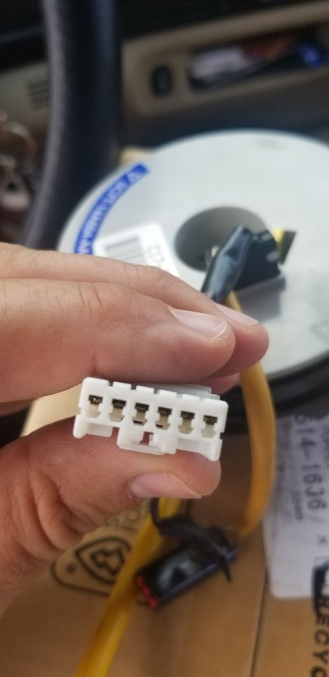

Mikei70, if you go to the Dorman site you can get a better view of those 2 part numbers you provided. The 525-227 has a male 5 pin plug on the top with no cable. The 525-236 has the incorrect female plug on the top. This has been pretty frustrating.

Mikei70, this part has the male plug on the top, no cable. They do have it in stock and the parts guy pulled it to verify the connections. The search continues...

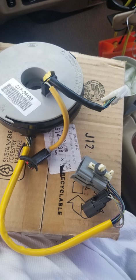

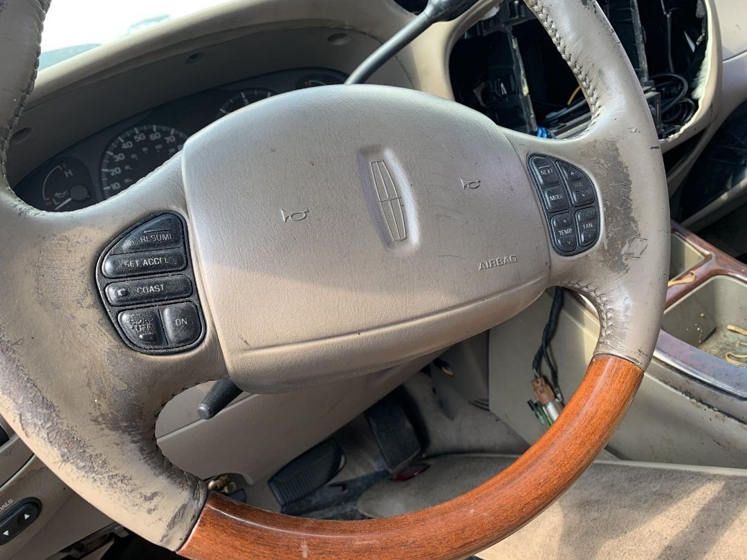

So our crappy white trash junk yard has a 1999, and a 2000, Navigator. The clock spring will possibly work.
I think what you need to know is what does yours looks like. If the one you took pictures of is the new incorrect one, how does that compare to the original broken one in your X now? Between your incorrect new one, and your original broken one, do they have the same amount of conductors, the same amount of paired wire sets, Etc. If the brand new incorrect one has the same amount of wires, and they are grouped the same, and the clock spring casing is the same as your broken one, you can probably just switch the plugs.
Additionally, and you probably already know this, Part# 5C3Z-14A664-A is for the 7 circuit 6 pin connector, and Part# 2C7Z-14A664-AC is for the 8 circuit 7 pin connector

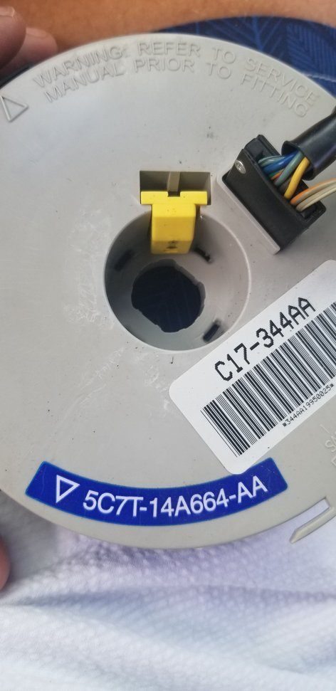

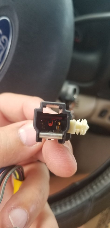

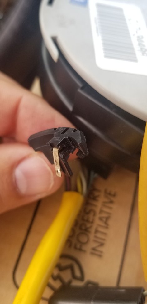

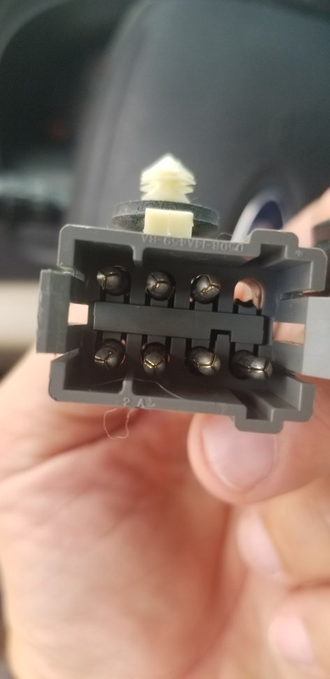

The pictures that I attached are the original part. The issues that I’ve run into is the 6 pin connector to match up to anything new. The only clock spring that had that 6 pin connector was for cruise only steering wheels which is an option as I can still control manually the radio and such. Just seems to me that either after market or factory part should solve this issue.

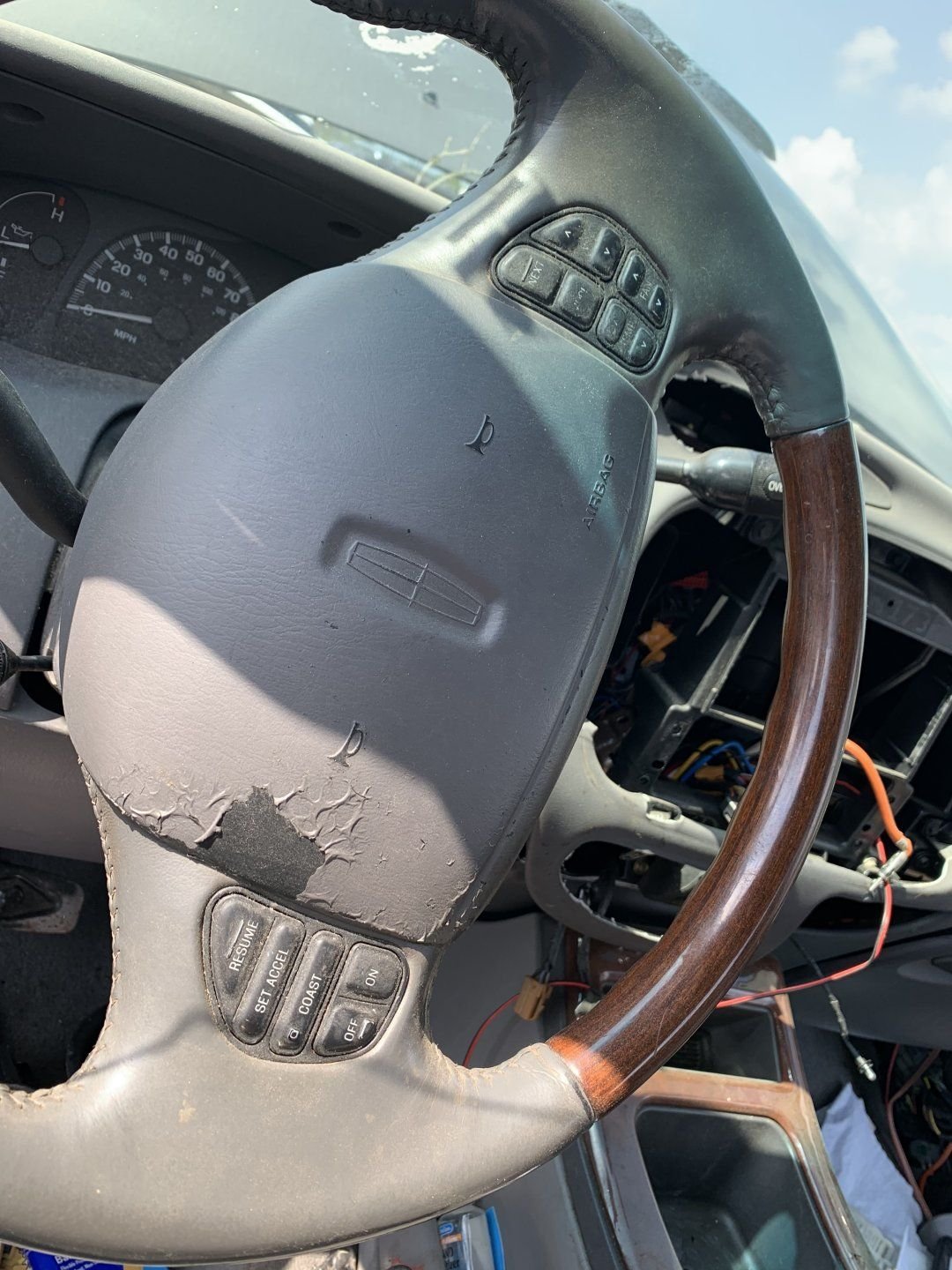

I’ve been researching the idea to replace the steering wheel with one from a Navigator that way I wouldn’t have a firmest issue. Has anyone else out there just swapped out the steering wheel with controls to replace the Excursion one with controls?? I had just replaced the controls on my 03 Excursion steering wheel!! Wish there was an easy solution to this problem but aftermarket supplier Dorman knows of this issue but no resolution in sight!

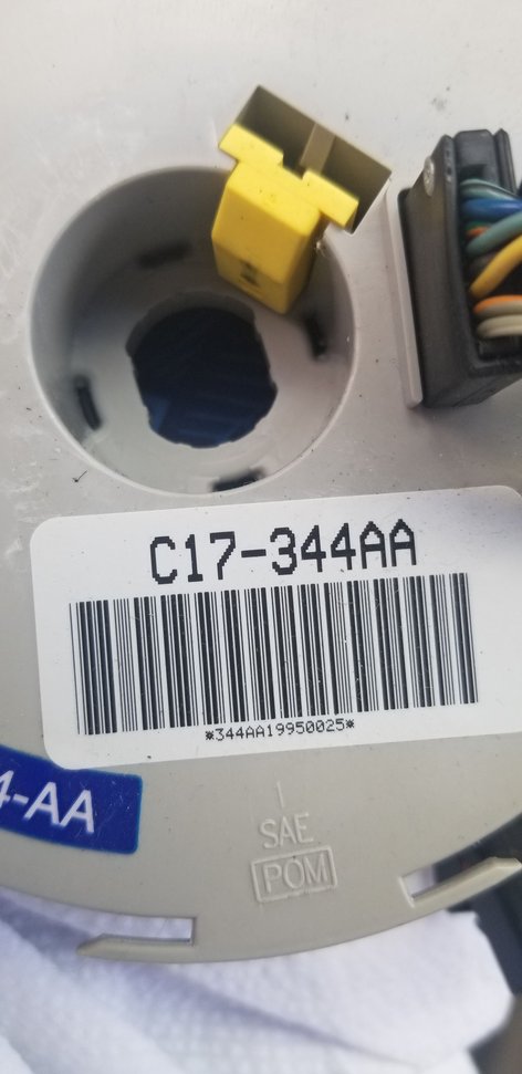

Here's the used one I have from a 05 limited 6.0 with cruise, stereo, a/c and whatever else i can't remember.

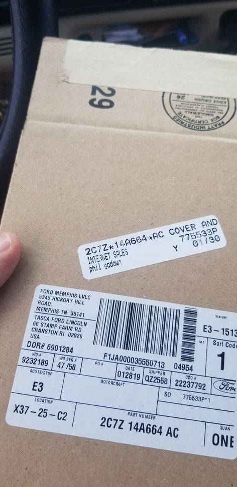

And here's the brand new one I bought maybe 4 months. My cruise and horn went out and it was diagnosed as needing a new clockspring. Had the new one installed and still no cruise or horn, so now I'm being told it wasn't the clockspring and to swap out the airbag.
the airbags for these trucks are impossible to find compared to the clockspring! I had to source a used one to install. I'm also replacing both left and right side steering wheel button clusters for the cruise, air radio etc..

P G that is the correct part for our trucks. I replaced mine earlier this year in the Spring, because my airbag light was on, and my horn stopped working. Oh yes and I was haveing trouble with intermittent ignition switch operation and no cruise. The new clock spring fixed everything except the cruise. I tried replacing the buttons on the wheel to no avail. I got into an argument with the parts counter guy at the Ford Dealer because he said the Excursions didn't have the "redundant" controls. He was wrong of course and ordered the parts for me. That darn cruise has me stumped. I've tried everything. I think I have a broken wire somewhere. The diags don't tell much, except that it ain't workin
