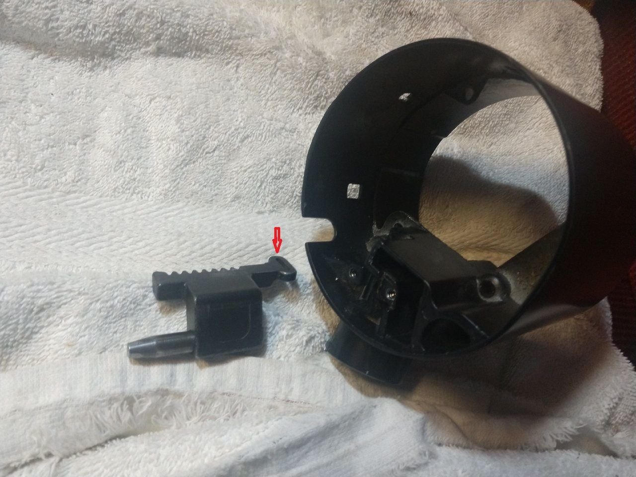

Did you pull the steering wheel and see that the actuator wasn't broken? Some break down in the column and would be hard to see unless you did pull it out some. After I did my actuator rod, I had an issue similar to yours and it was a switch on top left side of the column ( wheel doesn't have to come off) and has a elongated area for adjustment. I forget what it is called but I adjusted it and all was fine. If you find the actuator rod is broken let me know and I can give you an option instead of a complete tear down which is NOT fun. Sandy

Where the rod goes into the area you are calling the ignition starter switch, I don't believe you can see the end of the actuator. It has a hump on the end. I have read many break in there and folks have to drill them and put a screw in there to get them out. Mine broke on the right side. The other thing that can happen is there is a pin attached to the actuator rod. The pin is attached to the piece in the picture below and goes to the slotted area where the arrow is pointed to. The teeth on the piece go to a gear you see in the diagram number dummy post that the shift lever goes in. #3E717
.......... Your rod could be broken as described or the pin could be broke not allowing the piece in the picture to function or the gear in the shift lever hole could be bad (doubtful) but you can check it out. There is a Cir clip holding the gear in. Knock the roll pin out of the shift lever to remove it for inspection. You many have a totally different problem but those three things can cause an issue like yours. If it is any of these let me know and I can help you proceed. Sandy

couple thoughts came to me. I recall trimming off part of my actuator stick, for some reason I cannot recall. Maybe to be able to install easier without too much disassembly but I cannot recall. Also, I had a heck of a time with that little metal comb toothed thing in Sandy's photo above. If you get your ignition tumbler out of sync with it, you have an issue. It won't plunge far enough or you can't remove keys from tumbler, I cannot recall now. sorry, getting older, just some things I recall that MIGHT help if you start to get into a bind.

The reason you trimmed it is because you can remove the actuator without taking all the parts out. It is not easy if you have done one and it is not easy to get back together properly at least for me. If you trim the end of the actuator you remove the hump on the end and you can replace the actuator without taking everything apart. The down side as I understand, is you can remove the ignition key without turning the key all the way back or using the switch on some models. I am not sure why that is so important but some on here do not agree with this method. If or when mine breaks again, I assure you I will trim it to fit without taking everything apart. Unless, someone can tell me a reasonable downside to doing it. Sandy
