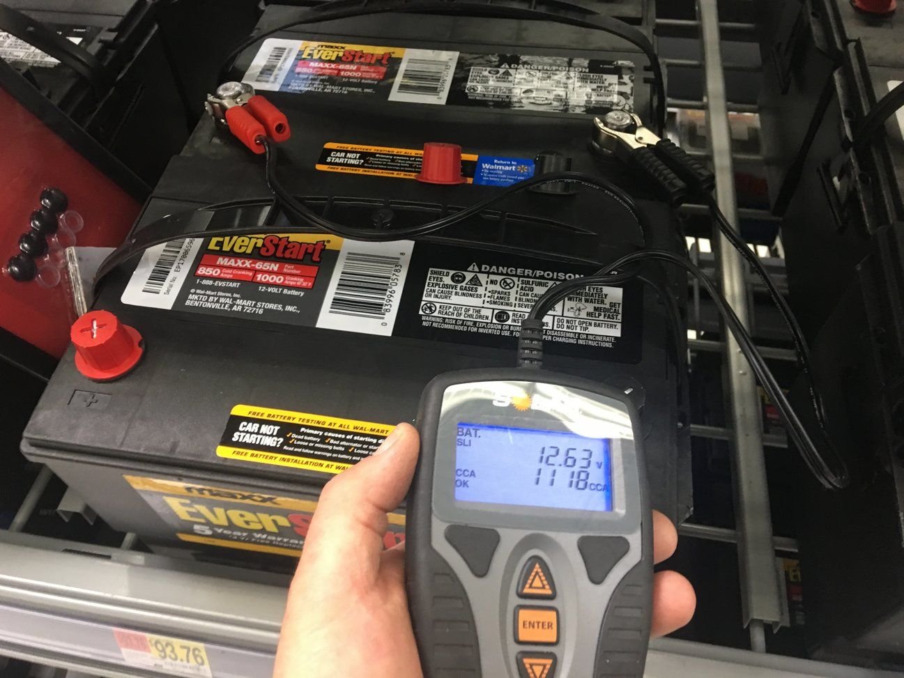

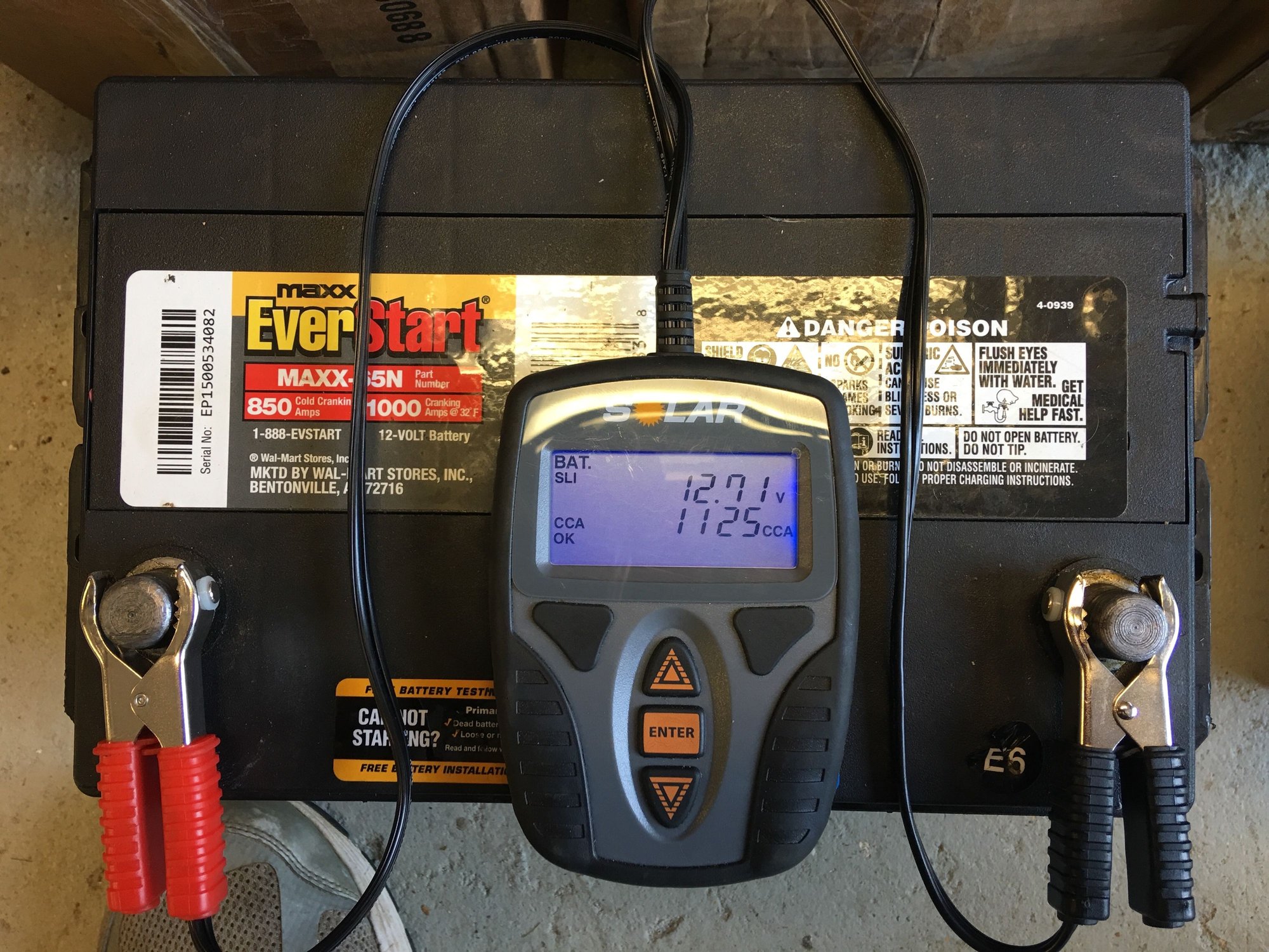

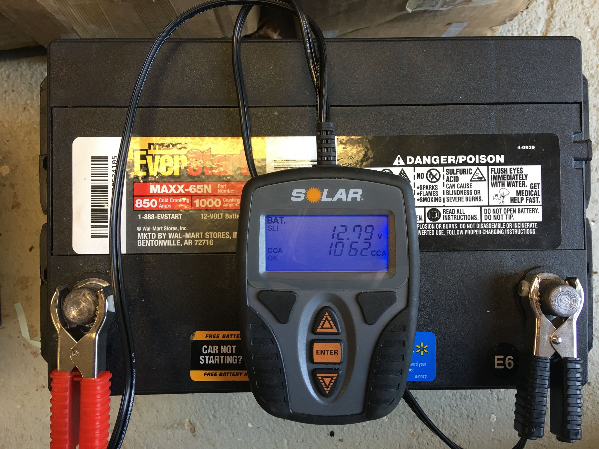

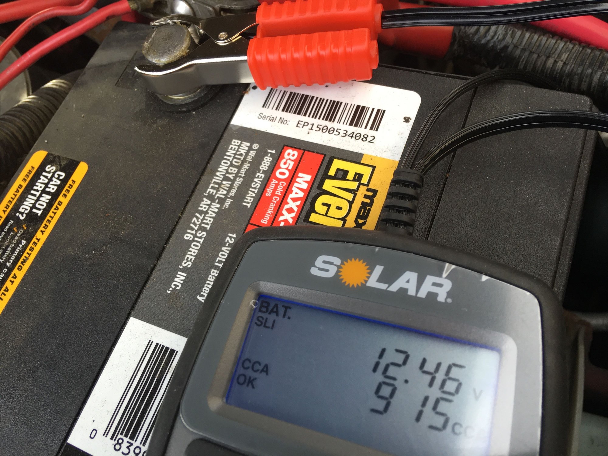

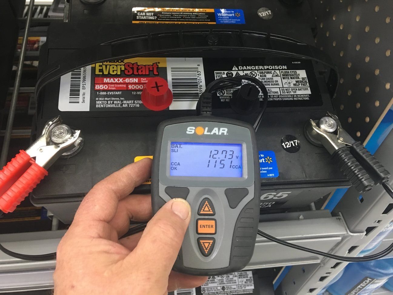

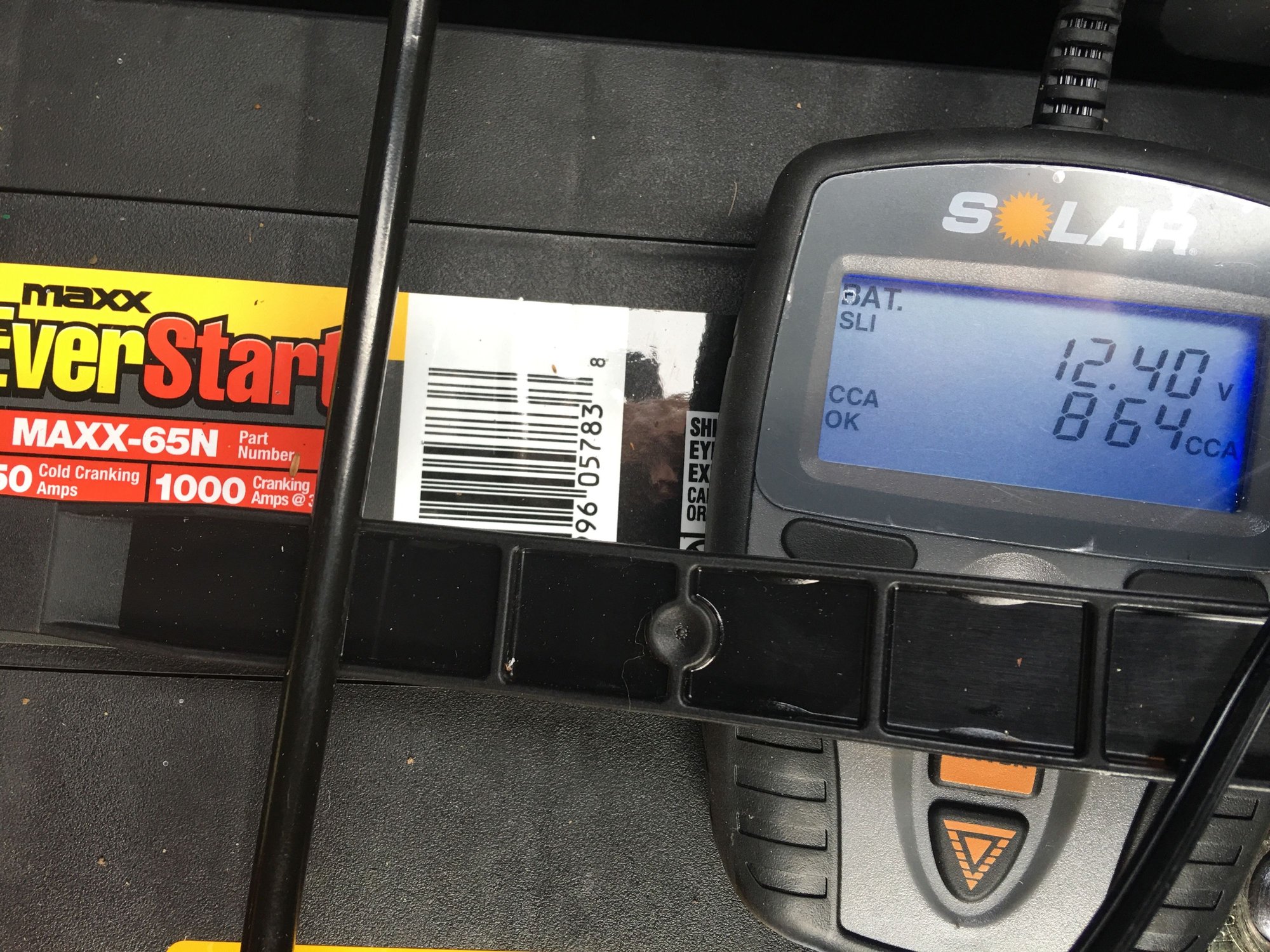

Maybe prime was a poor choice of words. Midlife?

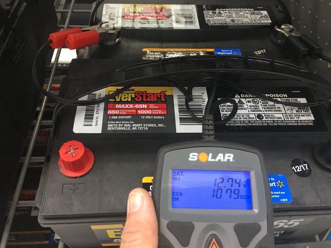

Here's my collection of readings, 7 through 10 are new at the store, the last two are my 2016 Walmarts (E6 date code) from my truck, but they've been in storage, well, for a while. The second one at 655 is called out as bad for an 850.

Wow! Talk about enlightening. I thought 890 was as good as new.
I'll never look at batteries the same. Thanks for posting Jack. Time to start shopping.

I used to mostly check batteries with a refractomerter, until I couldn’t remove vent caps. It was Randy who turned me onto that battery checker, and it’s much easier then taking batteries to the store to get checked. It taught me more about charging and keeping them up with a deep charge so they don’t degrade. If I’m parking for a week, a maintenance charger goes on. And having a dozen batteries to maintain, I could easily justify the tool.

Forgot to add, I now take that tool with me when buying batteries so I can choose the highest capacity one, or in the case of our trucks the two highest and possibly balanced. That’s what I was doing at Walmart, then I thought, I should show this!
