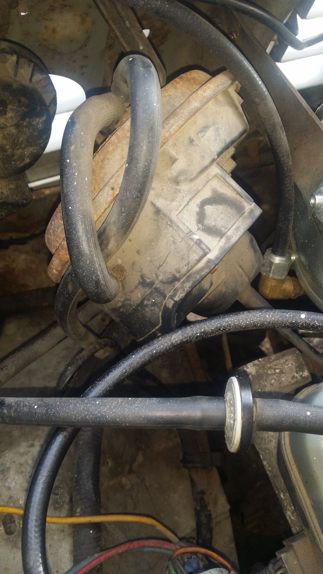

Maybe someone can help to my issue to with good advice. I have 1989 5.0 EFI engine. Recently it has the problem that after some driving when i am going to stop it starts to work very rough and then stalls. It starts right up and it continues almost everytime i have to stop. I messed with timing a little bit, advancing gave some results it stalled fewer times but still does. Also the idle is a little bit too low for my liking.
Today i looked for some vacum leaks and found some vacum line that is in the front of the engine buy in the right corner and it leads to some roundish part that is connected tonright side of the radiator if lloked from the front to the engine. When i disconnect that vacum line engine gains a little rpms and strange stopping problem disapears. Anybody know what that part does ? So does my problem is more vacum related ?
I did not whant to run without vacum so i reconected it back.
For now i put the piece of tge fuel line rubber on adjusting screw in throttle body and now it idles at about 1200 rpm bit atleast i do not have stopping problem for now.
So do i have point to order new iac valve, tps or just disconect that vacum ? But then i maybe will loose some functional and needed part ?

Here is the part.

I'm lost where you are in the engine compartment but that big thing at the top of the picture with the cable coming out going to the bottom-right looks like the cruise control servo motor.

Thanks. Already thought it is cruise. So if i disconect it, should i feel the difference ? Not using cruise anyway
