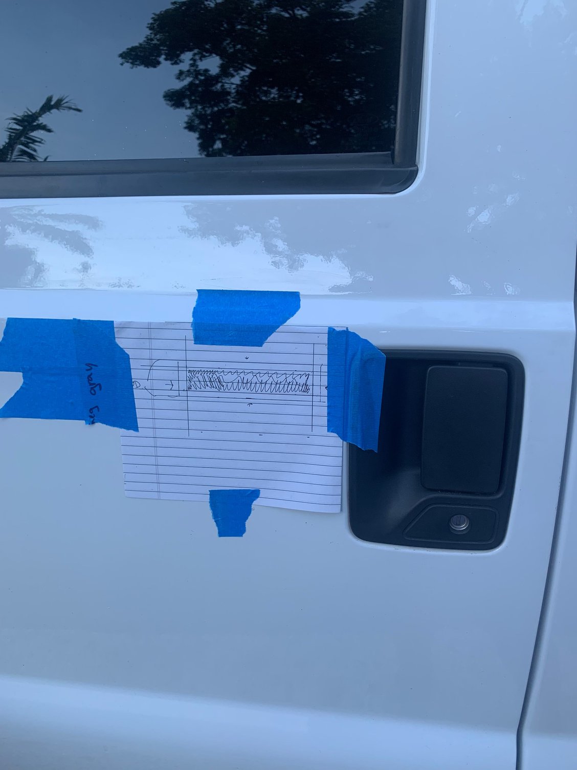

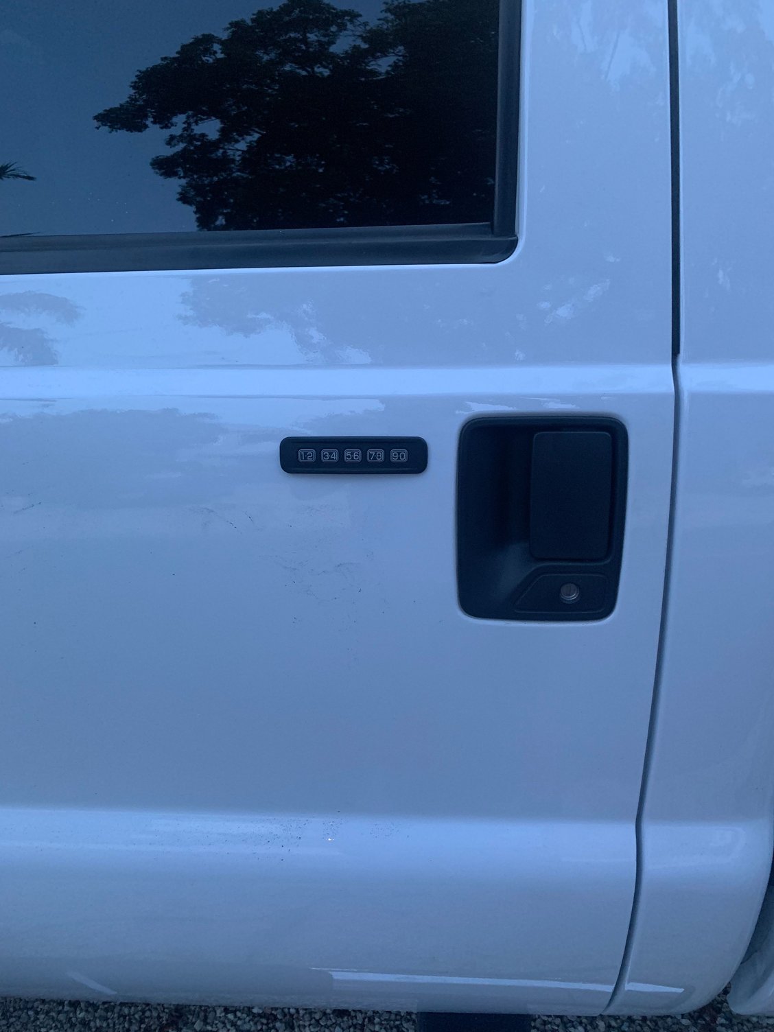

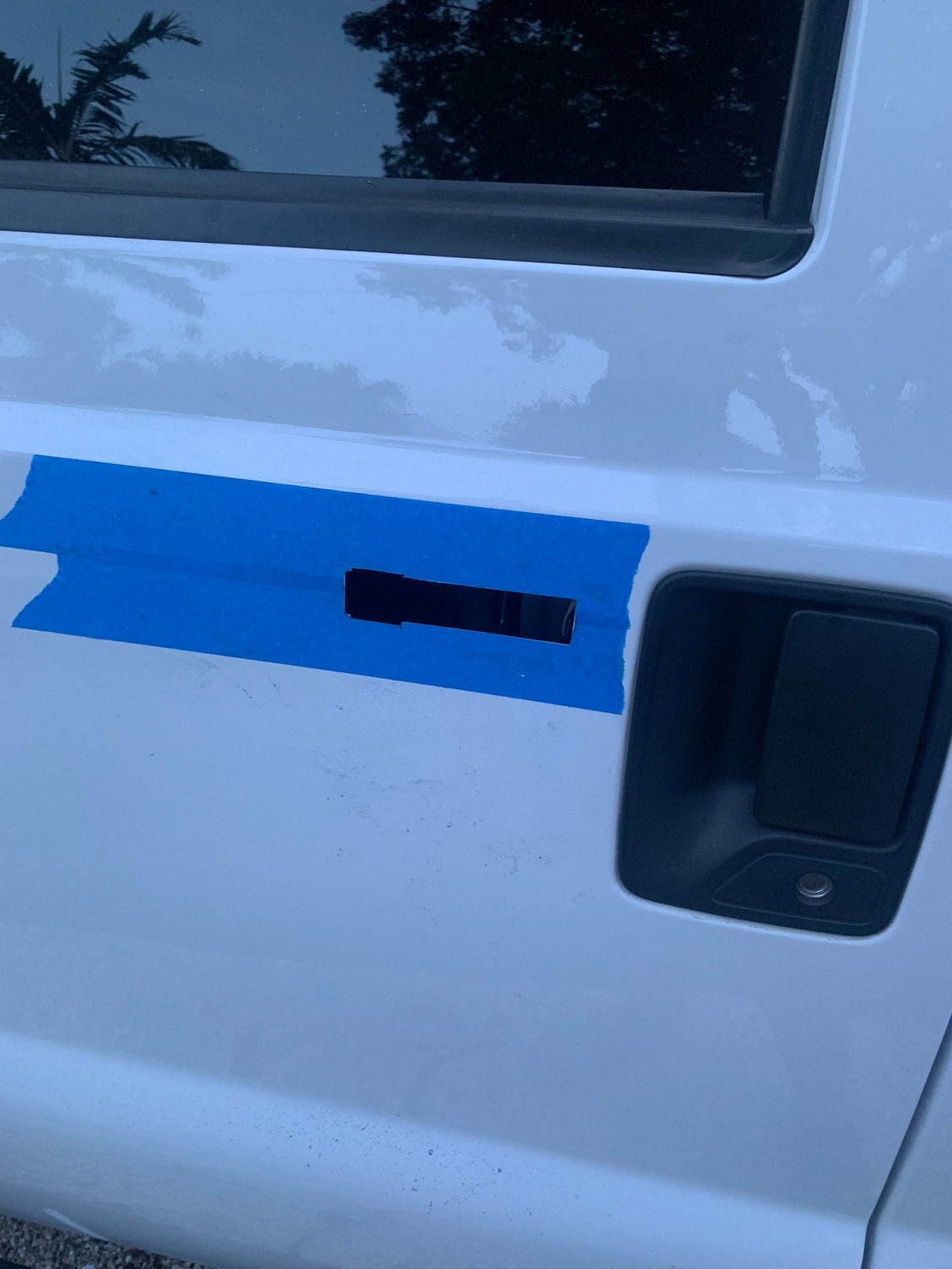

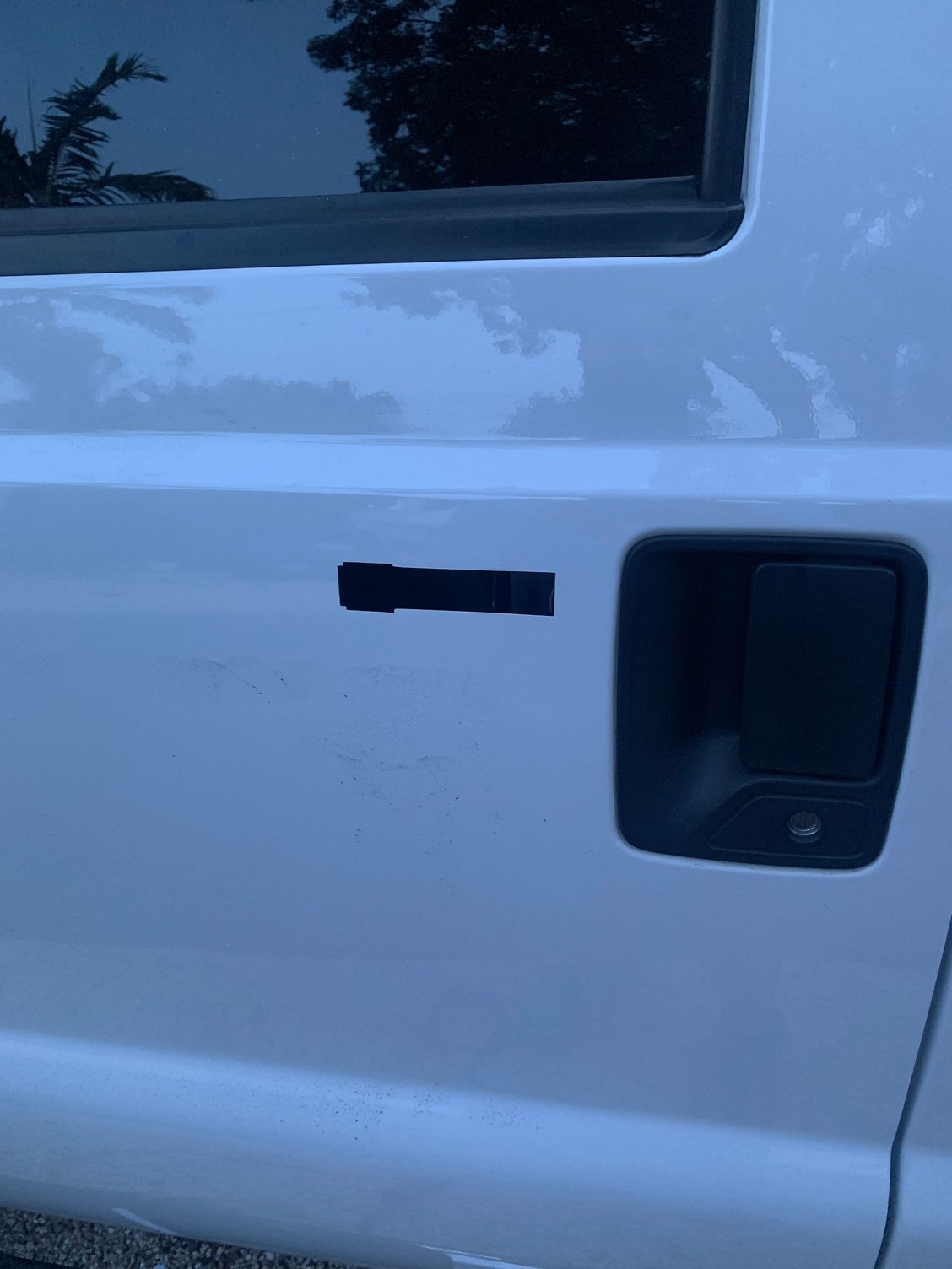

Well, tonight I hooked up the new door harness and enabled the keyless entry through FORScan. You have to change a set of numbers in the BCM that’s normally 0000 to 0001 to enable. Worked perfectly. I cut the hole in the door with a template I made and painted the cut edges with a color match paint marker. Very happy with the results. All functions work just as they did on my previous 07 reg cab 6.0
