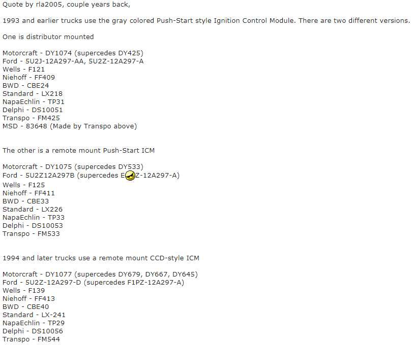

did they give you the right TFI=ICM module for your truck, 2 different ones for your truck, and they both are gray

ill look into the ICM. I don’t remember which brand I bought, but it should have numbers on it somewhere.
