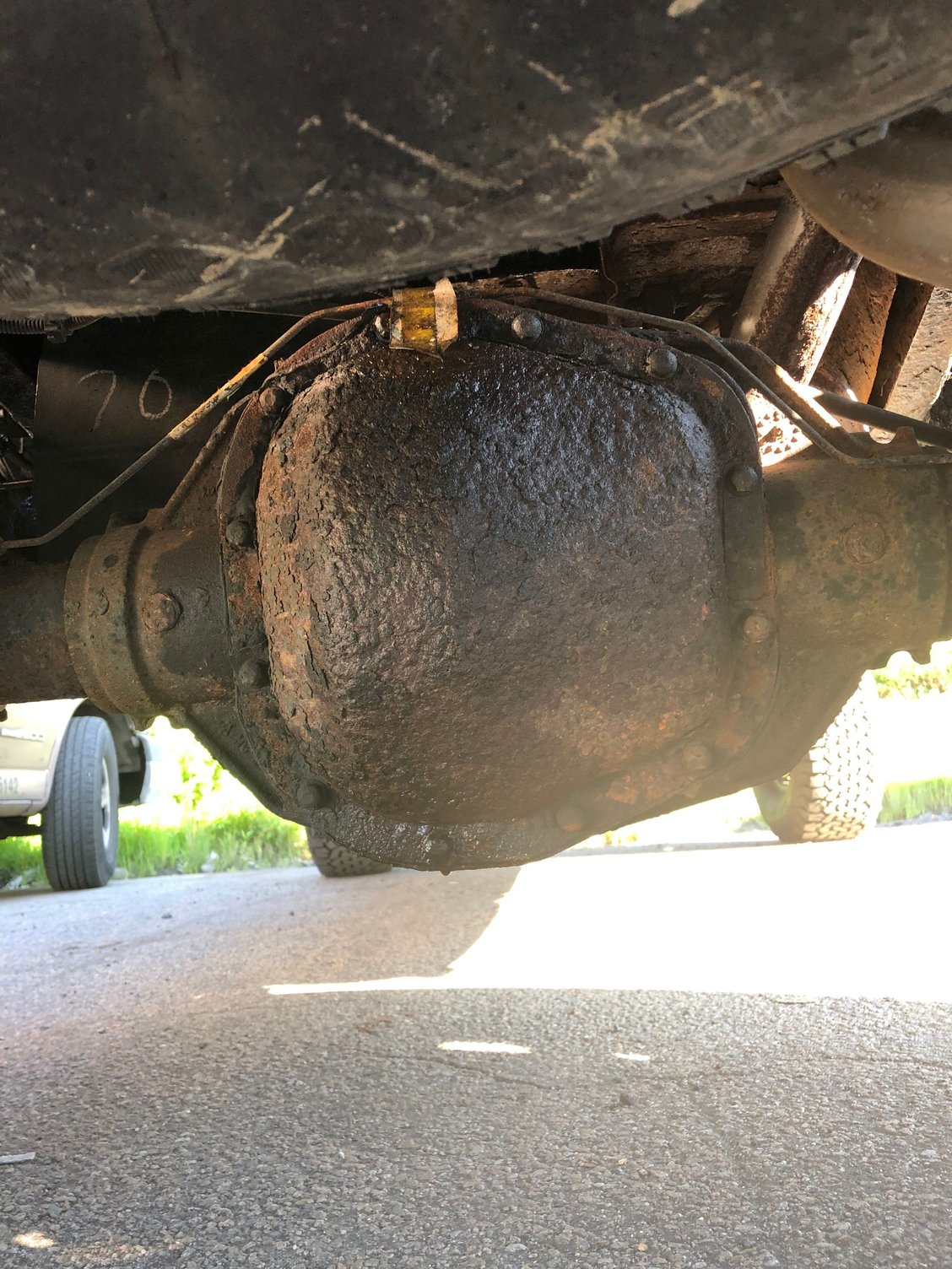

See the pic below. That’s not a leaking gasket, that’s gear oil literally sweating through pin hole rust perforations in the diff cover. Kinda awesome and gross.
I got super lucky and none of the diff cover bolts snapped. Clean replacement.

Nice job

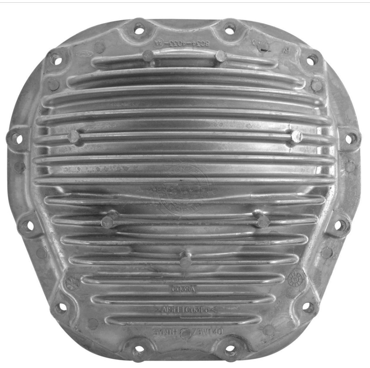

There was an aluminum diff cover that Ford put on the later Superduty, that was pretty cheap direct from Ford, in case anyone is wondering.
I notice you used blue RTV - does it smell like dirt? Or silicone? I did't think blue silicone will hold up to gear lube...

None of the bolts broke off…go buy a lottery ticket! . I hate that RTV, I use the LubeLocker gaskets, clean easy installation and reusable.

How much they charge you for the cover? My 03 was getting close to looking like that, but I sanded it and painted it and I climb under once a year and wipe it down then throw some more paint on it, at this point I would assume paint is the only thing hold the gear oil inside...LOL

Aluminum cover direct from Ford is less than 60 bucks

Is also supposed to dissipate heat better. I also went Lube-locker

Ford started installing these in 2008, they must have had a good reason to spend the money.
I also went with a Lube-Locker and it needs longer bolts.
While it was off I drilled/tapped an 1/8" pipe hole for a drain.
Absolutely with the next best one being black steel. The aluminum one would concern me only if doing a lot of off-roading. It sticks out more, isn't smooth, and it's not as strong as the steel cover.

Yes, and since the inside of the Ford aluminum one is identical to the Ford steel one that's been used since Ford started using the sterling rear axle I'm sure it's safe to use

Cool. I just wish it had a drain plug.
