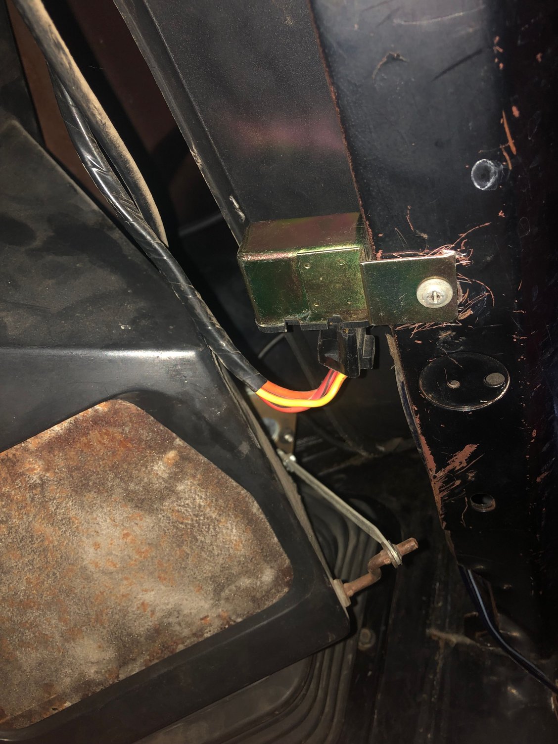

Thanks I found that thread during my searches but didn’t think it applied to 77 because the 76 diagram says the relay is under the hood center of the dash and 78 doesn’t have it where exactly is the relay it is not under my hood is it inside?

yes, it is under the dash inside the truck...should be somewhere near the center.

After looking more at the diagram I see that c-810 is your relay its tied into that with the r-Bk wire . I know Dlburch said to follow the yellow and red one but you could also try that red / bk one too . And its saying its in the middle of engine bay right behind the dash area. But take a look for that relay up under the dash on the lip next to where the wiper and headlight switch is at.

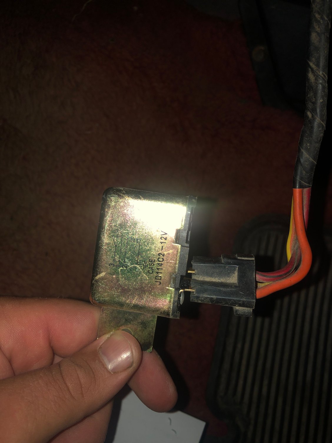

77 has a relay and idk where it is supposed to be but mine is directly under the glove box by the vent/recirc door

And before any testing it looks like terminal one got hot
