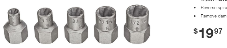

Knocking the bolt out will screw up the threads, if it's a threaded hole. If it has a nut on the back side, then yeah, a punch should be fine. Also I use bolt extractors. I've an old Mac set, but I'm sure they still make them.

yeap, home depot, lowes, autozone, oreillys, advance
