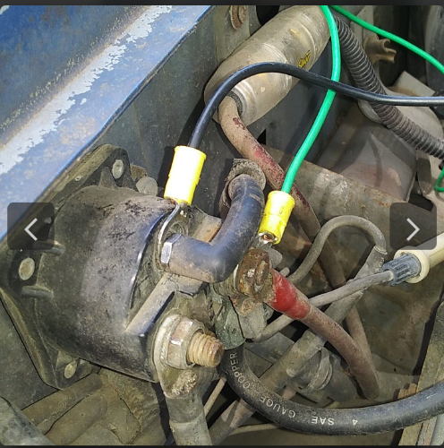

I cheated...
... And installed a push button start.
"Green wire is on the "hot" 12 volt terminal (with the wire that comes from the positive battery).
It goes through the firewall and to one side of the push button ignition switch.
The black wire is connected to the ignition terminal that activates the solenoid magnet. It runs with the green wire through the firewall to the other side of the ignition"
Green is hot and goes to the switch... Black returns from the switch to the starter activation pole of the starter relay (starter solenoid).
The key still needs to be in the run position to start.
I changed those large eyes on the wires to something more appropriate... This was just to make sure it worked.
Been two years... still working... and the key works too. The auto shifter was going too far past park and not engaging the neutral safety switch.
I posted about this on another forum the day I did it... June 10th 2020.
Had the same symptoms as the OP... and I thought linkage too. But this is my farm truck and a half hour workaround served my needs better than an all day column-dectomy.
Ymmv.
P.S. - it's kinda lost in there... But the button is a SSB5 from O'Reily's.
