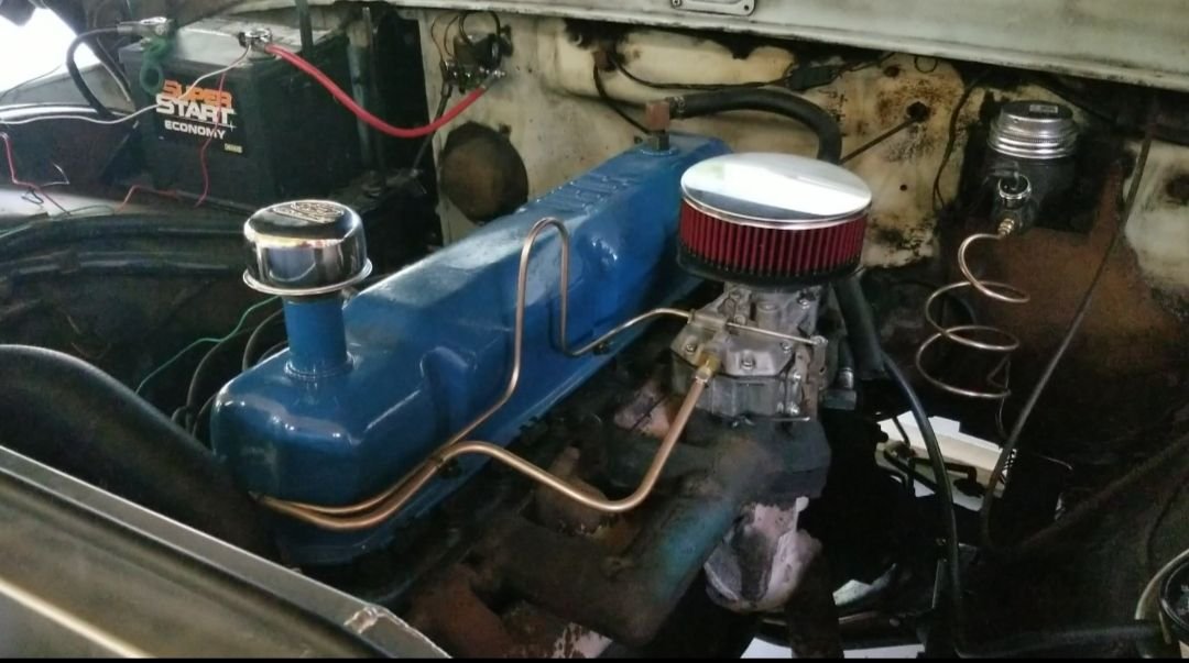

After tons of help from all you guys, I'm almost there with my 64. Shes made tons of progress since I got her, and has almost all new parts on it now. Still need to replace the clutch assembly, but shes atleast driveable around the yard. And need to get my brakes dialed in too, they're basically non existent now ha. Other than that, nothing else should (hopefully) need to be replaced/repaired for a while.
I started it for the first time in 30 years about 2 weeks ago, dialed in the carb the following week, and as of this week was able to drive it around the yard under her own power for the first time. Gave her a half quick bath today, and I was surprised how decent it cleaned up.

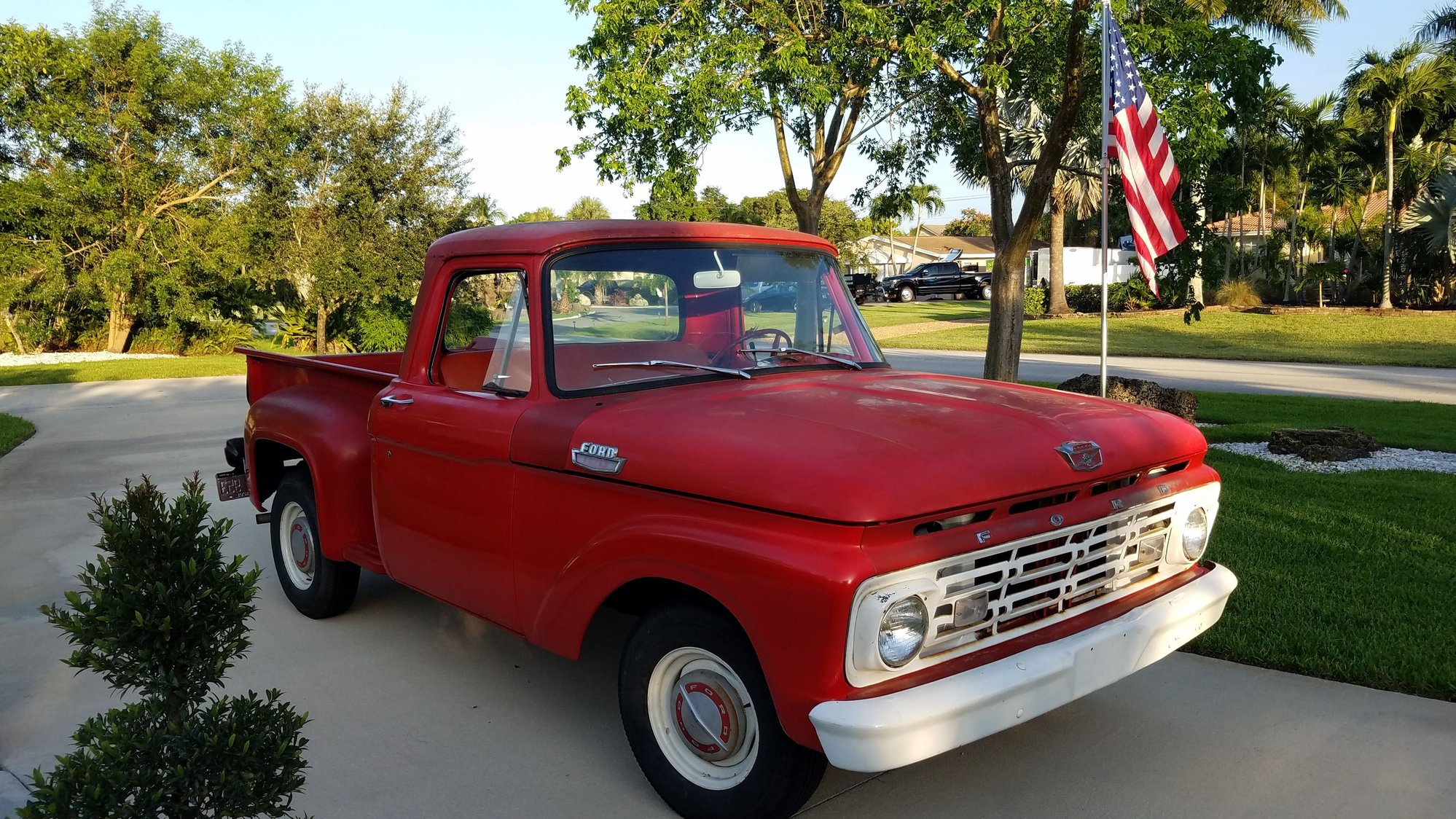

I have your '64 FL cousin...
I have your '64 FL cousin....mine, Gracie, has been a sweetie.. are you replacing or adjusting your clutch? Grace can't get into 1st...grinds.

Nice looking truck there! I really like the flaresides. I'll be replacing the clutch on mine. As far as I'm aware, the only external adjustments that can be made are to your clutch linkage, which would effect your free play in the pedal. Do you have more than 1.5" of free travel in the pedal? If so, you can adjust that and maybe that would then give you enough clutch movement to not have that issue.
I'll have to see if I can find the old thread, but I feel like I remember reading something recently where someone else was having 1st gear issues but I dont rememeber what their solution was. If I can find it, I'll post the link.
