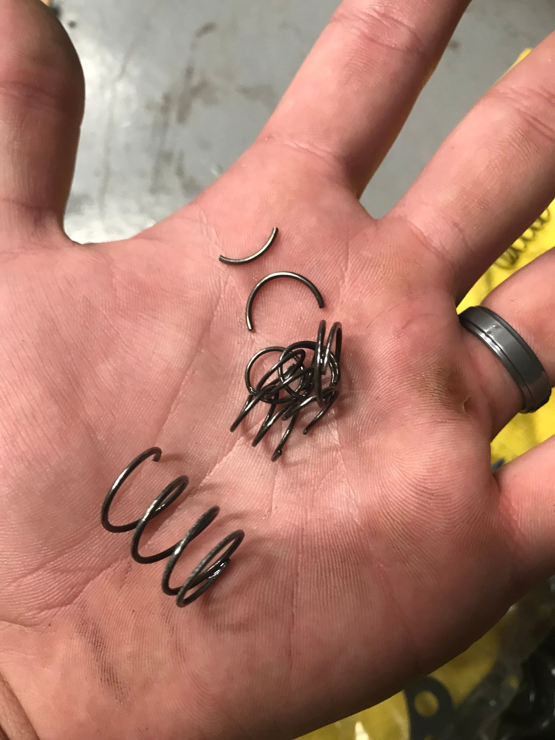

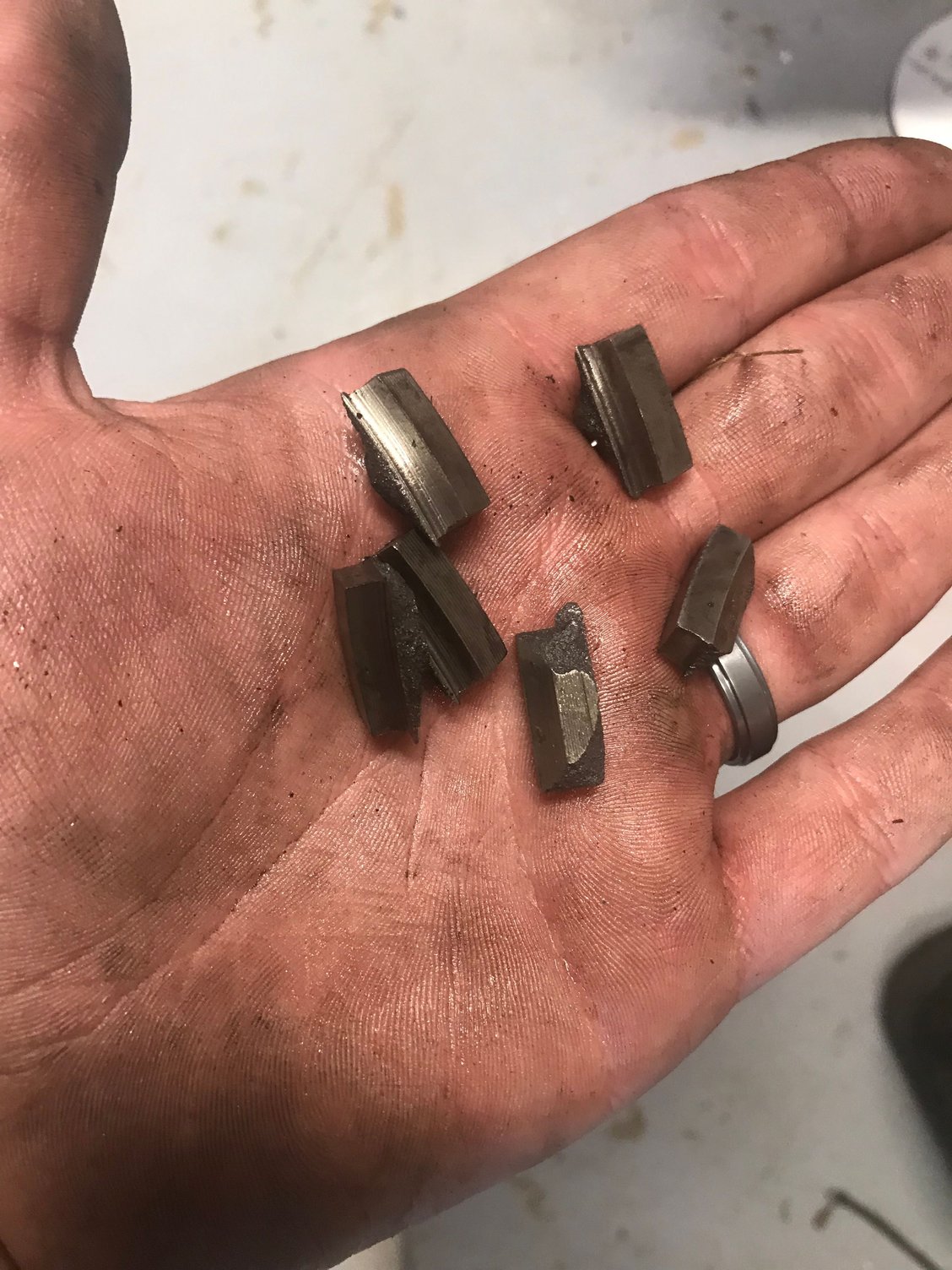

This is mostly due to my inexperience with automatic transmissions... I thought everything was lined back up and was torquing it down when the alignment tabs on the direct drum all broke off...
While installing a shift kit I noticed that the springs for the accumulator valve were all busted up. A piece of this spring made it all the way through the transmission and embedded into the servo piston.
This transmission, other than leaking a very small amount, seemed to be just fine before I pulled the engine out for a replacement... I guess a broken spring in the accumulator circuit can affect how hard/soft a shift takes place as this circuit exists to absorb and soften large spikes and drops in line pressure. Hopefully I understand that right.

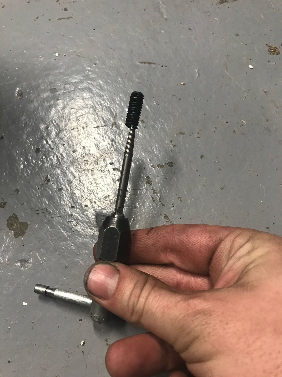

I also found info online to torque the pump bolts to 40 ft/lbs or so. Do not do this as I broke a bolt clean in half with that much torque......

Front pump to trans. case; 16-30 ft.-lbs. (1978 Ford truck shop manual).

Well if the transmission isn't already pulled, it's time to pull it. With all that metal inside the case, you're best to rebuild everything and start fresh. A small metal shaving such as a spring particle inside your C6 would wreak havoc.
