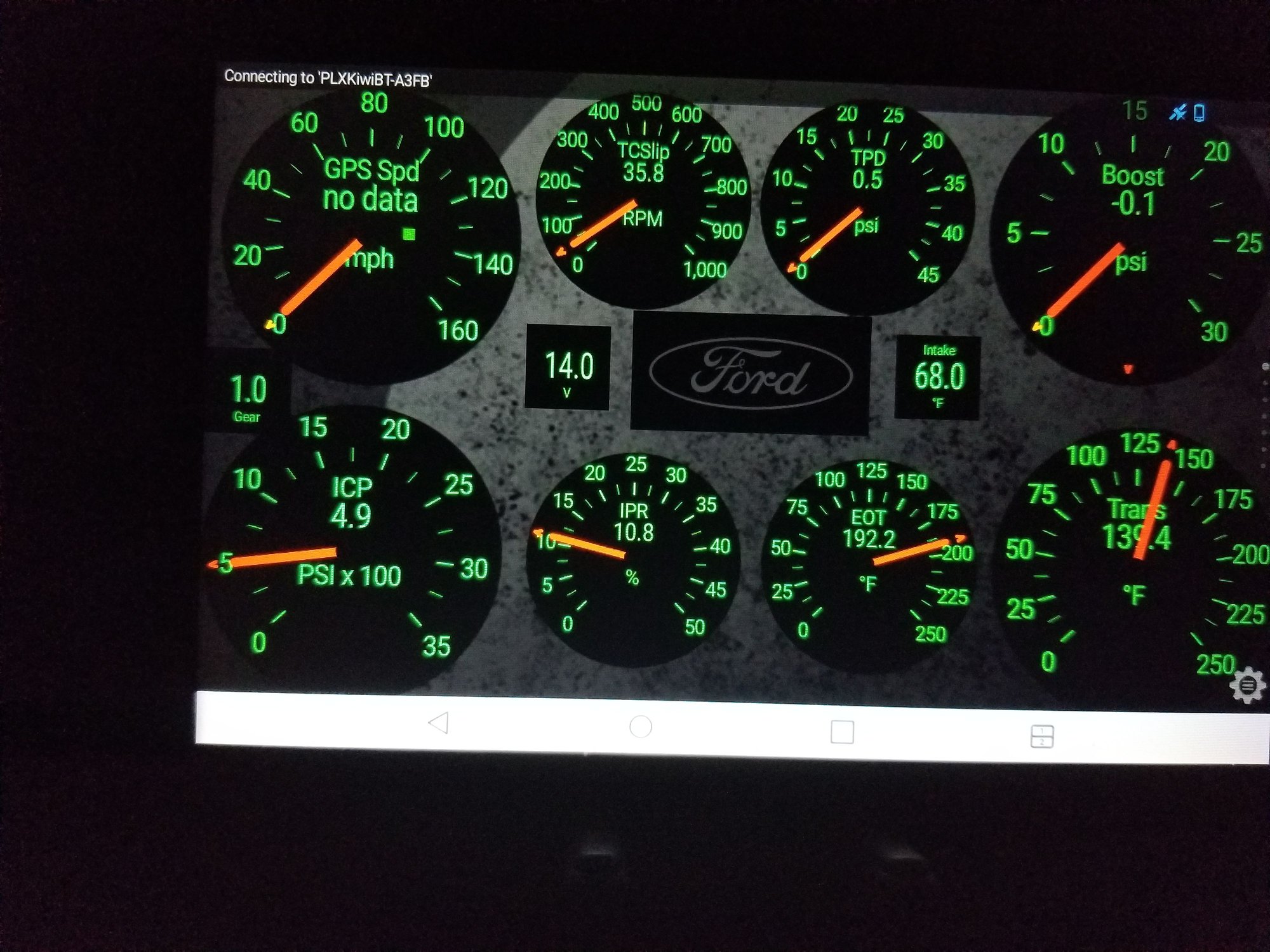

Anyone care to share what screen setup you run in torque pro? Also, are you able to monitor your trans temps on yours? I got the MX+ but it always reads 212F for mine even at cold start.

I use the Ford OEM-inspired theme and PIDs @Tugly created and shared with us a little way back when. Trans temp reads fine on one of the options. I don't remember which one it is ATM. Try a different one.

here it is

This might help: https://www.ford-trucks.com/forums/1...roke-pids.html
The ZF6 will not see transmission temp, but it will see engine coolant temp. Many of the PIDs have similar names, some are duds. You might need to find a different one similarly named, but no promises it will work correctly without tweaking the formula.

Ahh Ok, I wondered if it was because I have the ZF6. Thanks for that helpful link.
