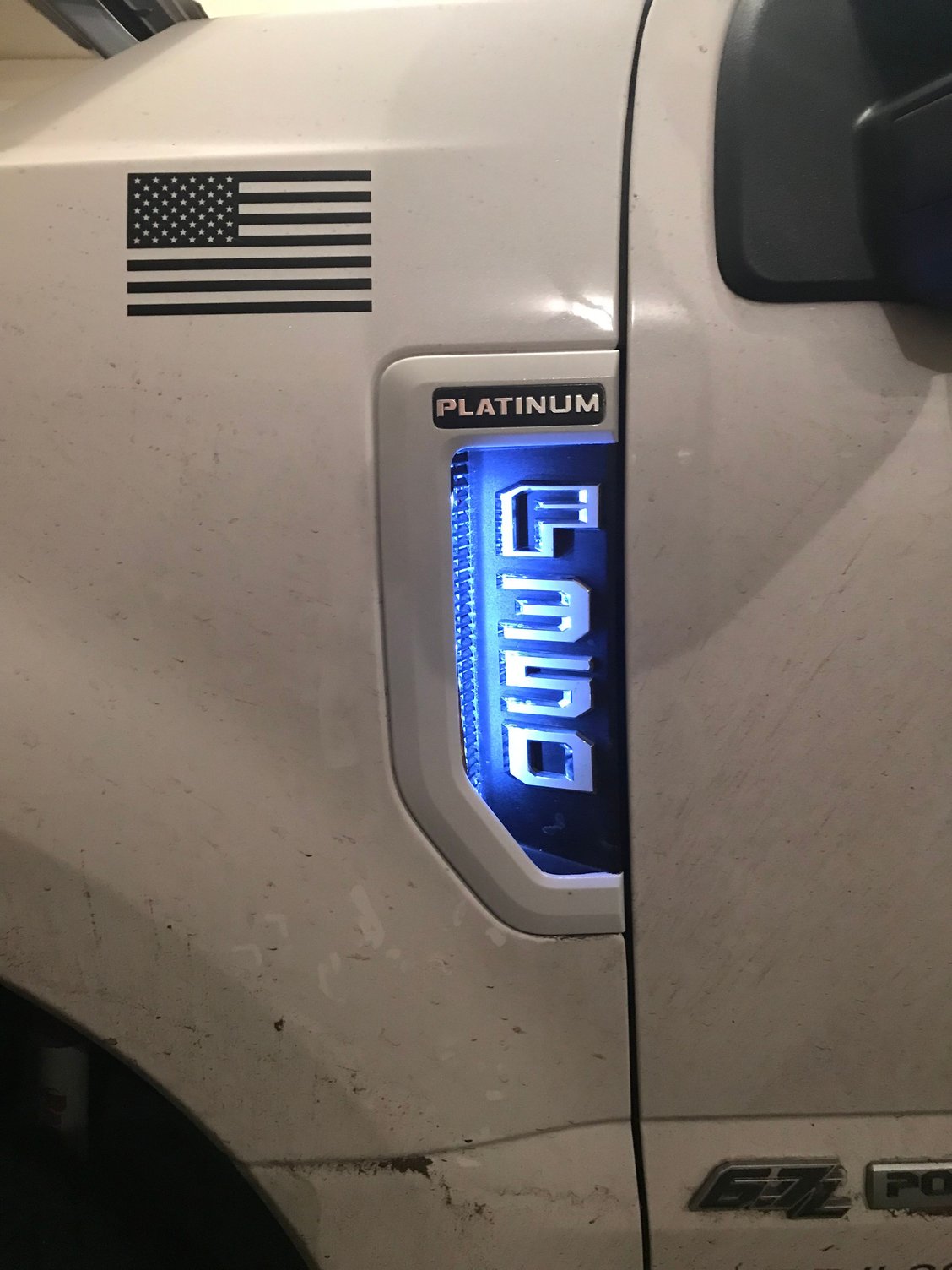

No I Didn’t take any before pictures unfortunately. I just bought tricolor factory white spray paint and LED light strips and wired direct. Had to drill a hole through the inside of the side badge recess behind the side badge to route the wires. The actual wiring and mounting took approximately an hour.

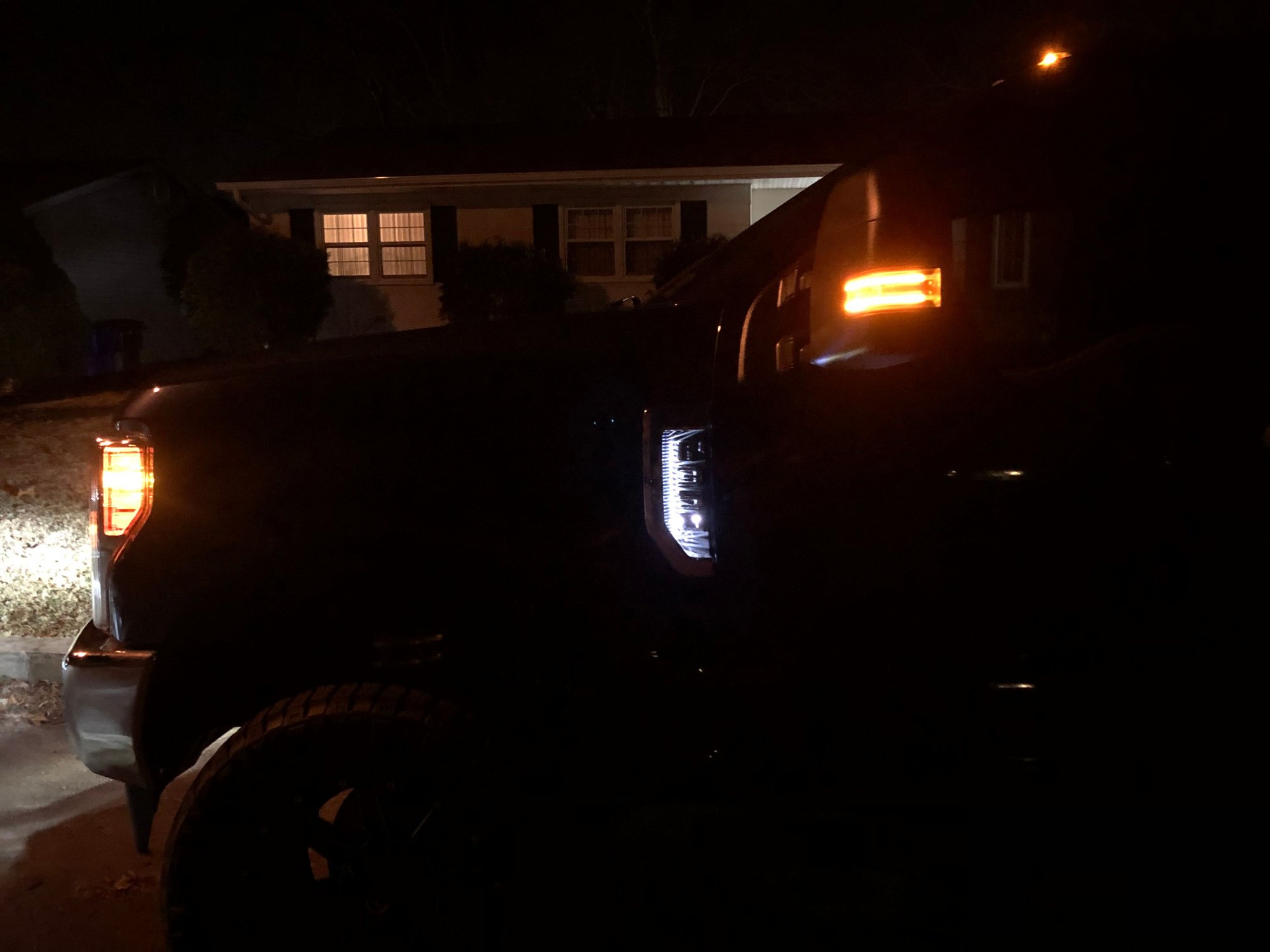

Wes. I used led strips and mounted them in the recess pocket. I did not wire them to an upfitter. I actually ran the power wire down either side of the truck and spliced them into their respective fog light power wire. Grounded them to both front fender ground points. I wanted them to come on and off like what a factory “running” light would.

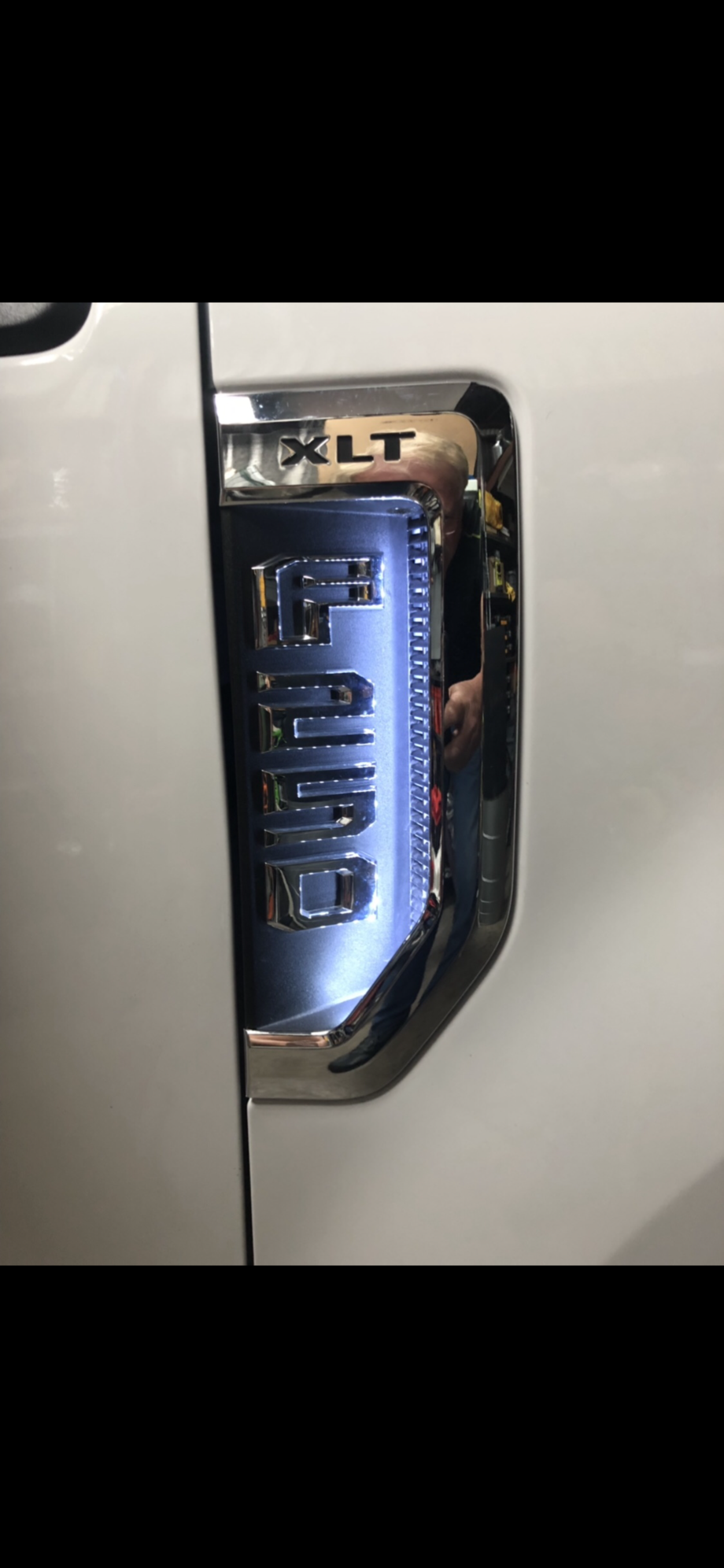

Got kit off Amazon...
