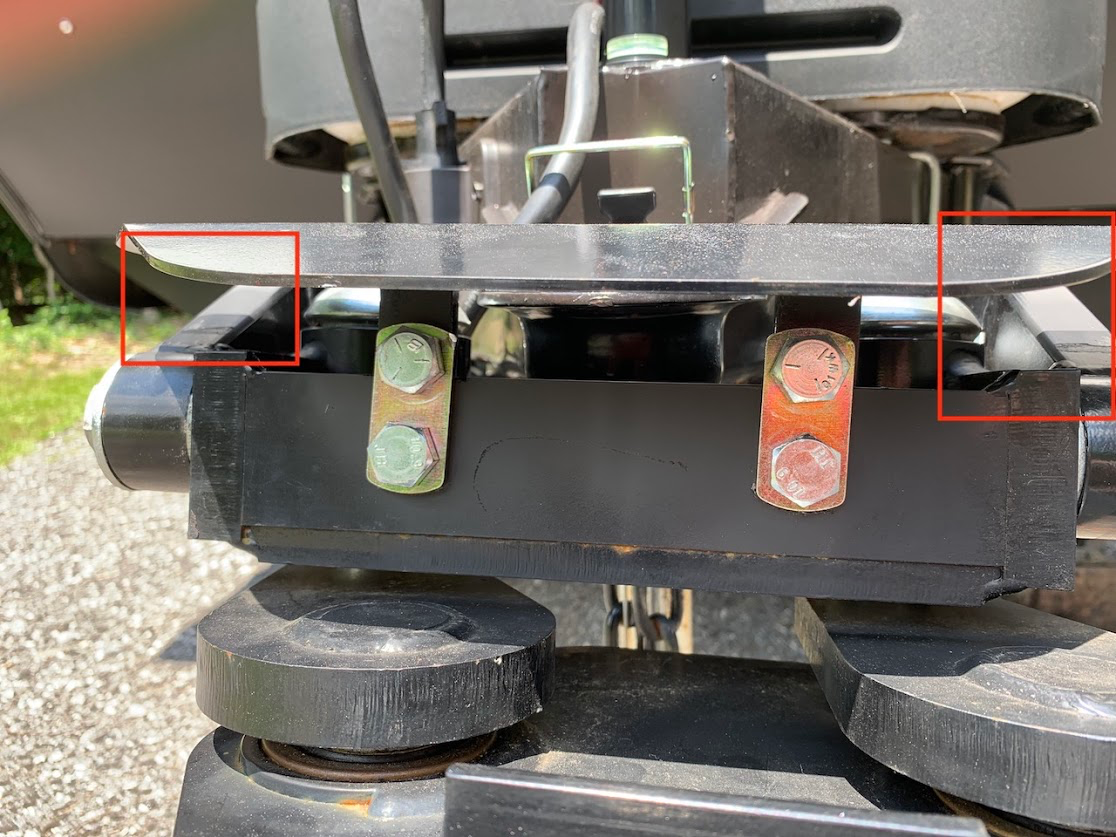

Well I took a longer look at it today and decided to take the hitch box cover off and see if that gave me more angular rotation and it certainly did, so I took a few pieces lying around the garage and used them to raise the cover by about 1 inch, now I have great clearance to the yoke so that the hitch box cover does not collide when trying to get a larger upward angle (front of hitchbox up, rear of hitchbox down) for hitching/unhitching.
Before:
After:
-Kevin
