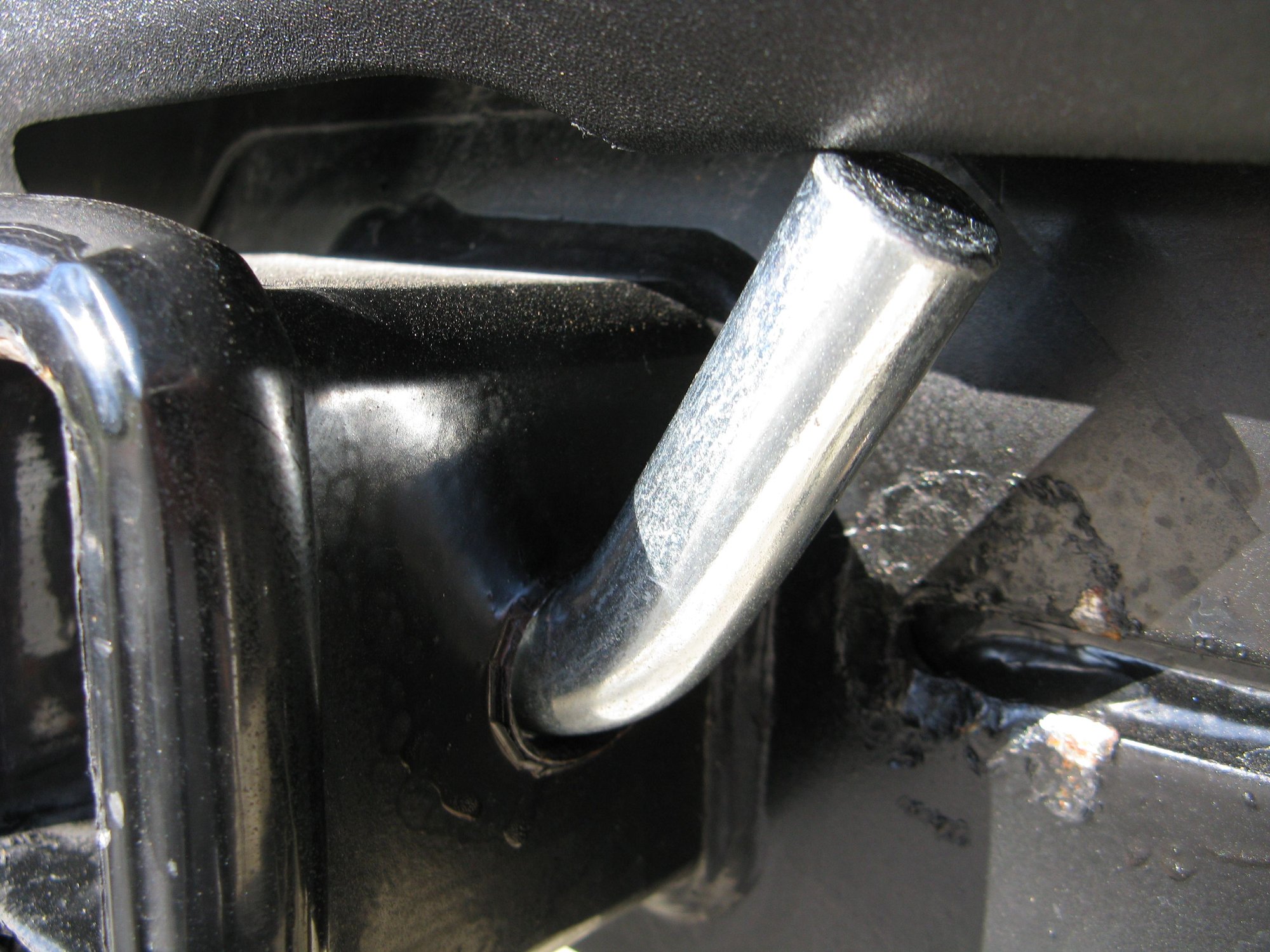

FWIW - Here is the result of using the Ford supplied 2 1/2" reducer with my 2" Equal-i-zer shank WDH, after 8,000 miles of towing. Finally replaced the 2" shank with a 2 1/2". There was no rattle with spring bars attached, but, as the hitch pin hole elongated, starts and stops resulted in loud "clunks" as the shank moved back and forth in the receiver.
I used my 3" to 2.5" to 2" reducers the first time I towed my toy hauler. At the time, I used a Blue Ox WDH with a 2" shank. My receiver hitch showed a similar elongating. After that tow, I switched to an Andersen WDH with a 3" shank. I've seen no further elongating of the pin hole.

I’d look into having someone weld the reducer to the drawbar if it’s wallowing out the pin hole like that.

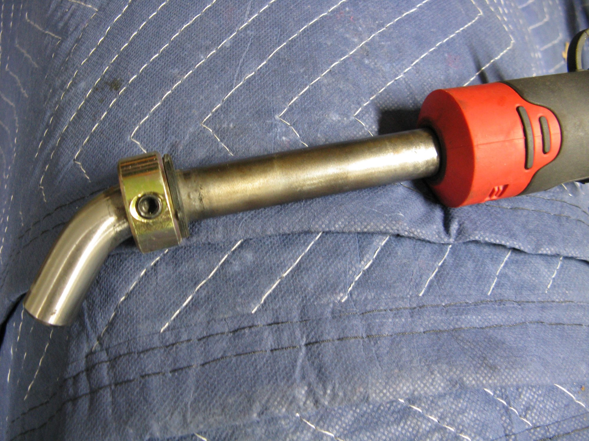

I also noticed that the bend in the hitch pin also matched the elongation and deformation of the pin hole in the receiver. So I added a collar to the pin to keep the bend away from the pin hole.
