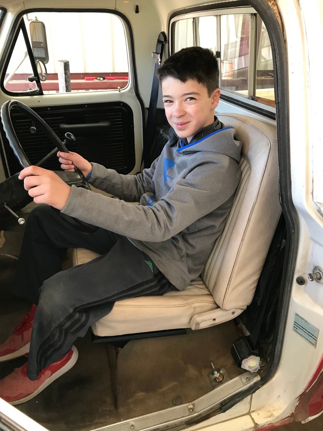

in my 71 the B-pilar wasn't threaded, just a rubber gasket. I ended up using my nephew with skinny arms to hold a washer and nut in place as we threaded the bolt through. once it was threaded he held the wrench and once it was tight enough I didn't need his arms. Got the should sections in and the floor wasn't bad at all, just a little tinkering to get them in place. In the picture below, you can see how the B-pilar sits on the passenger side and down on the floor. The lower portion is really close to the door, but there is no interference. Here is how it sits now after my nephew helped install the bucket seats.
Nephew after installing the bucket seats
Also, seats are from Seatbelts Plus. They were pretty quick on their end and came with all necessary hardware.
