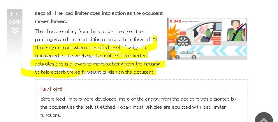

I think this is why your retractor has the note:

Load limiting
I think Ross gets points for nailing it. Whatever you use is going to be better than no seat belt at all.

It is all a matter if degrees. Over the years MVSS standards have changed as testing became more and more dramatic. Originally seat belts were designed to protect against the common frontal impact to prevent people from getting thrown through the windshield or from the car. Then testing changed to include rollover protection. Then as front airbags came in they were designed to complement each other. Then side impacts and side airbags came in.
Design-wise originally there were only lap belts. Then shoulder belts came in but you had to adjust them yourself. Most people didn't do it right so pre-tensioners were added to the lap and shoulder belts which kept the belts against the body and ready for action. Now, as Ross's documents show, they have moved to allowing the tensioned to give slightly on impact thereby absorbing some of the shock.
Designing seat belt systems is very intense and requires lots of simulated and real world testing. And every vehicle model is different. So when we look at the aftermarket-supplied seat belts they basically have one design that fits all. There is no way they can meet the current OEM crash requirements on every vehicle. The best that you can hope for is that they will keep you from going through the windshield and in the vehicle. Belts with pre-tensioners are best.
I'm not sure about the 2006 Explorer seats that you have but if the belts are built into the seat they would have pre-tensioners and probably post impact cushioning. So IMHO I would think that they would be better than what you can buy from the aftermarket. Of course you won't know for sure unless you do some very expensive crash testing.
Just make sure that your rear seat mounts are firmly anchored as they would have a lot of stress put on them in a crash. Several layers of large washers or a heavy plates would be in order.

Ross, Thank you for the links. If I am understanding them correctly, the belts won't work properly without all the electrical connections and airbags. The belt and seat base rail system on these seats are made by Takata. I'm posting some photos in my next post to show what I have.

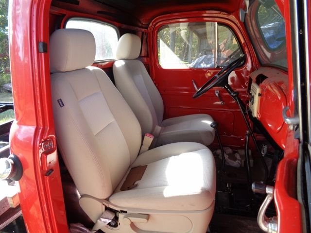

The seats setting in the cab blocked up to proper height. The drivers seat is six way power and the passenger is manual. I would have preferred manual for both.
The seat belt latch has a cable that goes into the tube with a spring to allow belts to give.
Note all the wiring and sensors.
When I remove the Takata base rails the bottom of the seat adjuster rail is flat, so it would be easy to build a seat base to fit.

Very nice seats! I think you should be able to defeat the cable system if you want to, or leave it. It sounds like the amount of "give" may not be substantial. Don't know how you can quantify it.
