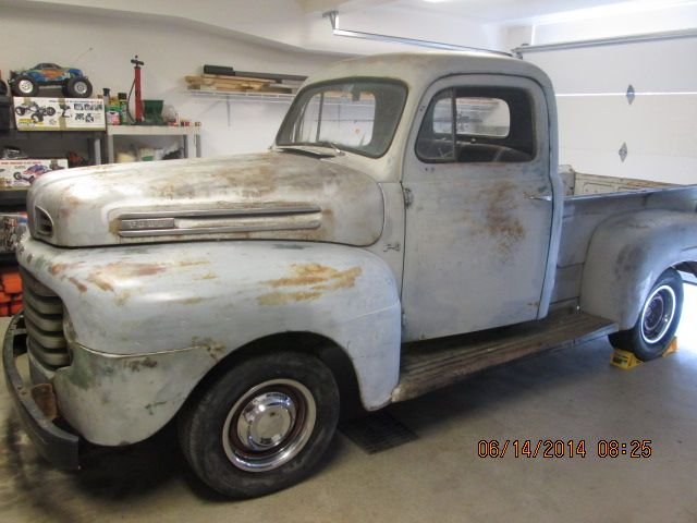

so I tore out the bench seat & spent most of today fitting the drivers side bucket.
The bench had come from a ford ranger I think - & it was held in with 2x6's and deck screws - it looked good (covered by carpet), but was far from safe.
So $40 worth of steel - 2x4 rectangle & all day fitting & measuring & using the level & I have the drivers seat pretty much done.
I took the gas tank out - gas tank for sale by the way (I have to fund this stuff some how) - and I have a lot more room. I was able to get the seat high enough and far enough back to be comfortable on my legs & still have a little bit of room to adjust the seat back.
The best part is it is securely BOLTED to the floor! Heavy steel, heavy bolts, heavy washers.
So - this whole mess started last fall when I bought a set of shoulder seat belts & when I went to install them I found the wood frame the seats were screwed to.
Where is the top attachment point? How do I bolt this in? what hardware should I be using? I want it to actually work as a seat belt not just look like a seat belt.

Not too long ago I saw a thread on seat belts. They welded some stout sheetmetal up in the corners of the cab for the shoulder belt. They did a pretty good job too. Not sure who they is but it was a good thread.

Mid Fifty sells the shoulder belt mounts that weld in.
1953-56 Ford F-100 Shoulder Belt Upper Mounts
Some have made their own. I bought them and had my buddy weld them in for me.

the strongest looking upper seat belt mount I have seen was in an article in classic truck magazine. They fabbed up a whole roll bar thing that was part of the seat mount and came up behind the head rest. looked pretty solid. On my truck I have the top part of the belt coming through the hole in my recaro type bucket seats. not the ideal fit but it works.

If you want to build your own this is what worked for me in my 48.

Mid Fifty sells a bolt in mount , I used it because I had already painted the cab .

I found the mid 50 mount - will be ordering next week. - Thanks guys!
I had the truck all done & drivable - so I had to tear it apart!
Now I just hope to get it back together befor parade season!
