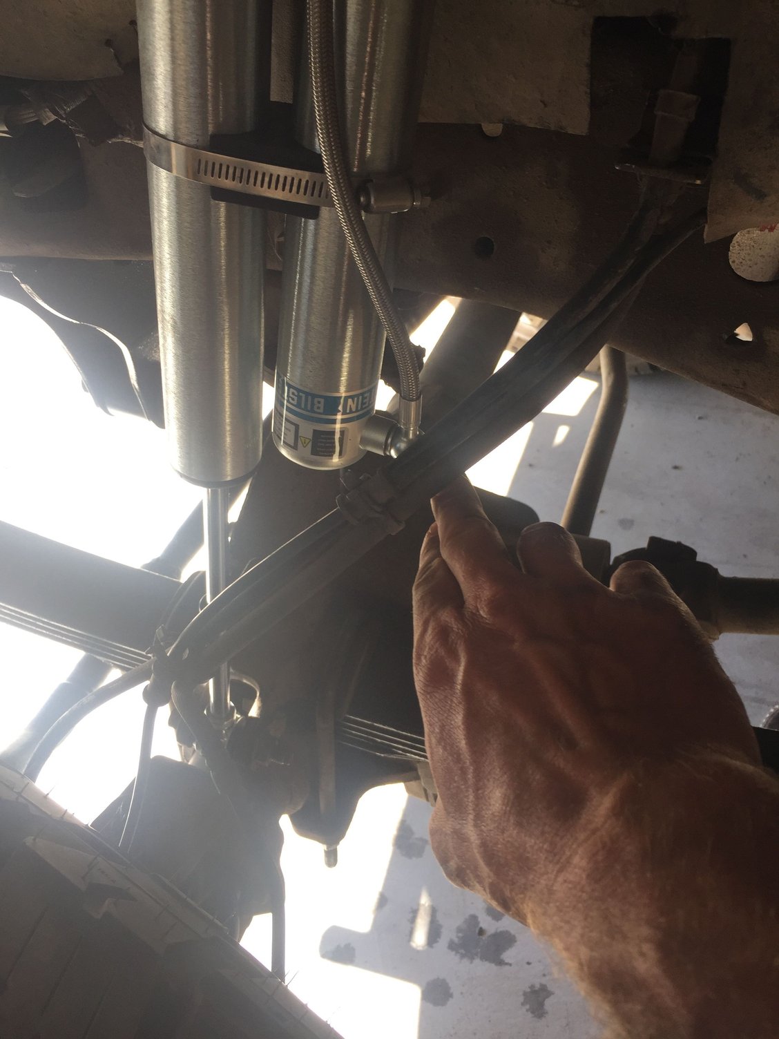

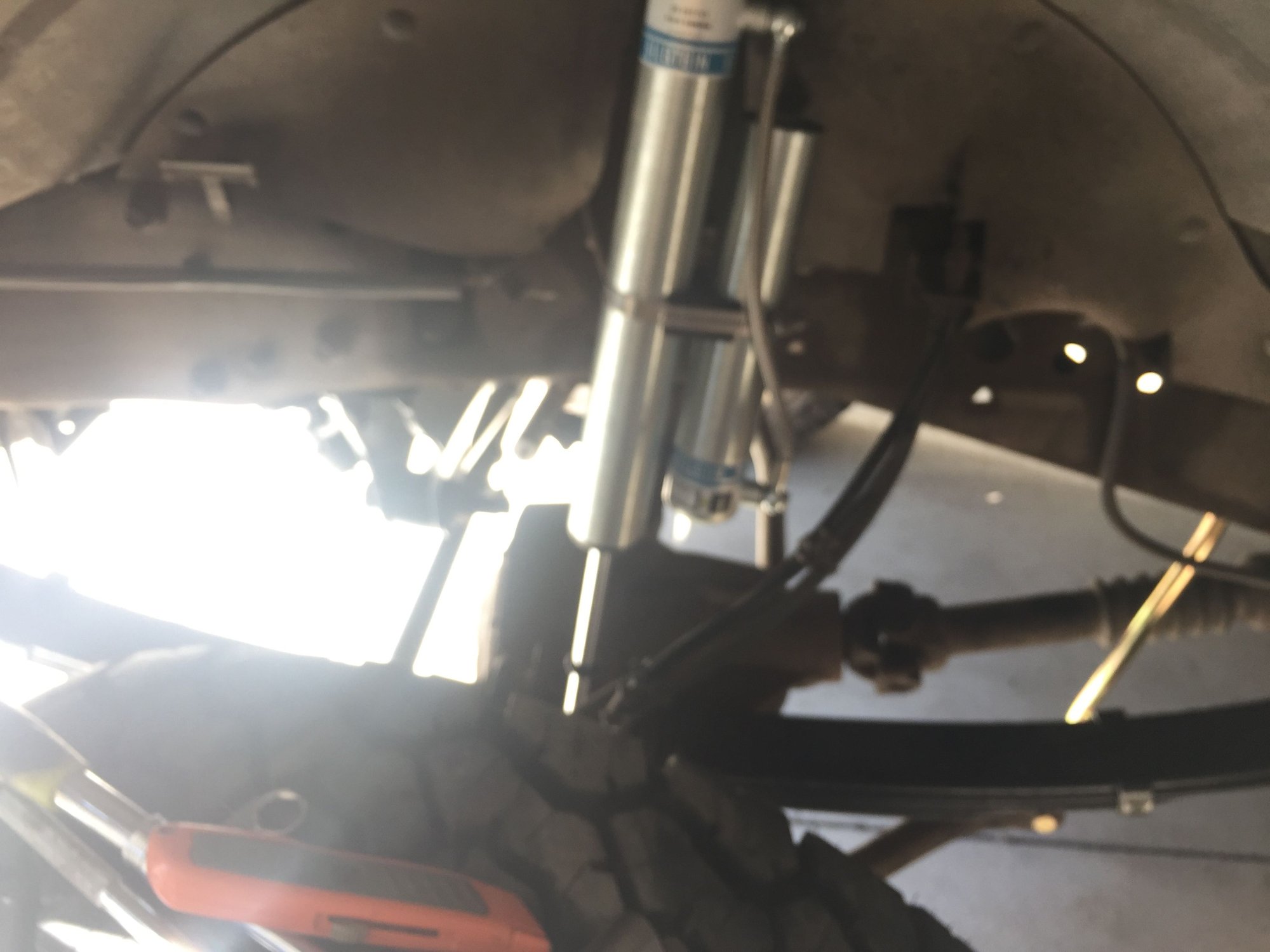

Shock at rest after install

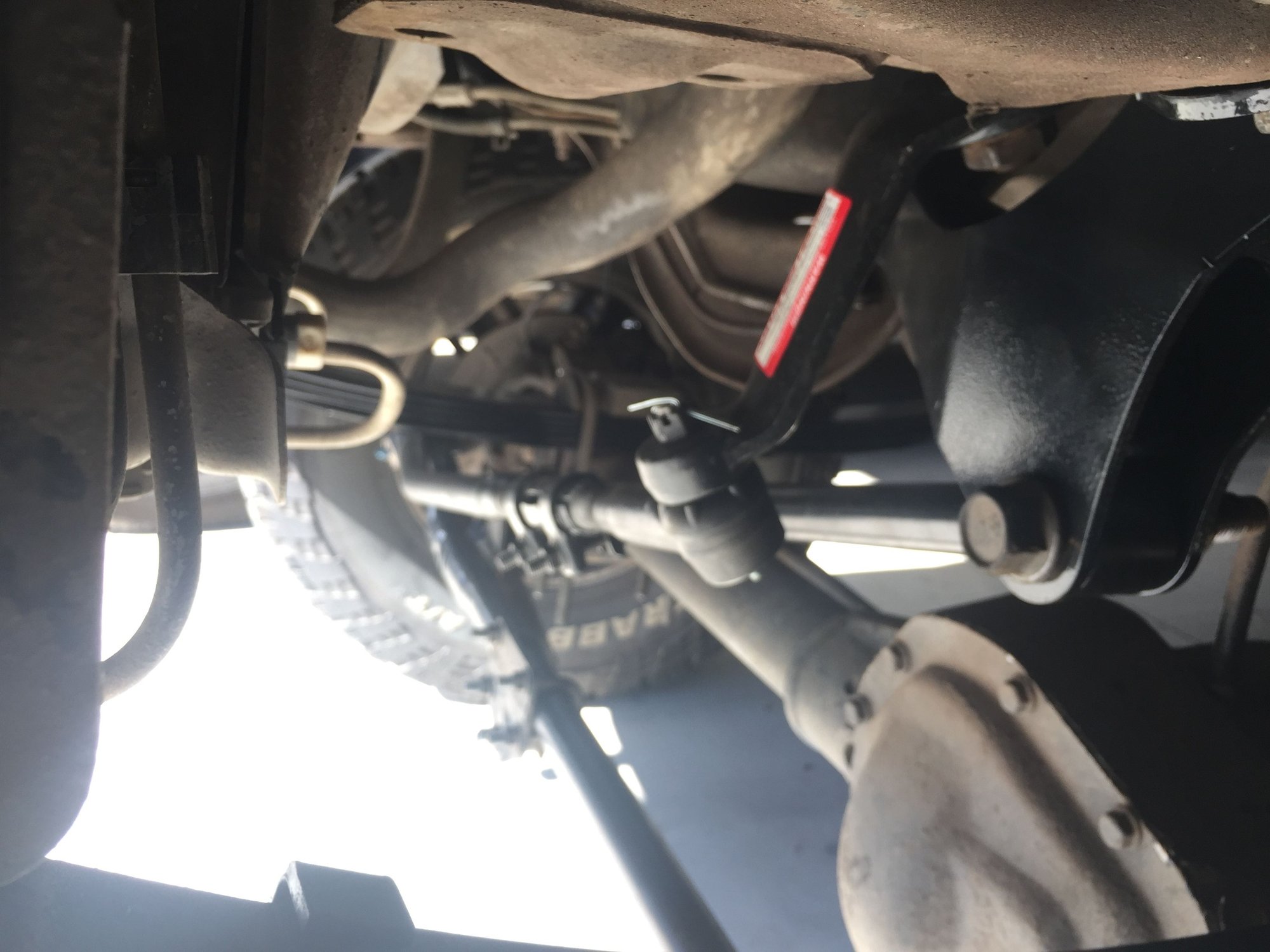

Pro comp drop trac bracket, drop pitman, adj trac
Lines at 33 1/2 extension
SO I installed the adj. trac bar/drop bracket from pro comp and now no interference from drop pitman, and took it for a drive w/o shocks in place out of curiosity, rode like a Cadillac although a little bouncy (obviously).
Came back and started install of the new bilstein 5165, straight forward as any shock just attaching the remote Rez to shock body. Learned from my last shock install instead of trying to compress shock to meet the top connecting bolt, I jacked the truck up to the banded shock, way easier. Then in the instructions it stated you need to fully cycle the shock to full extension which I proceeded to do and got the shock extended to a center of fender to center of hub to just over 33in before I did not want to go further due to the brake lines not having more reach. I don’t plan on crawling with my Excursion so don’t think I need more articulation, but it’s a consideration going forward.
I believe the reason for needing to fully cycle the shock is to simply check for interference with other components, any other reason to need to do that?

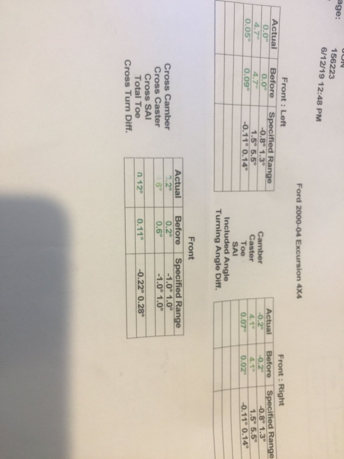

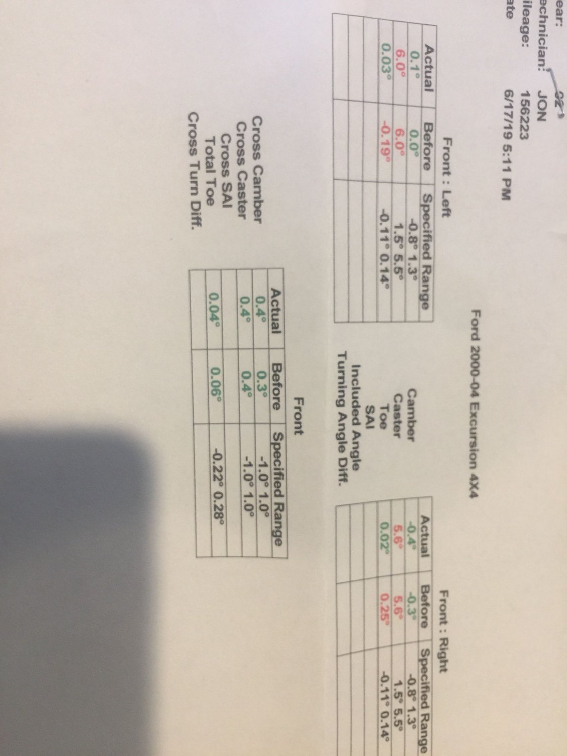

As an aside, here are the before and after alignment specs:

an inch "play" in the steering gear is not actually from worn out parts it is the amount of rotation from the torsion spring opening the valve that adjust the amount of power steering assist the box delivers.
biggest handeling diffrence you are likely feeling is you went from toe out ( causing wander and darting ) to a good setting on Toe In, that and they removed some caster.
and for the love of your children FIX your brake Lines. a turn at speed can cause the wheel to acheive full droop and over extend and bust a brake line. is your familys saftey not worth A hundred bucks ?

Copy that, yeah 2 new front brake lines would assure I have enough excess at full drop. However when I jacked up the truck to full extension of the shock, I still have 3-4 inches of lateral movement of the brake lines. The suspension should not articulate past full drop of the shock correct? The front brake lines were installed when the 4in lift was, might not be enough for 2 more inches in your humble opinion.
