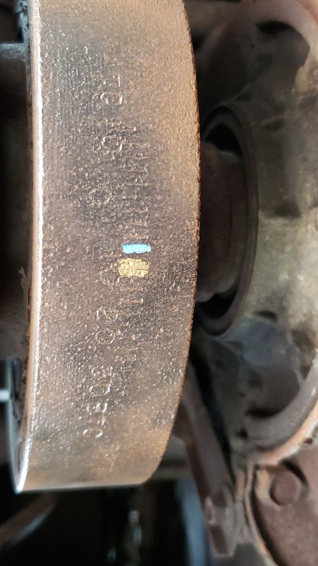

So I'm about to mess with the timing.
I drove about 30 miles today and I can't say for sure yet but I get the feeling that I'm getting substantially better mileage and other than the idle being super low, it's not stalling when I stopped at a light, as it was doing from time to time, before.
Adjusting the kickdown worked, and I feel like I have a considerable difference in power overall.
If I'm not mistaken, the blue Mark is where I should likely find the timing, and the bronze is the range that I want to shoot for?

Looks like the Blue is about 8 BTDC and the gold is about 10 BTDC. Either one of these are a good starting point, but nothing on your engine is factory now, you are on your own. Basically, the higher you can set the timing without pinging, the better power and fuel mileage you will get. That's the way the fuel injected engines work, the computer is constantly bumping up the timing till it hears something from the knock sensor, and then it backs it off. Then it bumps it up again till it hears from the knock sensor again. It keeps doing this over and over, constantly keeping the timing on the edge of detonation.
As you travel across the country on vacation, you may actually have to tweak the dist yourself on the road, if you get a poor batch of fuel somewhere.
