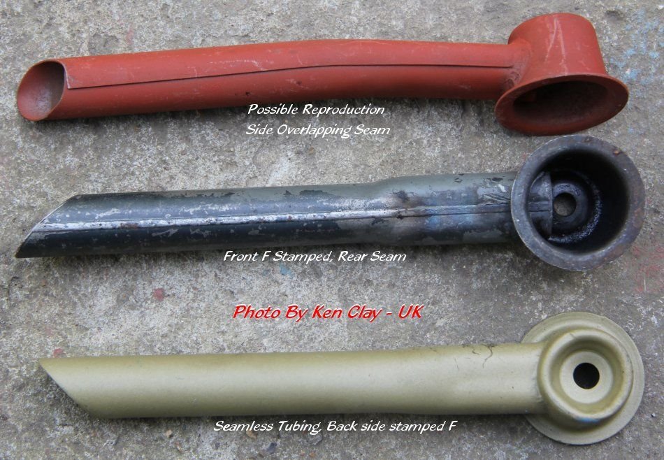

PCV
PCV The positive crankcase Ventilation system was introduced in 1961.
Prior to this combustion blow-by gasses that enter the crankcase were evacuated to the atmosphere via a road draft tube. The road draft tube ran from either the intake valley (V engines) or the side of the block (Inline engines) to underneath the car in a tube that was terminated in the air stream with 45 ish angle cut facing away from the front of the vehicle. See below pic of draft tubes from a WWII era Ford GPW Jeep, these below would be bolted to the side of the engine block with a passage to the crankcase. The angle cut on the tube induced a vacuum that pulled air from the crankcase while the vehicle was moving forward. Fresh air was fed to the crankcase via the oil fill cap that was vented and had a filter in it.
Those of us that are old enough can remember all the highways in the '60s and earlier had a black strip down the center of each lane from oil mist and droplets deposited on the tarmac from road draft tubes and the less than leak proof engine sealing. Prior to the road draft tubes, blow-by gases were just pushed out the oil fill cap.
With the addition of the PCV combustion blow-by gasses that enter the crankcase was positively evacuated from the crankcase to the intake and then burnt by the engine, instead of relying on vehicle movement to evacuate the crankcase to the atmosphere. The rate at which the crankcase was evacuated in a PCV system is metered either by a valve (PCV Valve) or a fixed orifice. The PCV valve regulates flow in proportion to intake vacuum when the vacuum is high it is more closed when the vacuum is low it is more open.
The PCV system was originally fed it's fresh air in the same manner as the road draft tube through the oil fill cap that housed a filter. Later it was moved to the air cleaner with its own filter in the air filter housing. In EFI systems the PCV fresh air feed was picked up after the engine air filter.
The vacuum to the crankcase for the PCV system has to be metered so as to not pull an excessive vacuum in the crankcase thus damaging seals and gaskets and speeding up the dispersion of oil across bearing surfaces. Some vacuum in the crankcase is a good thing as it does increase power output and will help mitigate oil leaks. It is an old racers trick actually that more few have used to boost power output and can add up to 20hp or more. Many salt flat racers pull a vacuum on the crankcase usually in the 15-25Hg range with engines special built to take these levels of vacuum.
Placement of the PCV is usually in a valve cover. But they can also be found in the intake valley and on the side of the crankcase.
When an engine gets high miles on it and the piston rings start to blow by excessively, this may overpower the capabilities of the PCV system. When that happens the PCV air inlet will show contamination of motor oil. This will also happen if the PCV valve becomes stuck or plugged.
The advantage of the PCV system is it helps prevent the formation sludge, prevents unburnt fuel from blow-by condensing into the oil, and helps evacuate moisture that cooks out of the oil helping to prevent internal corrosion.
Overall the PCV system is an always keep and many retrofit road draft systems to PCV systems.
I will do the EGR later on today.
Road Draft Tubes
