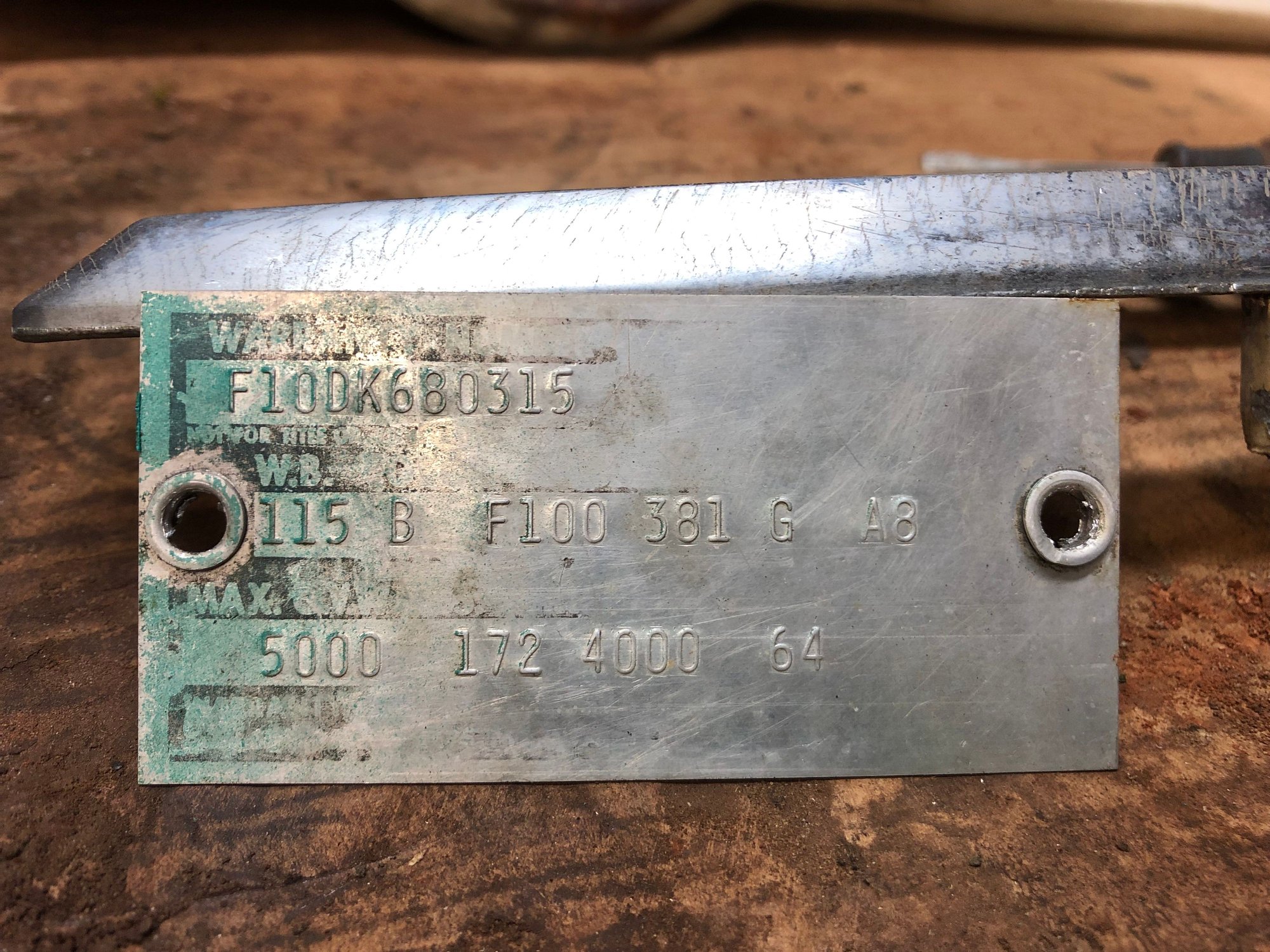

Could someone pls decode both of these .
Thanks

Originally Posted by Melofton
Warranty Number: F10DK680315 / WB: 115 / COLOR: B / MODEL: F100 / BODY: 381 / TRANS: G / AXLE: A8 / MAX GVW LBS: 5000 / CERT NET HP: 172 / RPM: 4000 / DSO: 64
F10 = F100 2WD
D = 352 2V
K = Kansas City MO Assembly Plant.
680315 = 1965.
115" Wheelbase.
B = Caribbean Turquoise.
F100 2WD, 5000 lbs. GVWR
381: 3 = Medium Green Crush Vinyl & Medium Green Wicker Pattern Vinyl / 81 = 81A Standard Cab.
G = MX Cruise-O-Matic.
A8 = Spicer/Dana 44 Rear Axle / 3.54-1 / Limited Slip / 3,300 lbs. Rear Axle Capacity.
5,000 lbs. Gross Vehicle Weight Rating.
172 net HP @ 4,000 RPM
64 = New Orleans LA Ford District Sales Office, where the original selling dealer ordered the truck from.
If you want the other Warranty Plate (no such thing as a VIN tag) decoded, you'll either have to post a pic of it or type the info.
