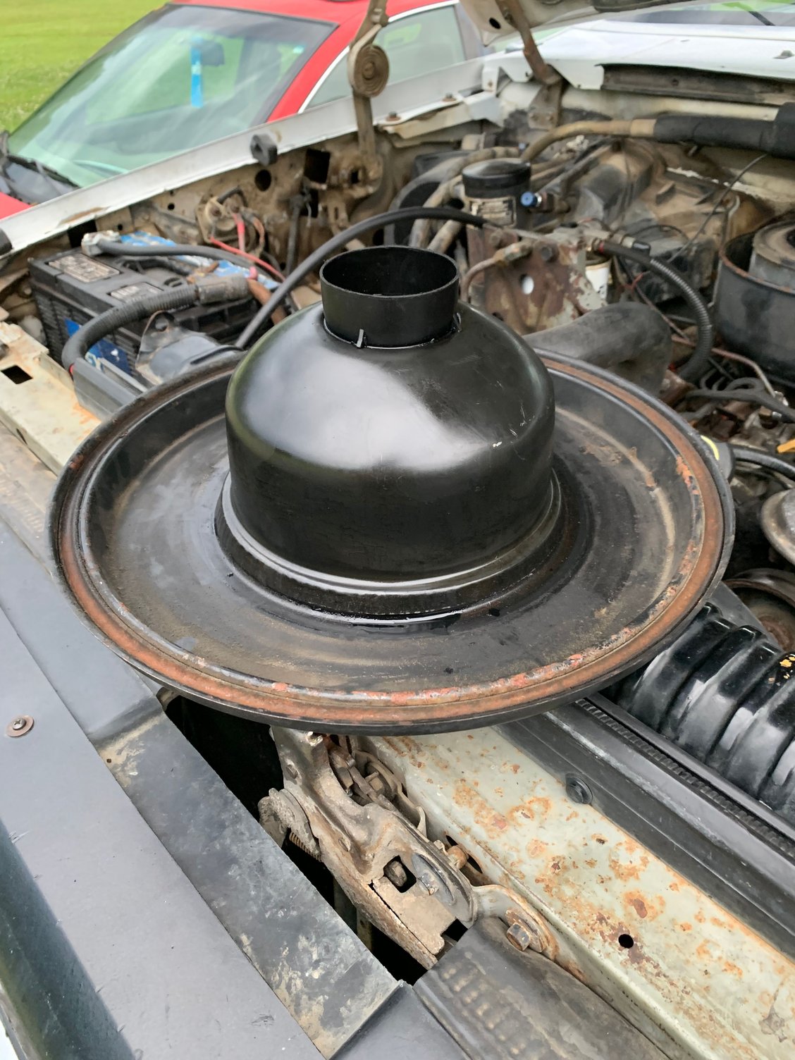

Soup bowl
Is there any gain in horsepower or fuel efficiency if I remove the soup bowl? It’s a 93 f350 7.3 idi 2wd

what is that extra piece on the soup bowl for ????
and I seriously doubt you can gain any extra horsepower by removing the soup bowl, but you can sure make it louder.....
think the OEM style is just to direct airflow in a uniform manner and you ain't getting more air into the engine if you remove it, the 93 has a Ram air scoop in the front to begin with too, and unless you change things with the amount of fuel injected I doubt you will gain any Horsepower. JMHO

From what I understand, it will probably lose a little power cutting it off, somehow disrupts velocity of the air and how it draws.
But do it if you want to, I think what it really does is quiet the injector noise from the intake, that's pretty much it.
But > that is a huge soup bowl..
Should run nearly silent > like a ninja.

my 93 don't have that extra piece of tube on it ??? must be an add on

If you can find a 6.9 lid it doesn't have that cone, it had a reducer in the bottom which I removed because its a choke point. Didn't notice any difference from before noise wise, which may be why they changed the design to yours

ya mine is just the bowl like on the old 82 6.9 with a few holes drilled if you wanted to add the ether package..... who knows mine may not be the original since I did buy the truck used .....

So, does this alien spaceship futuristic 'soup bowl' offer any airflow benefit over the 6.9 style? Enough to bother picking one up from the boneyard if I see one?

One thing I can say for sure is that an engineer designed that on the lid for a reason and Ford/International decided that it was worth the extra cost to include it in production. I doubt highly that it relates to any emission control, more likely an NVH concern, but that may be unlikely as well. The one tuck I had where that had been removed was noticeably louder with intake noise, especially once a valve got sticky. I'd just leave well enough alone TBH, and that tube tacked to the bottom is on my 1993 as well. It goes up to the cavity that the ether nozzle is in. I would imagine that the chamber as a resonator as I am sure you've heard the intake growl revving the engine with the air cleaner off.
