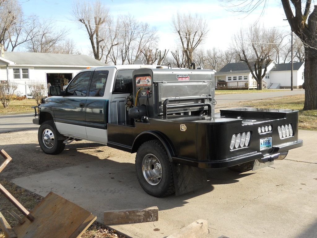

If I do this build, it's going to be this truck but dually
With a bed similar to this.
