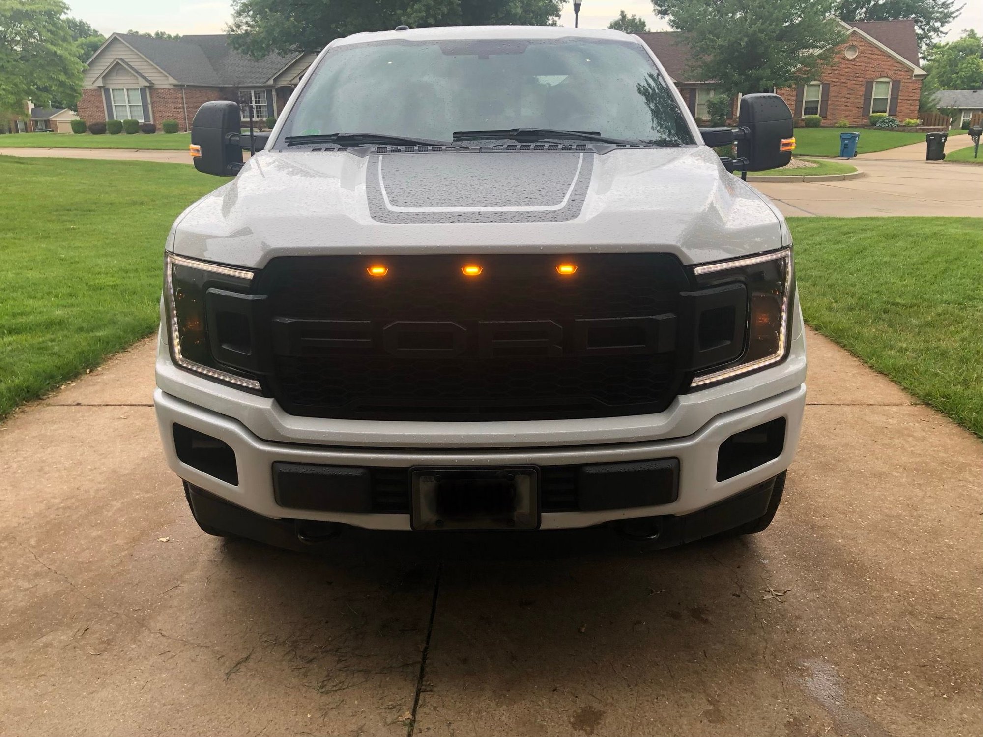

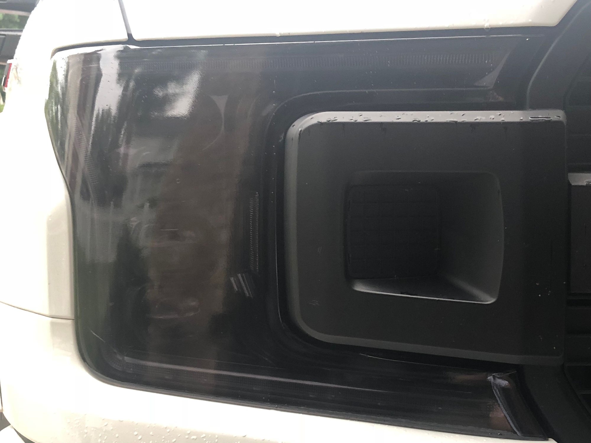

So Morimoto wasnt able to do anything for me except for offering me a 20% discount on a new headlight, but they are on national backorder, and I would end up on a wait list for up to 6 months. I used some of the windshield repair kits from autozone and then wrapped it in Air-Tint Smoke Black Gloss Vinyl Headlight Foglight Transparent Tint Wrap Self-Adhesive to prevent any moisture from coming inside the headlight.
it looks ok and the light output is affected only by 10%.
I prefer the original look but I may have to wait until they get the headlights in stock, which could be 1 year from now. I also did the fog lights... I was bored LOL
