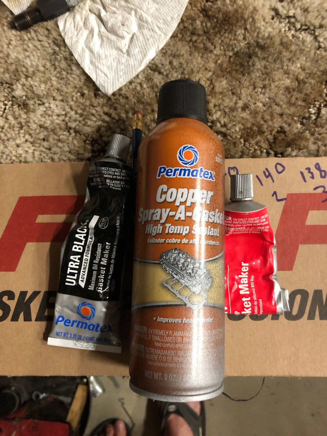

I think it depends on the engine and where on that engine some are notorious for leaking in particular places here some of what I use

Given the state of technology these days, in most cases, I do not even use gaskets any longer much less Permatex gasket sealer. That said, I DO use Permatex gasket maker, as schoo has pictured above, in the place of most paper/fiber gaskets. One of the selling points for Sanderson headers is that they do not require an exhaust gasket...we all know what a PITA it is to replace blown header gaskets. I called their product support person and asked just how to seal the header flange when installing the headers. They recommended using the Permatex Ultra Black to lay a bead around each port on the header flange. Next step, bolt the header in place on the engine but only finger tighten the bolts. After the Ultra Black has set up, I believe it was around an hour, torque the bolts down to spec. If RTV will hold out the pressure/heat of exhaust gases then I feel confident in it's ability to seal most other machined surfaces, good luck.

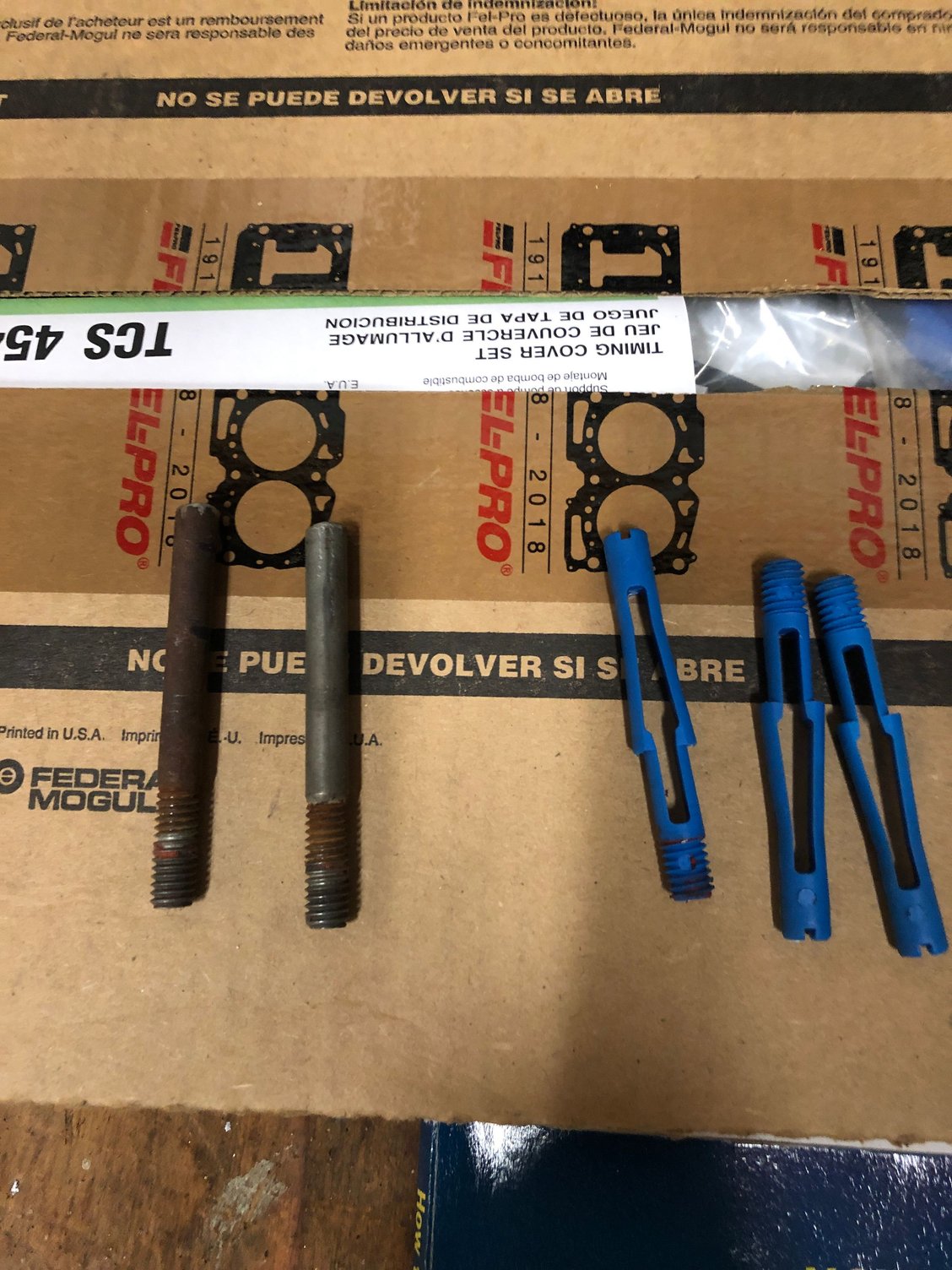

Also in many places it’s best use studs too locate the surface’s on the Rt studs that fel-pro gives for an oil pan gasket and Lt are my studs made for intake manifold
