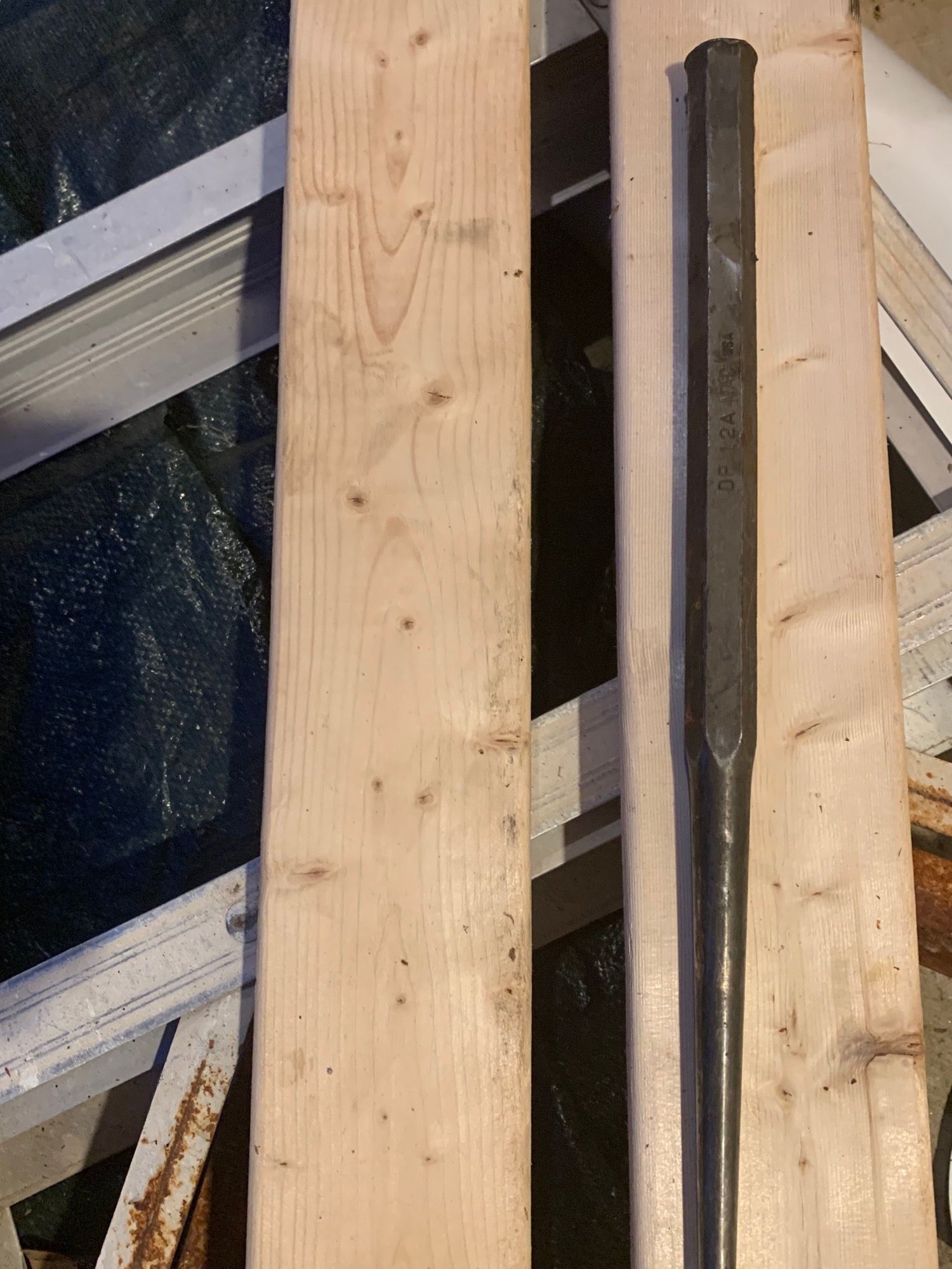

Unfortunately, I spent more time buying and returning breaker bars that were bending like spaghetti replacing mine. Once the 30 plus year old tools in 3/4 drive were acquired it was quick work. Ended up running a long extension to jack stand in front of the truck and pressed down with my foot to losen the bolts. Reinstall with the top bolt first and you’ll have more room to realign the lower. Below is the tool I used to get the bolt in.
