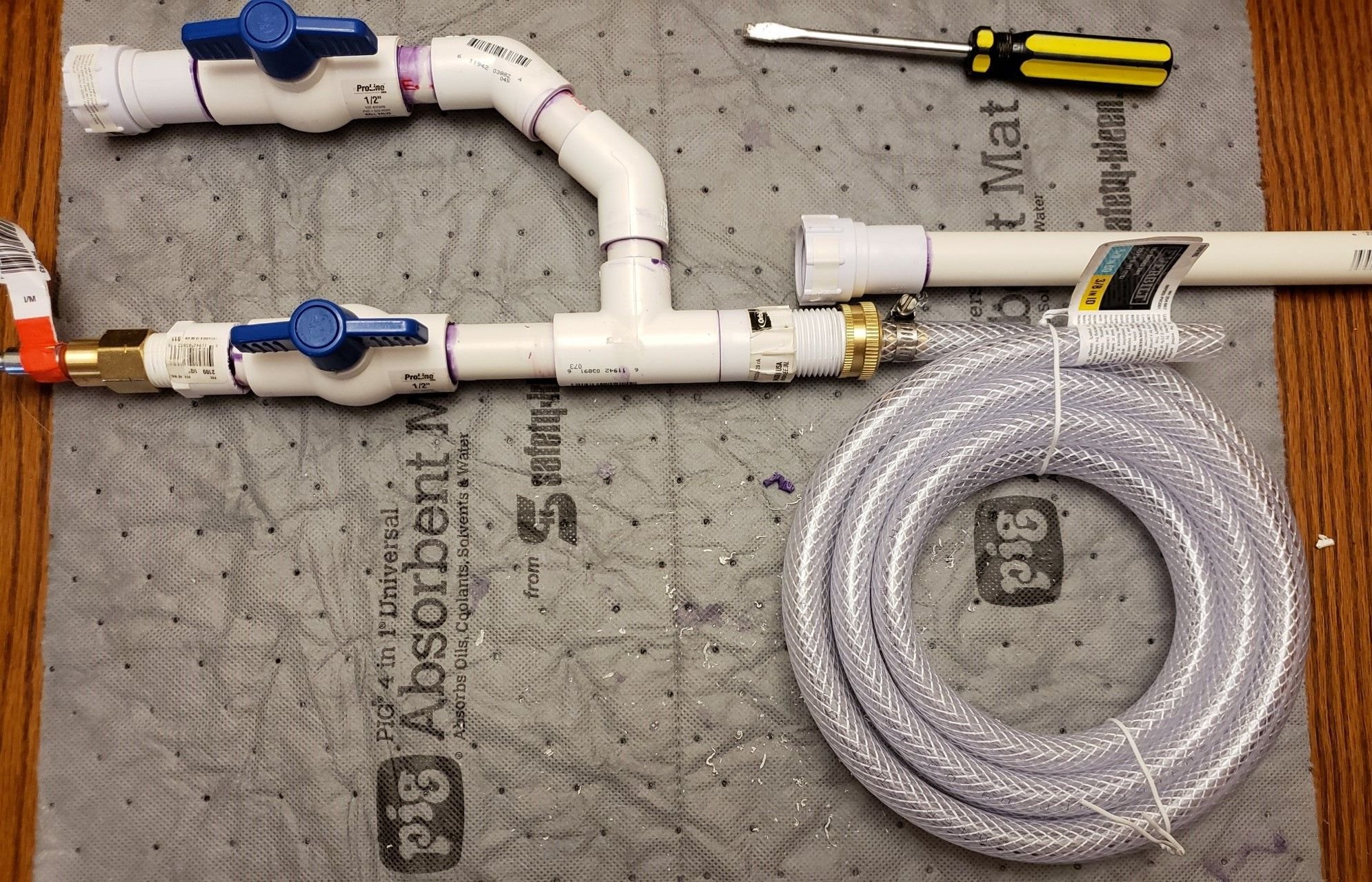

I have been watching you tube videos on backflushing the oil cooler and heater core , so I got a little bored and
decided to make a backflush valve/tool. so I give the backflush 2000 lol.

That’s something for sure! It should work fine, let us know or better yet make a video.

Nice work! If you can, pour some VC9 or CLR and get it into the heater core & let it sit for a day just to get some, if any, rust and debris out when ya flush it. When I did my entire system, I hit it with the VC9, then flushed it out per youtube DTRon. Then, I hit it again with CLR...and again with simple green. I know...TypeA but I did not want to do it twice

Well does it work?

it tested fine , I will be doing the flush in the next day or so

Do you have an option for injecting air?

yes , there is a 1/4" npt fitting on it

Some may know why I asked this and others may not.
Air injected helps remove crap when you add that to the fluid your using for the flush.

Looks like the bottom left fitting with the red tag.
