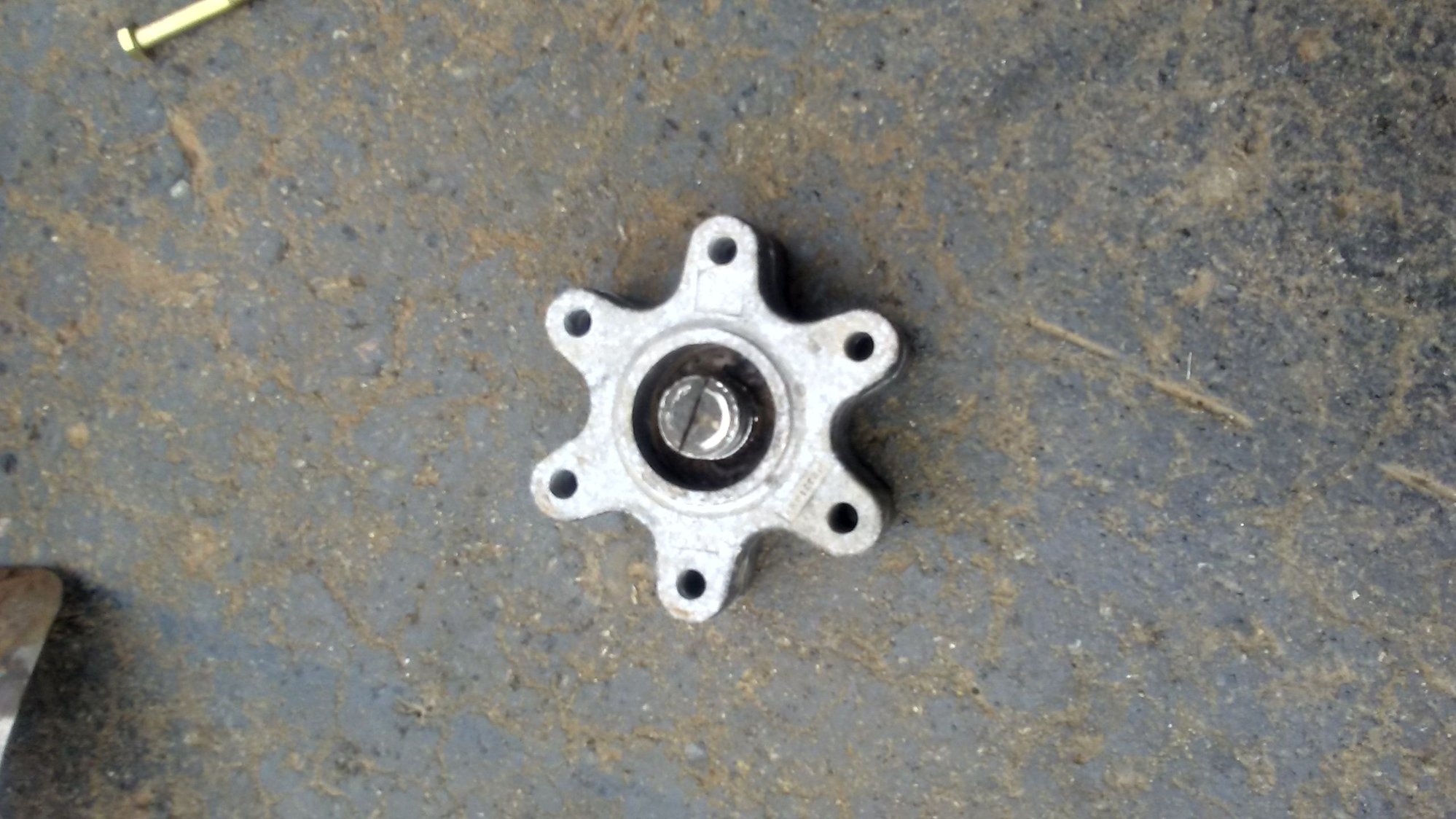

Finally got to deleting my clutch some prep work just fresh paint before install. One off adapter from stub off an old fan welded to adapter and one spacer. Spacer is for summer operation. Fan is reversable. Fan is bigger and blades longer. Fan is off an older hitachi excavator I believe.

why???
unless you are in the desert, you do not need the fan 90% of the time and running it constantly will only give you a power loss and a lot more noise.
i ran my 88 for close to a year with no fan at all when one of the blades broke.

It does make me happy. Main reason work truck unladen sorry issue. Unladen time is mostly winter. Summer spring and fall loaded 95% of the time. Now egts are in check can run wide open and egts stay about 1000 fahrenheit all day long. Water temps slowly start to climb. Thermostat operation confirmed by mechanical temp gauge. Radiator clean coolant full water pump is pumping. Clutch fan not working unable to get a working one. As far as winter for temp management fan is reversable by design. More noise dosnt bother me the power it will draw will be a bit more than a clutch fan stuck on.
