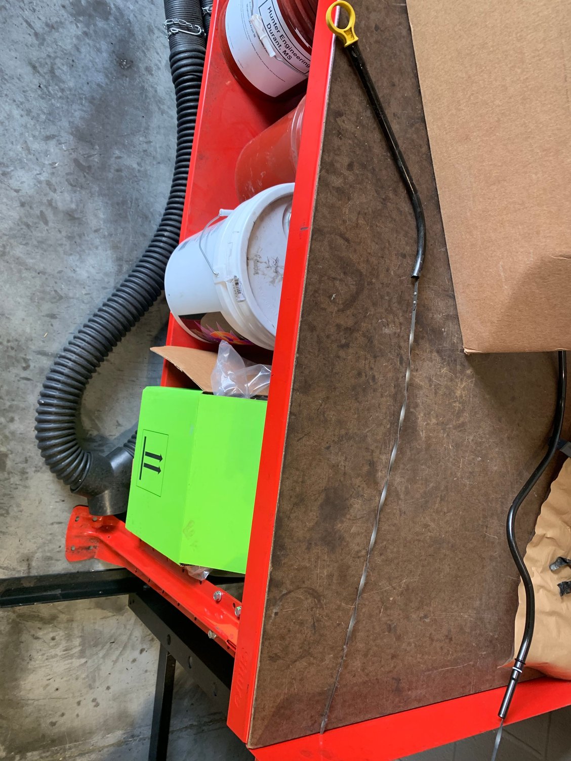

Okay, so my oil dipstick is broken. Wait, the tube is broken. Was trying to check out oil level and whole thing pretty much came off.
A little bit of tube on top attached to the top. And rest of the tube to the bottom was missing.
So, i had my technician at my shop work on it, supposedly, exhaust manifold has to come off? 2 out of 8 bolts came out but others are super rusty and seems like they are not coming off. How would I fix the problem or at least some temp fix so I don’t worry about debris going into the engine?

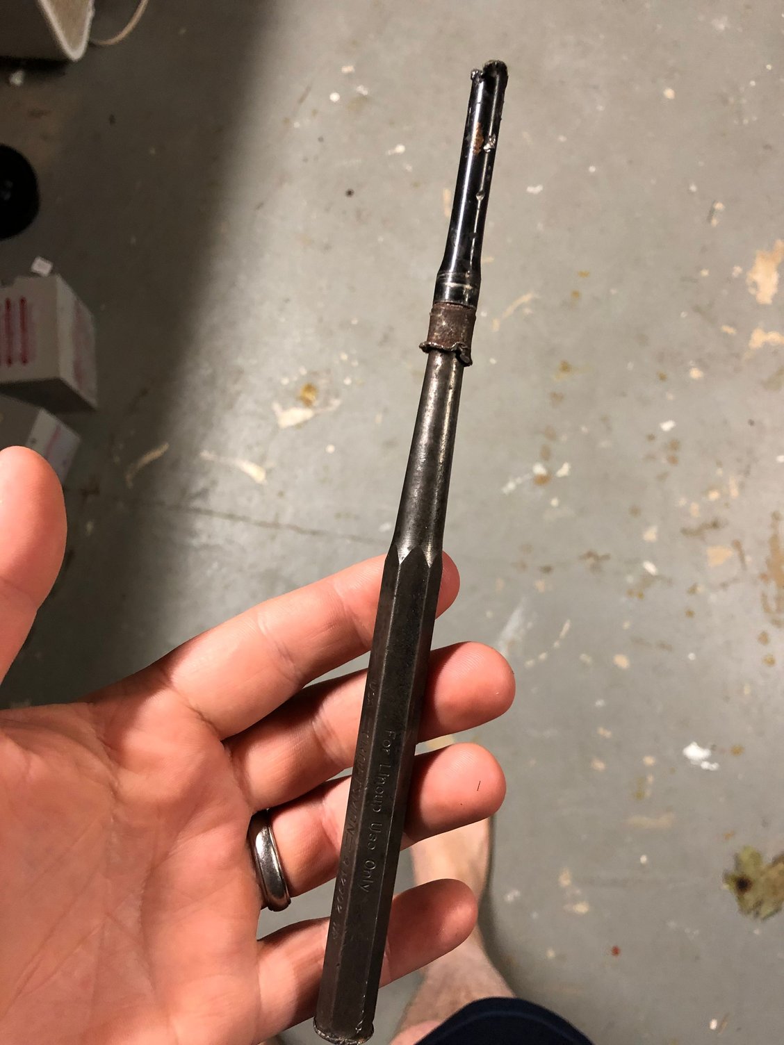

So I guess it’s a bit worse than I thought. The piece at block is rusted and won’t come out. This is what came off

ive had good luck taking a 12” long punch and driving the broken bit down a touch and then using a vice grip to twist and pull the busted bit out once it seized on the tapered punch shaft. The punch is long enough that the exhaust manifold doesn’t have to come off.
worst case scenario, the bit drops in and falls to the bottom of the oil pan where you leave it. It’s too big to get sucked into the oil pick up and too small to cause FOD to the rotating assembly if it ever kicks up off the bottom of the pan, which it won’t. If you’re gonna be paranoid about it, stick a couple rare earth magnets to the low point of the pan and the bit will live there forever
