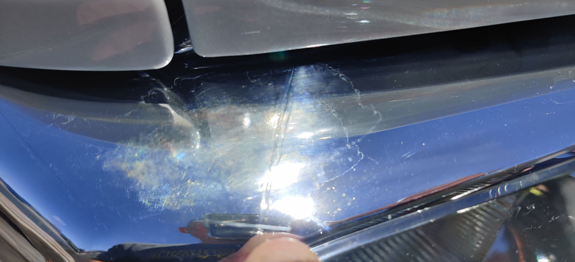

Headlight lenses that start looking crappy is one of my pet peeves. I just bought a 19 F350 w/LEDs, and am disappointed to read these posts.
Has anyone tried something like WeatherTech Lensgards, or similar? Any coatings that protect against UV?
My 04 Excursion HL's still look very decent.

My thoughts with installing PPF ( the lense protectors/clear films ) is their adherence. So they stick well, are clear and look good. But when they yellow, you'll have to remove them and reinstall. They glue gets hard and the PPF film is a bit tough to remove. What if you have a semi-faulty clear UV film on your headlight. Pulling the PPF film off MAY just end up catastrophic and peel large pieces of that UV film off the OEM headlight.

I'm finally at the dealership now for an oil change. Asked them to have my headlights pre-approved for warranty replacement, expecting a fight, and they approved it without issue. They will be here Tue. Haven't even swapped the Beamtechs out yet.

Finally got around to having the dealer inspect my headlights due to the peeling issue. Both headlights (halogen) had the coating peel on top and the top/corners. Thankfully still under warranty, Ford approved both and new headlights are on order!

My replacements were good to go in the known problem areas, but the inner portion of the "C" on one side, the coating was milky white and uncured so it easily came off with a fingernail, so I expect a new set of issues in the coming years. Hopefully lots of nice aftermarket options by then.

After approximately 3 months of waiting on a decision from Ford, they denied replacement of the LED headlight on my '19. Mine(1) looked very much like the others in this thread. Top corner, started out small, about dime size when I first noticed, now about a 2" area. The truck is still under the bumper to bumper warranty, and reading through this thread, and a thread on a Tremor forum, gave me hope that Ford would replace it without too much trouble. No such luck.
Like the OP, there was some back and forth with pictures, then more pictures. I was dealing directly with the service manager who sounded like he was on my side with it. It's pretty disappointing actually. I'm not aware of any avenues that I can take to push back either. I am considering talking with one other dealer in the area to see if they have seen this issue, and been able to successfully obtain warranty approval. Not really sure what else can be done.

From looking at the pictures it almost seems like some sort of chemical solution or contaminate ran down the hood and dripped onto the headlight fixture and caused the damage. Maybe from the inside?
Perhaps a good coat of wax or something on the fixtures as a preventative measure?

That's funny, because some sort of chemical is also Fords way of putting blame on the owner. It's funny you say wax too, in my case that is something that Ford used as a possible cause haha. What you are seeing in these pictures, and those found in other forums, is a premature failure of the clear coat. Or whatever UV coating is on them. I have another truck that is almost 20 years old with plastic housings, there is no peeling. Just discoloration. Hopefully your headlights don't start peeling early so you won't have to whine about it.
What I don't understand is, they have seen this happen before on various years and models. The same time in use, same exact concern, and have approved many of them. So is it just a matter of catching the wrong person on the wrong day....
