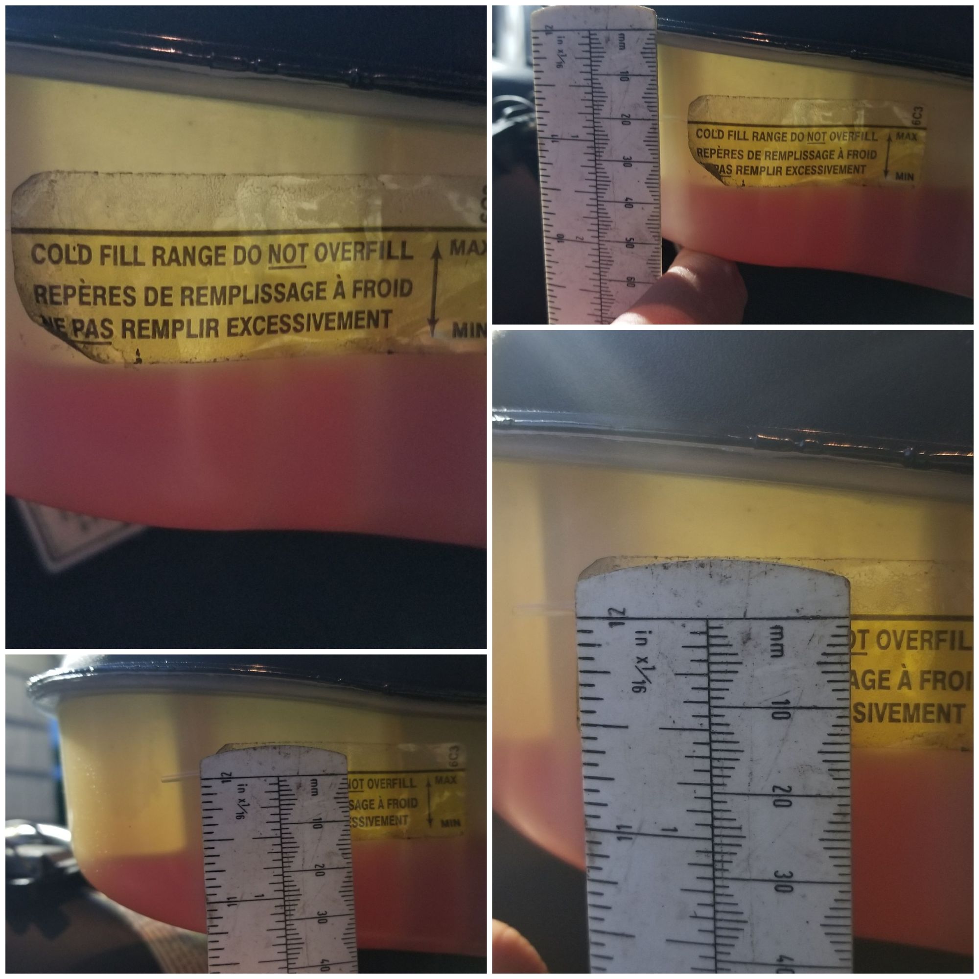

when i got my degas bottle last year, no marks of any kind on the new bottle, used an index card on the old marks and transferred to the new bottle.
original 2006 think they changed them since?
question
does anyone Know where the min and max marks are supposed to be how far from the top lip or bottom of the bottle?
i am assuming mine are lower below the minimum but have no way to confirm the min and max marks are correct
i see a lot about keeping coolant at the min marks but no mention of the distance?
thanks

Click on the "enlarge" word under the picture. Min (cold) is at the lower edge of the yellow sticker and max is at the upper edge.

more warm then cold recently driven
view from the front

That is pretty close to correct, JMO at least, from what I have seen on others.

My bottle has only one mark on it, fairly low down. I set the level just below it and not had a problem.

no marks of any kind those black marker lines are my best guess
Been working so i guess i got it close enough
thanks everyone

There is a vertical internal rib that you can see the shadow of from the side of the reservoir near the cap. Along this rib, from the top/bottom seam down there should be a molded indicator mark at approximately 20mm or 3/4"ish. This mark is the HOT MAX FILL level with coolant cap removed.
From the HOT MAX FILL mark, down about 15mm or about 5/8" is the COLD FILL level.
Hope this helps.

enlarging my original photo don't see any mold recess
but i will take another close up :>)
can you estimate how far the max line is from the bottom lip of the black part? (white portion)
then we have some kind of a margin :>)
waiting on sunshine before i crawl around the F250
thanks again

Yes, I did that in the post above and the 2nd pic in the collage shows it. It is 20mm or a little over 3/4".
