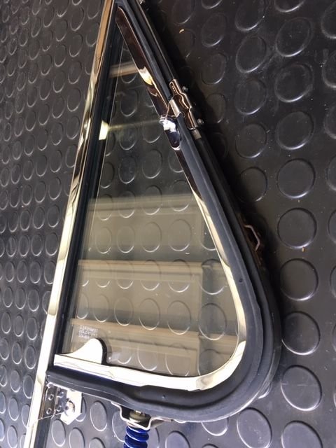

Here's the vent re-plated, re-riveted (took 5/32" rivets - tough to find!), and re-assembled along with some new hardware, misc. from LMC. I used this video as an installation reference
. Despite what I found the debate to be on the forum, I did not have to re-rivet my vent gasket and did not use any silicone. They lock in pretty darn well on their own. Everything re-installed relatively easy with the exception of the part where the threads down into the channel (see where the blue spring currently is). The plating company chromed this extrusion which made fitting difficult. Nothing a bench grinder couldn't fix!

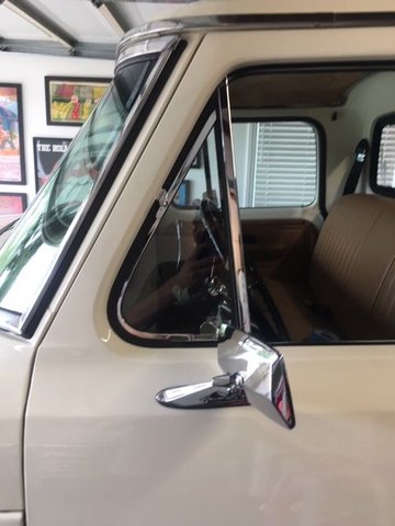

Before...
And finally After!
