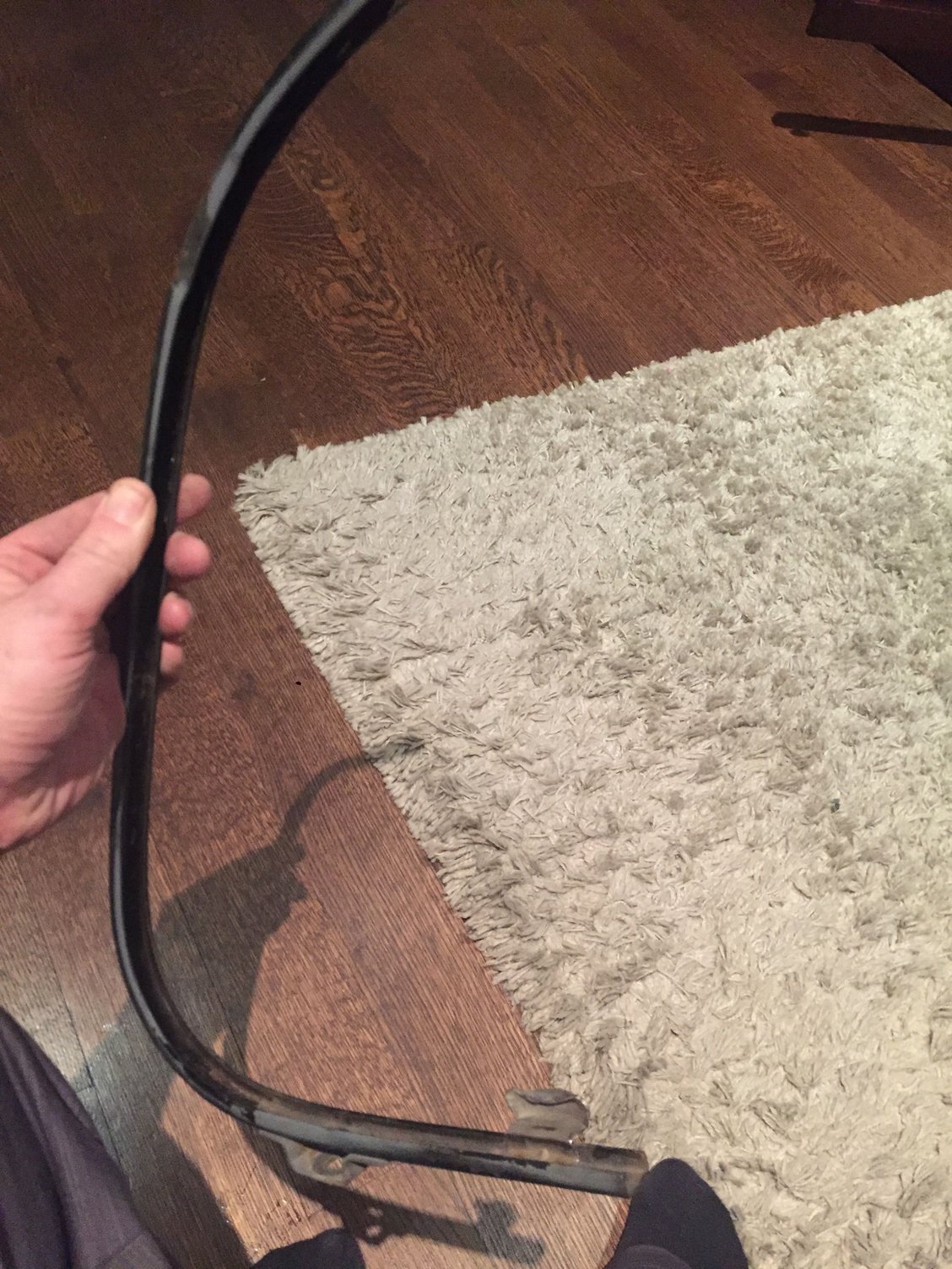

Here come the Newbie questions
can someone please let me know how do I remove the trim from from vent glass. And anyone have any easy tips on how to install the new gasket around the housing ..

A heat gun will help. It looks like the glass has some delam already so I assume that you are going to replace it? If so you won't need to be careful about the heat.

A lot of scraping with a screwdriver seemed to be the best way for me to get the old remnants of the gasket away. I secured this glass using Sikaflex which was the easiest solution but then the rubber between this and the outer bracket (which fits into the body panels) was relatively easy to fit.
