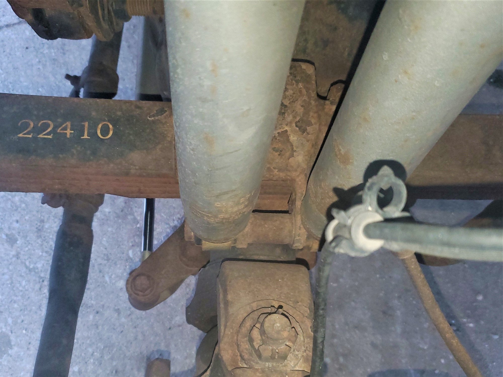

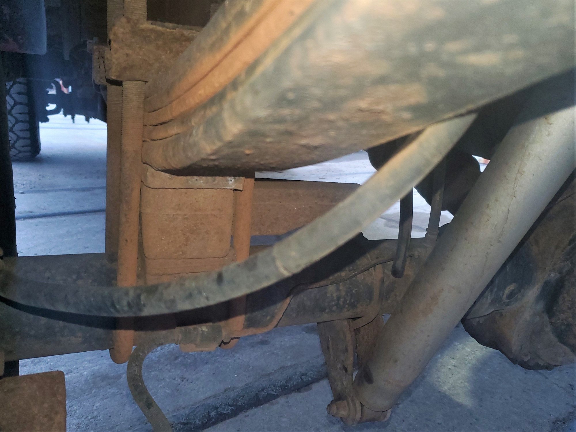

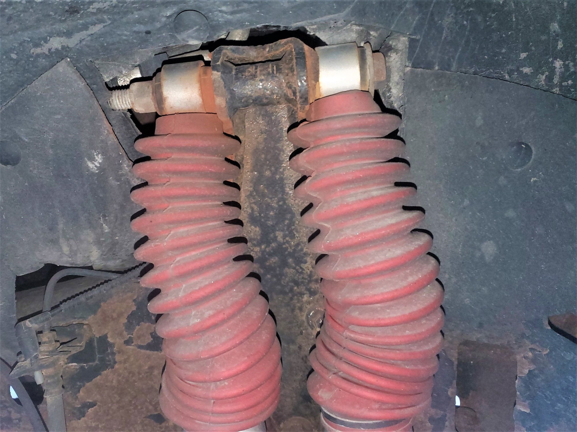

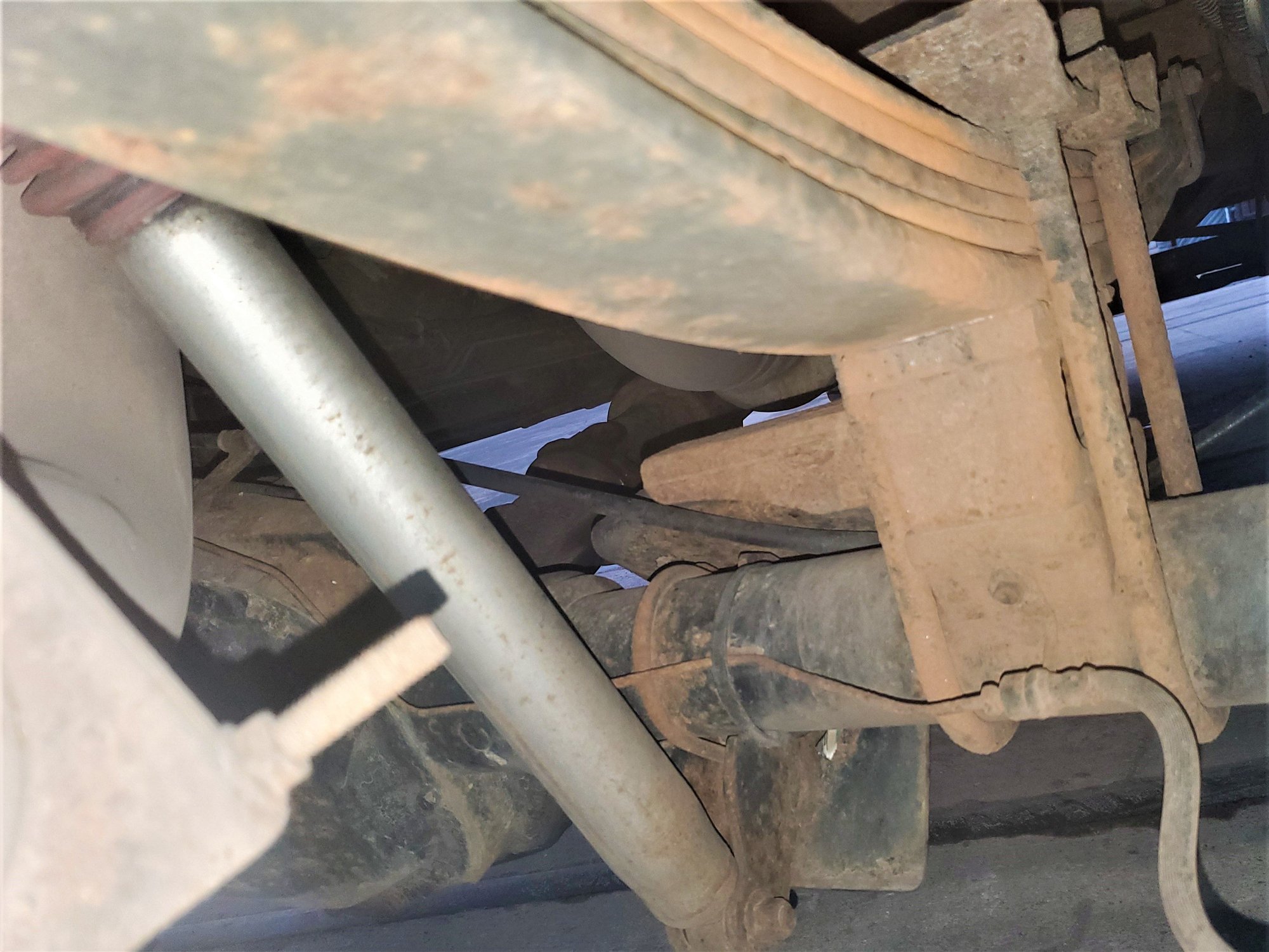

So I don't know if this is stock, but someone asked before to post up on the suspension set up.
With the lift, and living in Michigan, the "new" shocks I had put on last year look old all ready.
But it works well and functions as it should.
Driver's side rear
Driver's side upper mount.
driver's side lower mount
passenger side upper mount
passenger side lower mount
Passenger side lower mount rear

Shock mount plate is rotated past the locator nubs. Doesn't appear stock overall.
I'd highly recommend replacing all those brake lines. Ask Matt why!
Not sure who Matt is.
Maybe they will chime in with the why.
Recommendations on a kit to replace with?

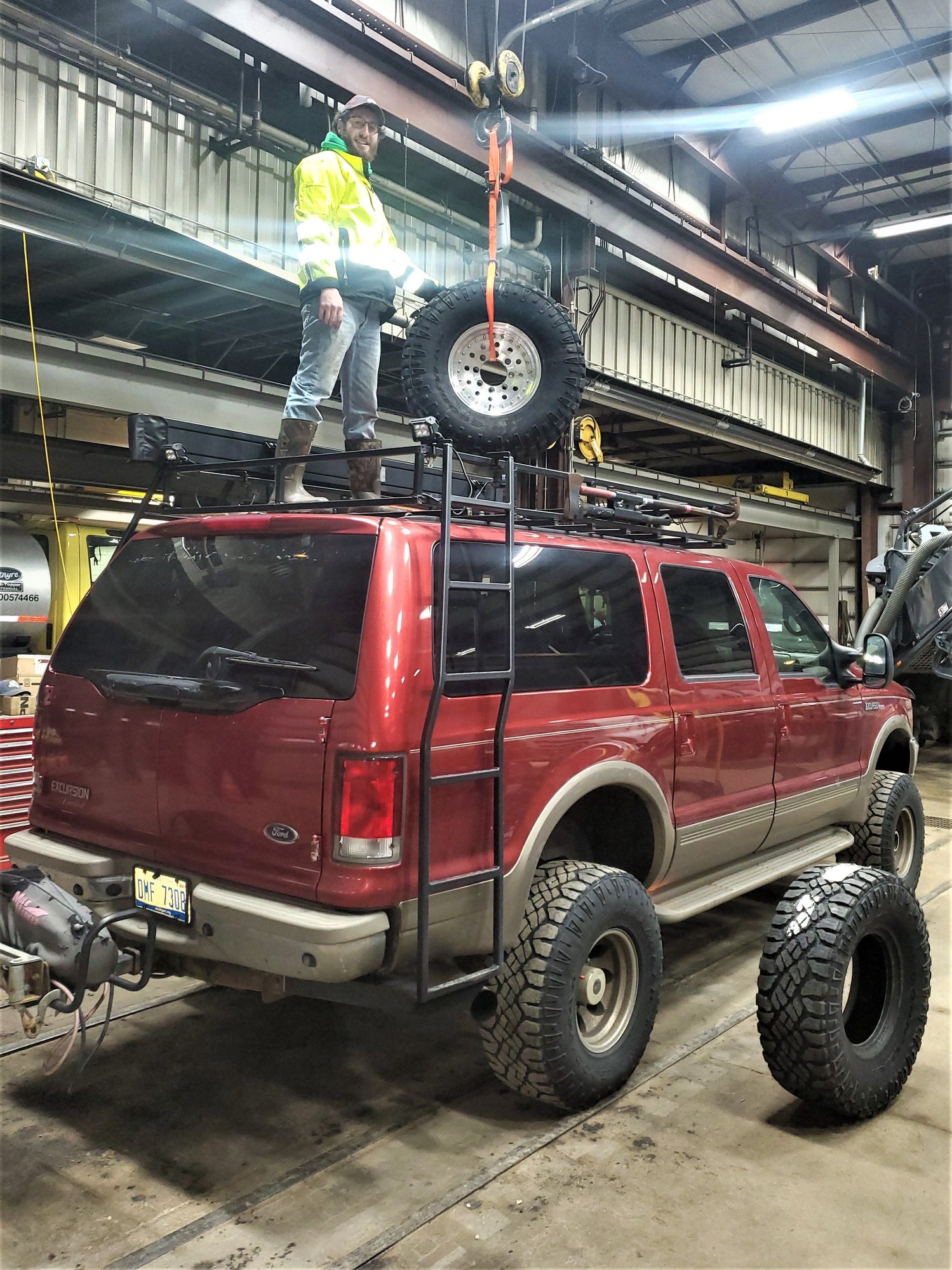

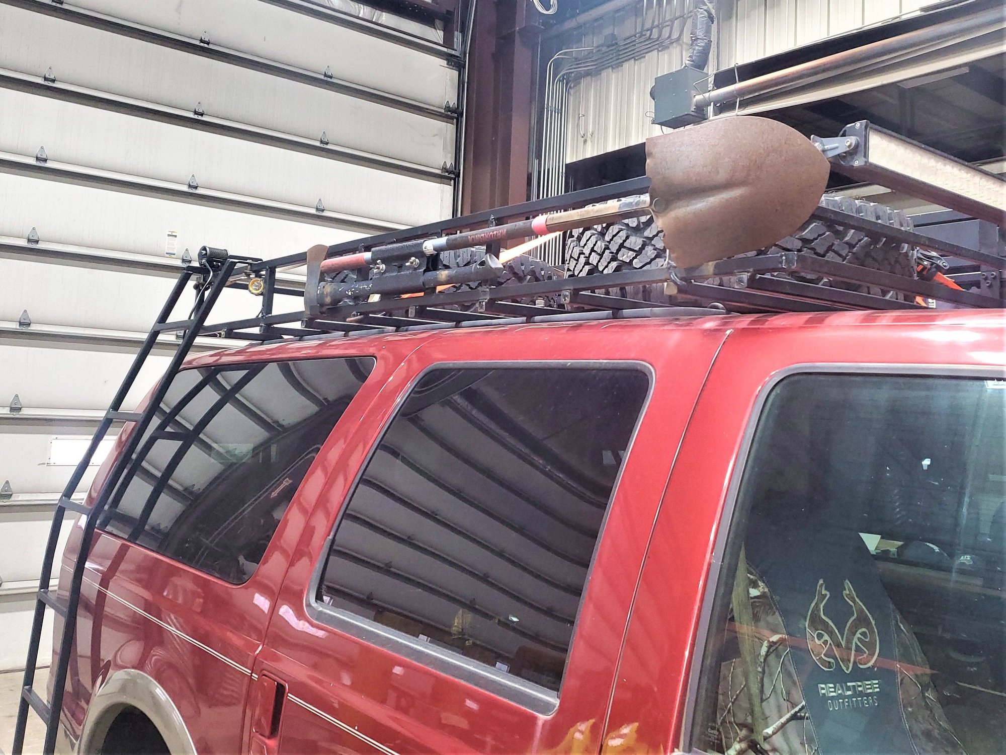

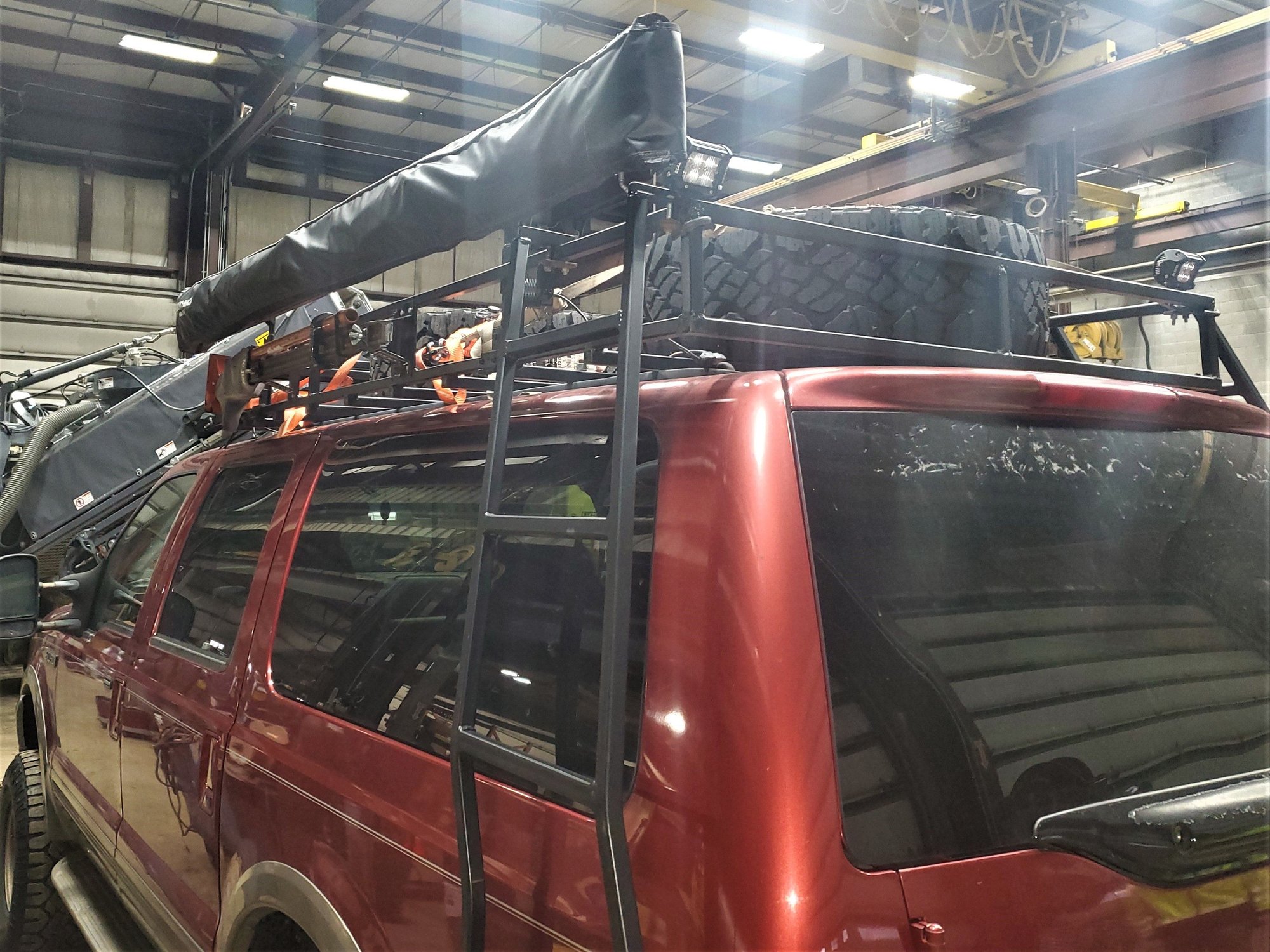

the roof rack
as stated before, I did not build the roof rack. Found it off of craigslist.
My buddy Gary, the Fab 4x4 man, fabbed up the the side ladders and mounting, and once all that was done, sent off to a local powder coating place to finish it up.
War dog's roof rack also came with a shovel and axe, although I wasn't exactly thrilled with how they were mounted, so I bought some proper mounting pieces for the axe and shovel.
Also, what lifted truck isn't complete without the prerequisite bro light bar. So yeah, got that too from a local shop.
I also needed more lights, so I bought some cubes for side lighting and back lighting.
Up north, when the lights are off in the world, this thing looks like an alien landing craft from the distance.
Speaking of being up north, when we go to sight in our pew pews, or just general shenanigans, I found it pertinent to protect our iron investments from the elements. So I also added a 270 degree batwing awning.
Old Dec 29, 2020 | 09:55 AM
  #30
1KILLERZ's Avatar
1KILLERZ
Joined: Aug 2014
Posts: 776
Likes: 30
From: Zeeland, MI
roof rack part two
So with the roof rack in place, and loaded for whatever the world holds in store for us, one thing is for certain; I no longer fit in many drive-thru's.
But that's ok, where we are going there will be no McDonald's.
But wherever we we are going, if we get a flat, we won't have the benefit of an overhead shop hoist either. I got some rigging in a Pelican case that allows a somewhat easier lowering of the spare if needed out in the wild.
