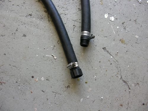

DTR's video does not show backflushing the heater core, it shows the OPPOSITE! I'm deconstructing my old facebook page so I don't a link to the old cooling system work I had a pictorial about.
However, at the Wye under the degas bottle you need to disconnect the hose from the heater core, which is the 3/4" line. You can use a garden hose repair connector to do this and it will be your garden hose inlet.
For heater core outlet, the connection is by the alternator, or if you like, up at the vacuum controlled valve that shuts off flow. Doesn't matter.
The garden hose connectors will be like this.
This will let you bring the garden hose in from under the reservoir, and using another garden hose connected at the passenger side, allow water to come out without splashing everywhere.
