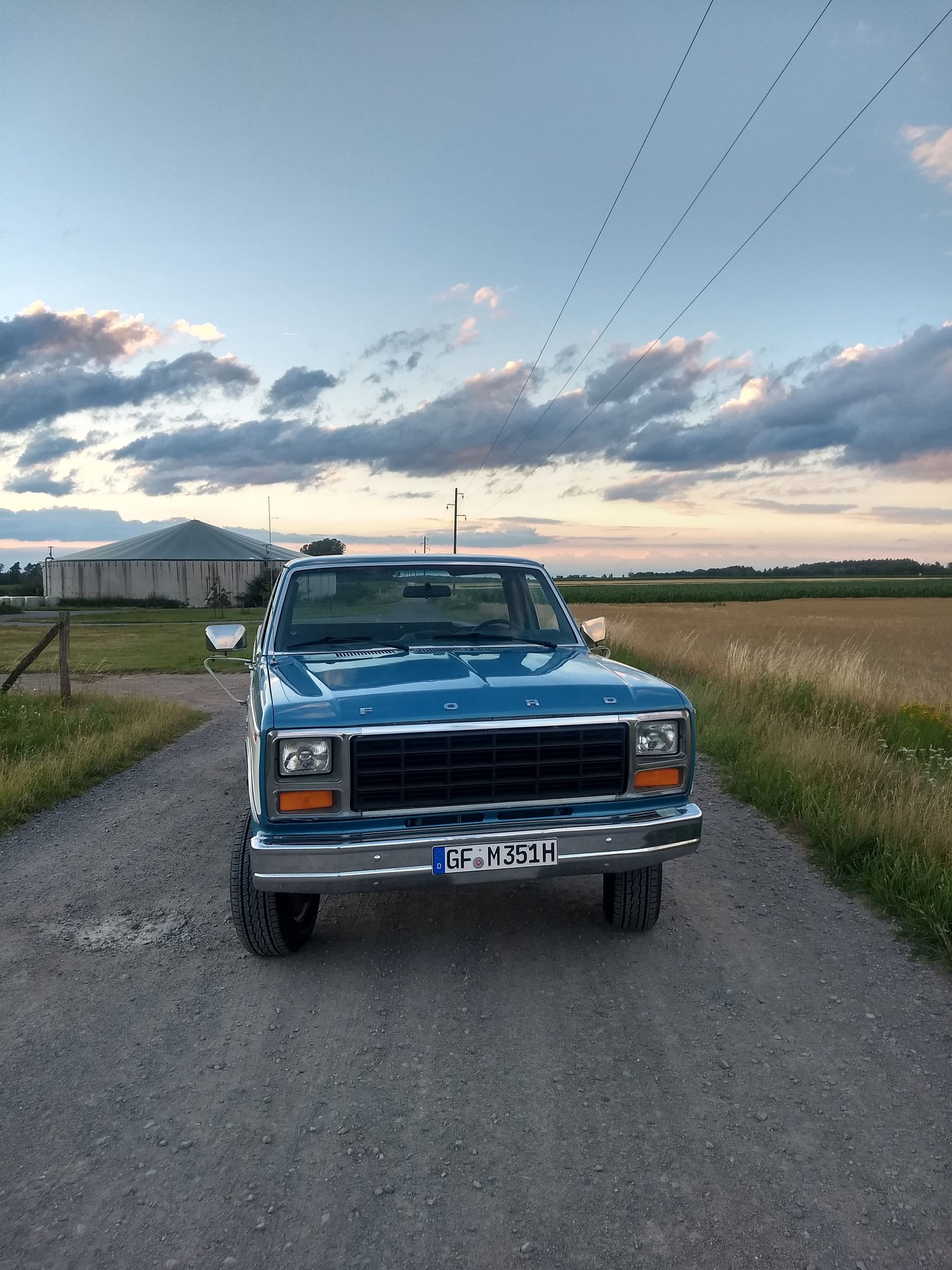

Well, Its been a while, but I finally got around to putting the Letters on. I ended up filling the studs off and filling the letters with epoxy. Then put them on with some of that 3M double sided emblem tape. I was on the fence on if I like it, but in the end I am pretty happy with how it turned out. I think it looks good on the truck
