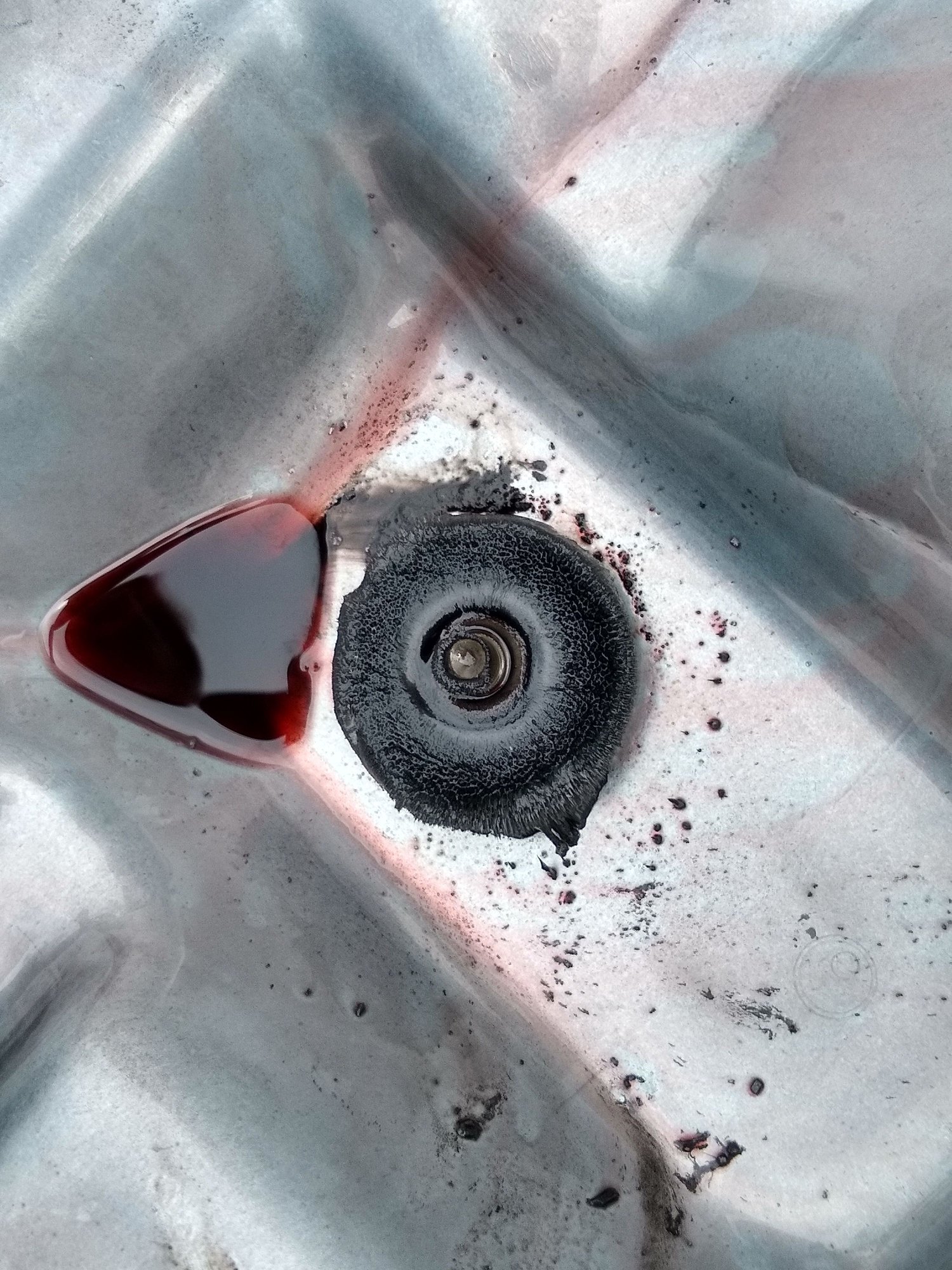

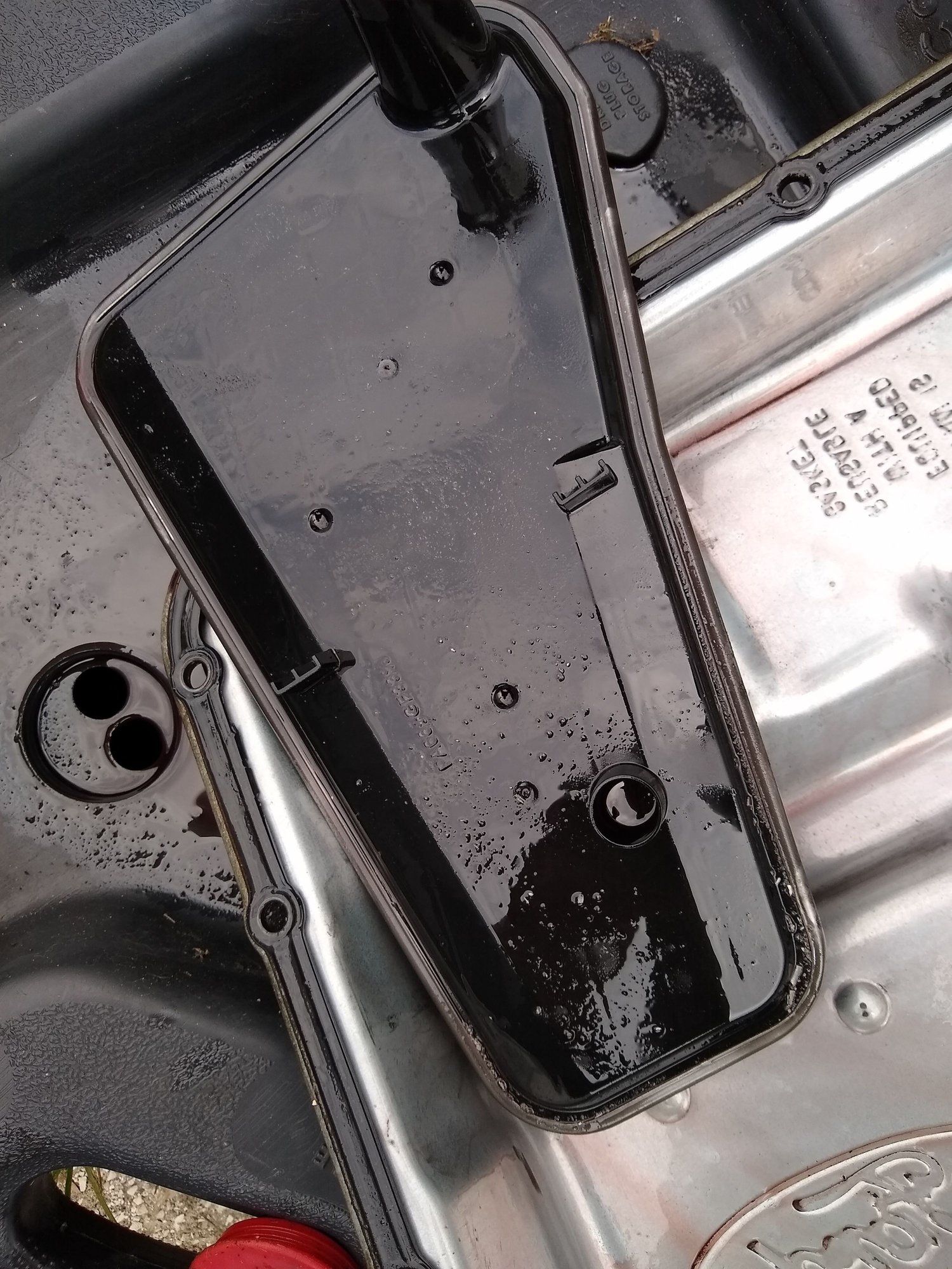

Well, just for to satisfy my curiosity I drained and dropped to pan. The magnet looked like a porcupine from hell and the top of the filter looked like Tinkerbell and all her fairy friends had a party leaving glittery pixie dust everywhere. There were a few pieces about a half inch long but most were small. I'm sure there is more in the filter, cooler, and every nook and crevice of the transmission. A lot of it was on top of the filter when I dropped it. Didn't even bother tightening the pan back up. Just stuck the filter back in and put the bolts in finger tight. New transmission time.
